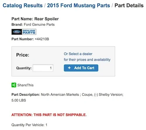

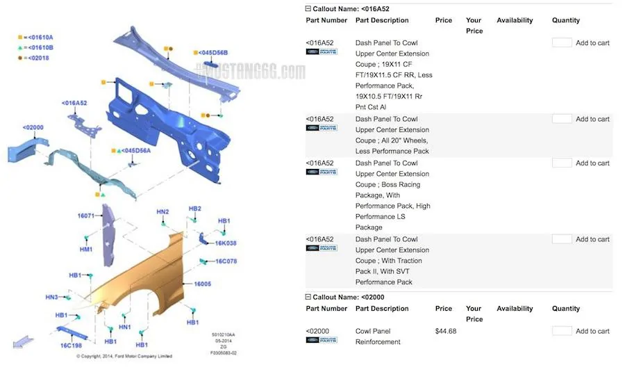

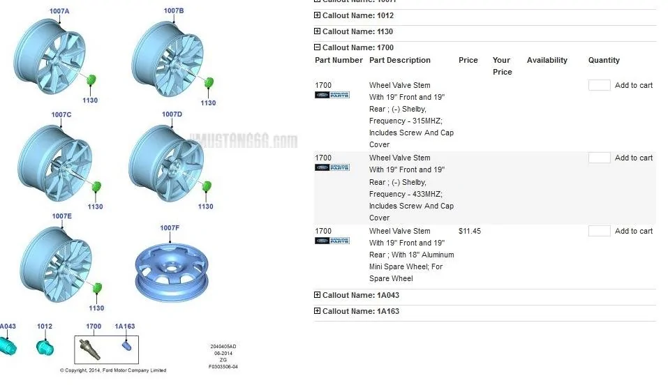

Some of these parts were mentioned in the Ford parts website. I know the wheels were there. If you want to compile the info that is where I'd look.
Edit: found the spoiler too I think?
Spoiler isn't for lightweighting but thought I'd include it anyway for anyone interested. Also not sure if the dash panel is any different.
