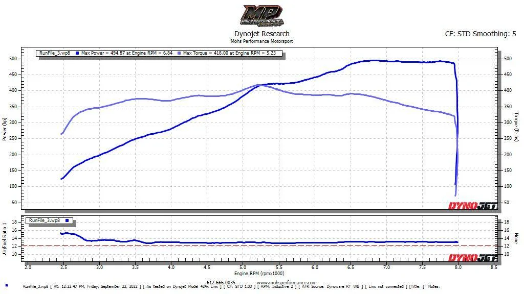

I have a 2020 GT A10, Cobra Jet Intake, Cams, E85, LTH, (497 WHP/418 TQ). I took it to the drag strip last week, fully expecting to be deep into the 11's. I was sadly disappointed. My best run was a 12.09 @ 121 mph with a 2.11 60' time. The car doesn't launch hard at all. I have a drag pack with Nitto NT555RII's but I didn't even need to do a burnout, no traction issues. I had the car in drag mode, advance track off, foot braking it to approx 2000 rpm. It's just a pig off the line but once I get into 3rd gear it goes like hell. What am I missing? Perhaps my torque comes in so high with the CJ that I can't get enough power to move the car off the line? Is it as simple as I need a converter to get to it? I'm running the car in drive. Do I need to put the shifter into sport mode, does that make a difference. I need some guidance. I am tuned by Lund. Thank you.
