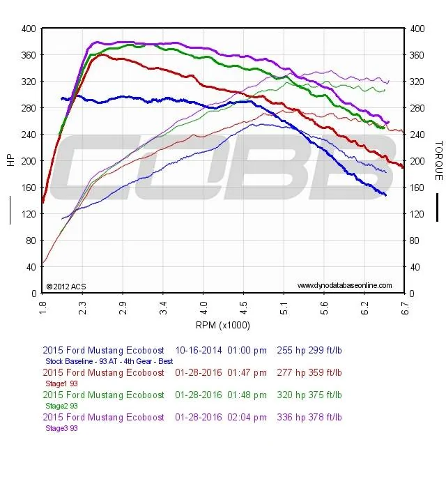

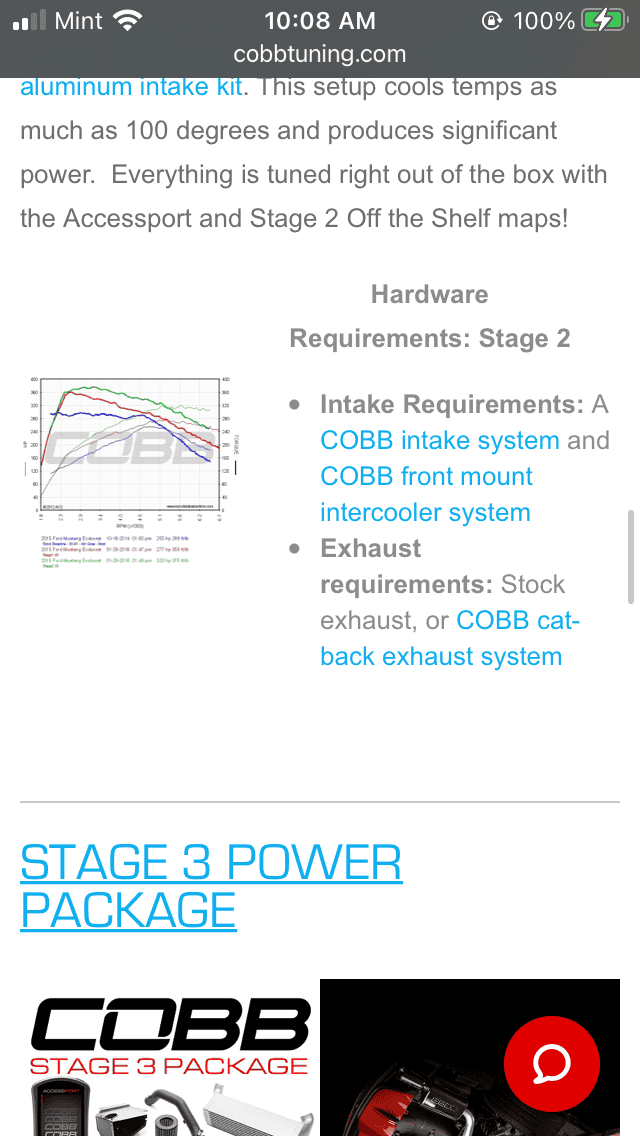

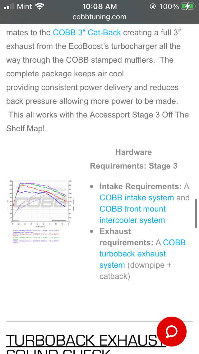

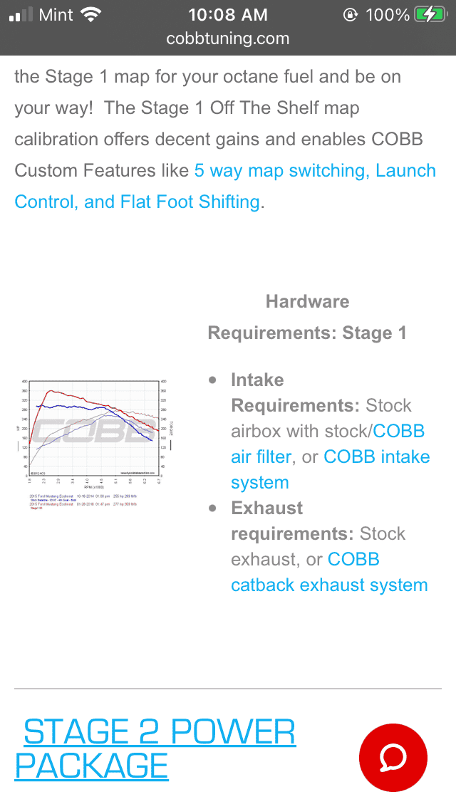

Run stage 2 op. Follow the pics I posted as guidance
