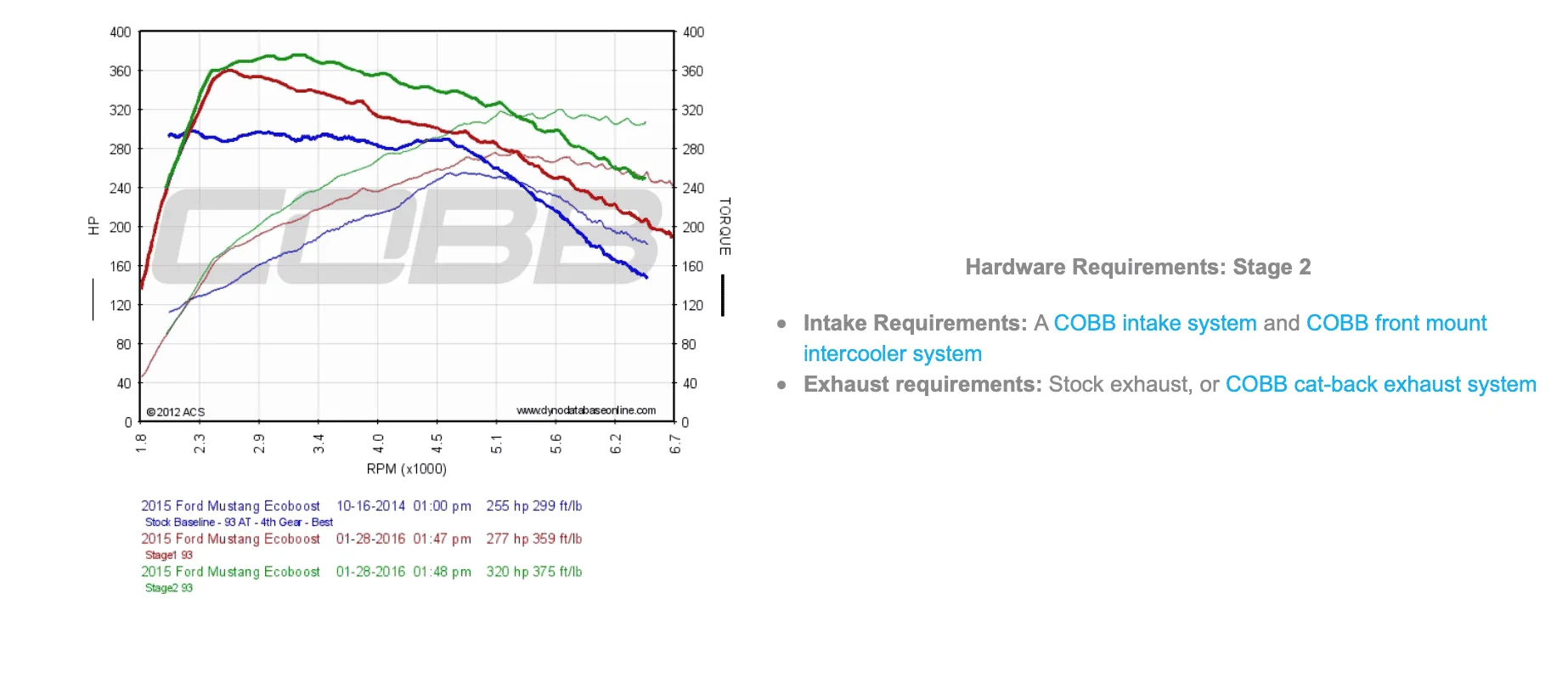

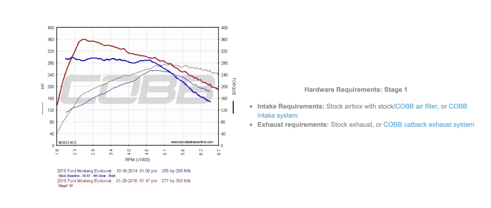

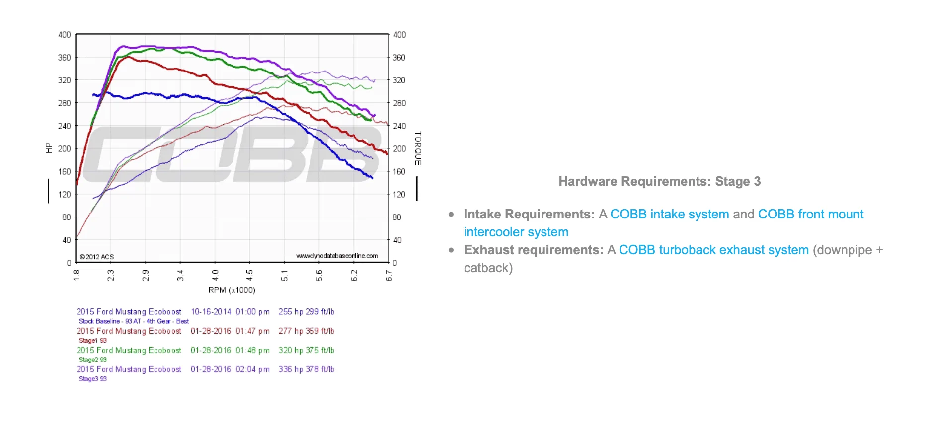

you are eligible for stage 1 and 2. - ignore the Cobb intake requirement. stock box + kn or afe filter is fine.
1 is high flow filter
2 is intercooler.
posting 1/2/3 for your understandings.

I read that Stage 1 packs a little more power down low than Stage 2, have you heard this? I was thinking of going to Stage 2 since I have the support mods, but I've been reading that Stage 1 is actually a little better for DD.

I mean it makes sense, little more torque, but what an freer flowing cat and exhaust allows for higher hp and power up high. as its spooling more.
but stage 2 and 3, should have the same torque down low, and more power to climb higher with freer exhaust and intercooler
but. 1 shouldn't be better than 2.. because 2 is same thing but allowing more power put down with intercooler and the tune for it.
thats what I feel. 1 should be weakest, 2 3 should be incrementally stronger. look at the dynes I posted above
