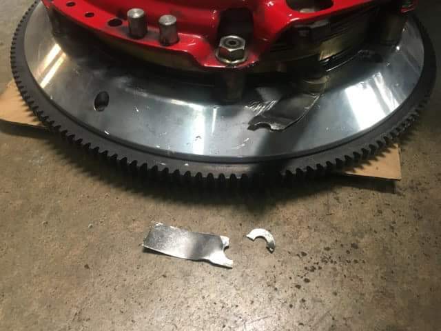

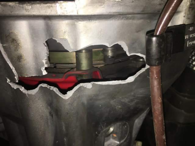

Several have had issues with the McLeod. See pics above... that's a McLeod and a 350 trans.
Ah ok, I misread your post and didn't realize your pics were specifically of the McLeod.
