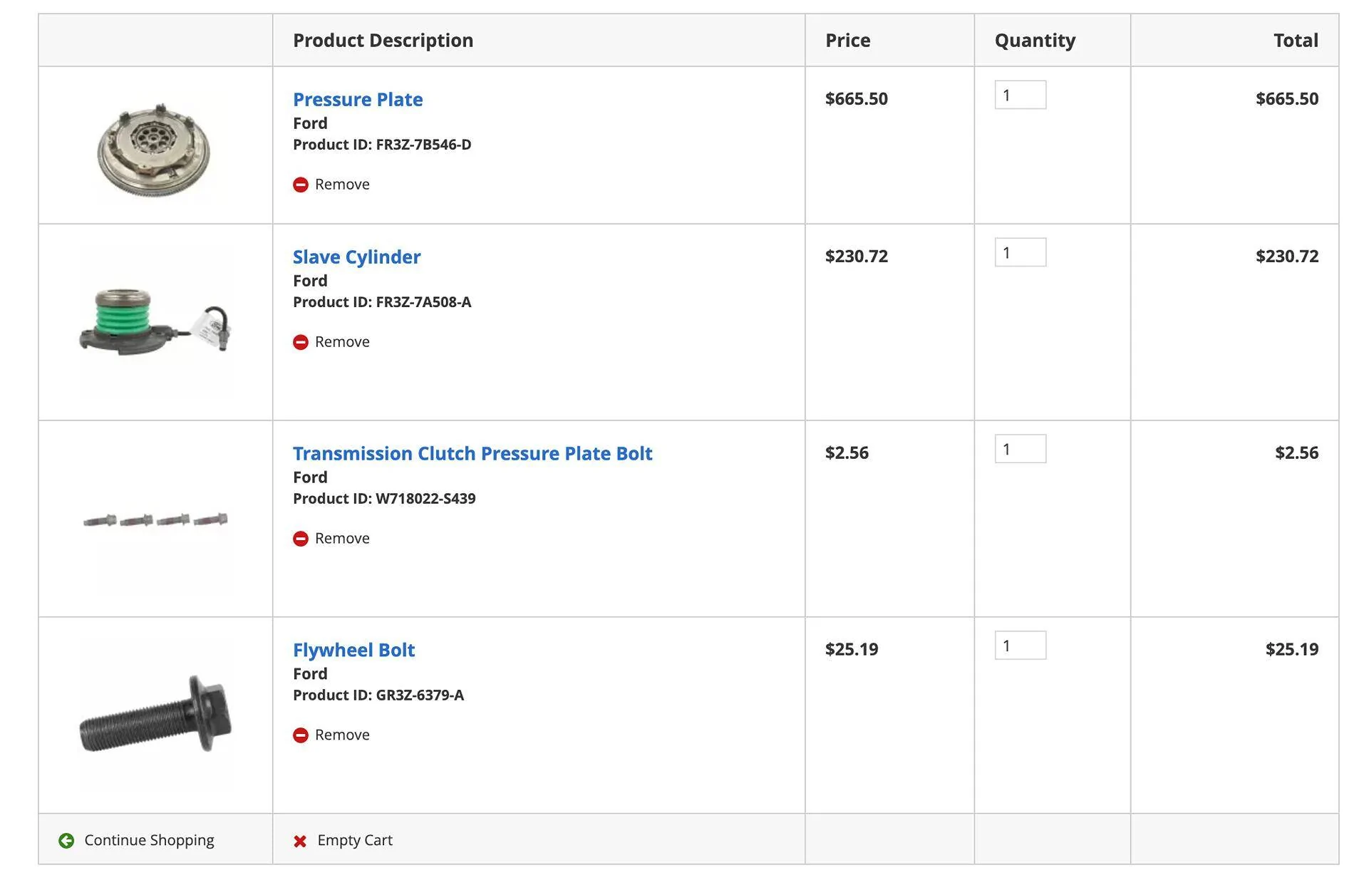

I have the oem flywheel, which will be resurfaced. Is there anything else I need for the kit? Thanks again, guys.

How many miles do you have. Not sure you need a new slave cylinder unless you’re just being preventative. You may try your local dealer to, some are pretty competive if you mention the online price when shipping is thrown in.
