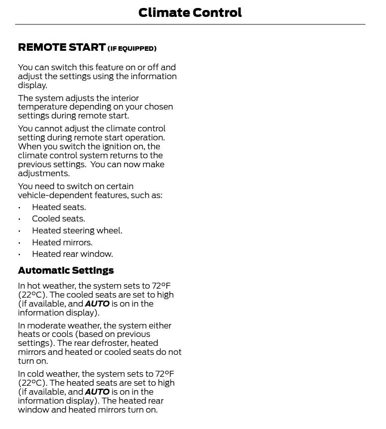

I notice that my seat remembers the last state it was in when I turn off the car. So when I start it again, the seat heat or cooling is on again as it was when the ignition was turned off. My truck and my wifes edge do not work this way. Is anyone aware of a setting or option to disable this?

It's in your gauge cluster settings.

It's not a setting you can adjust, but if two 2015+ Fords display different behavior it is likely that you can compare the as-built data from Forscan for both and one of the differences will be the one you are looking for. Will take a lot of comparing and the willingness to change each one individually until you stumble across it though.
