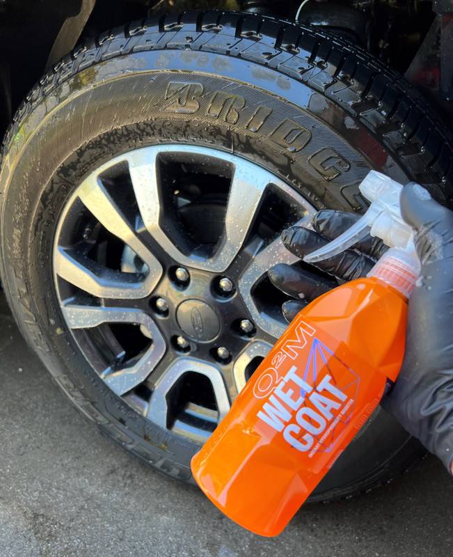

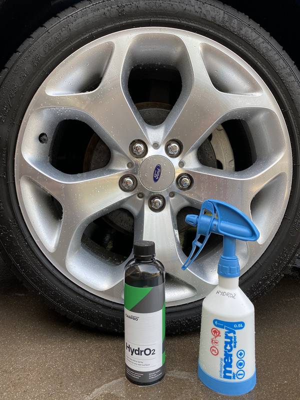

Simpler/more cost effective would be use the spray and rinse products like CarPro Hydr02 or Gyeon Wet Coat -

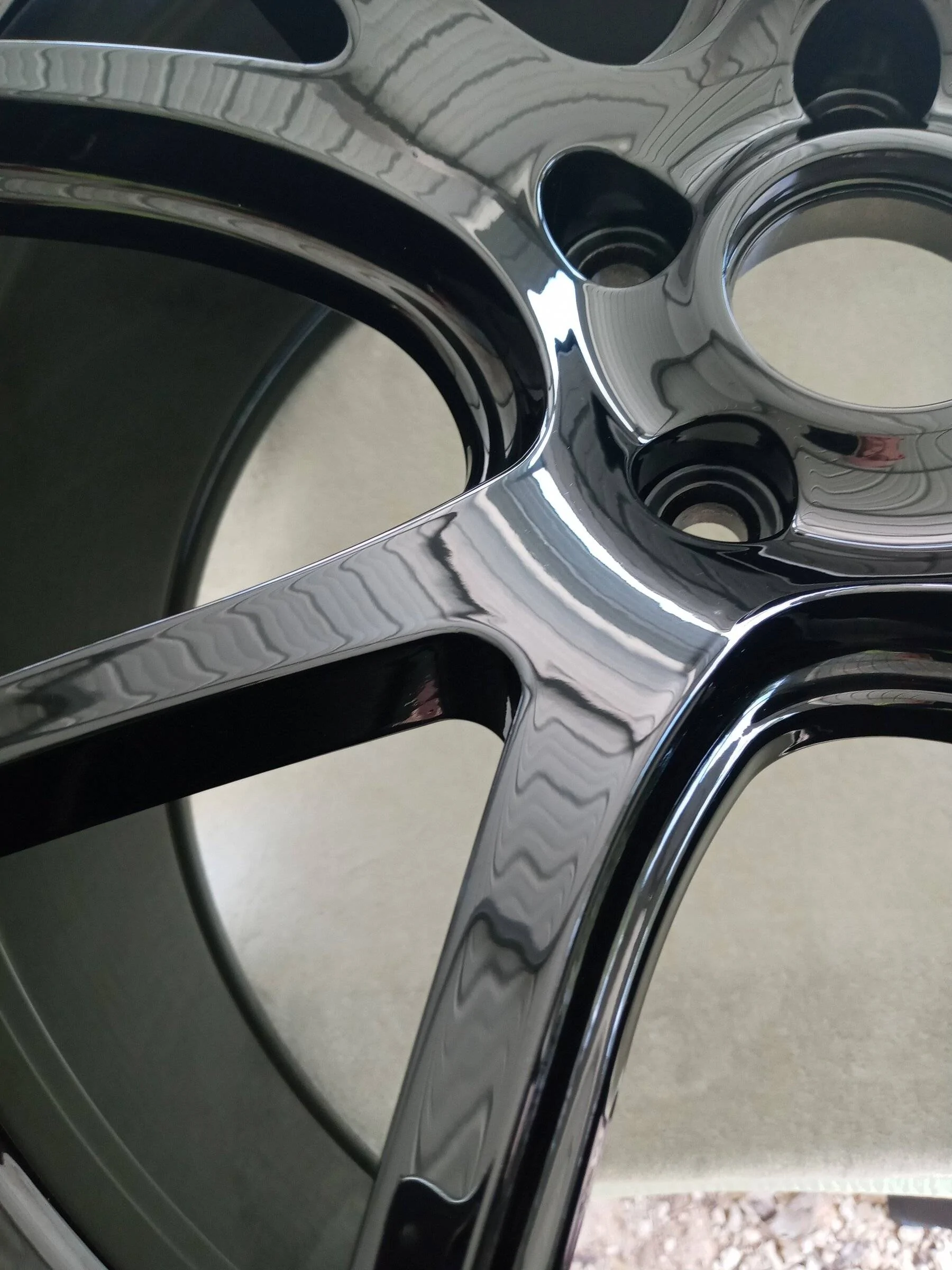

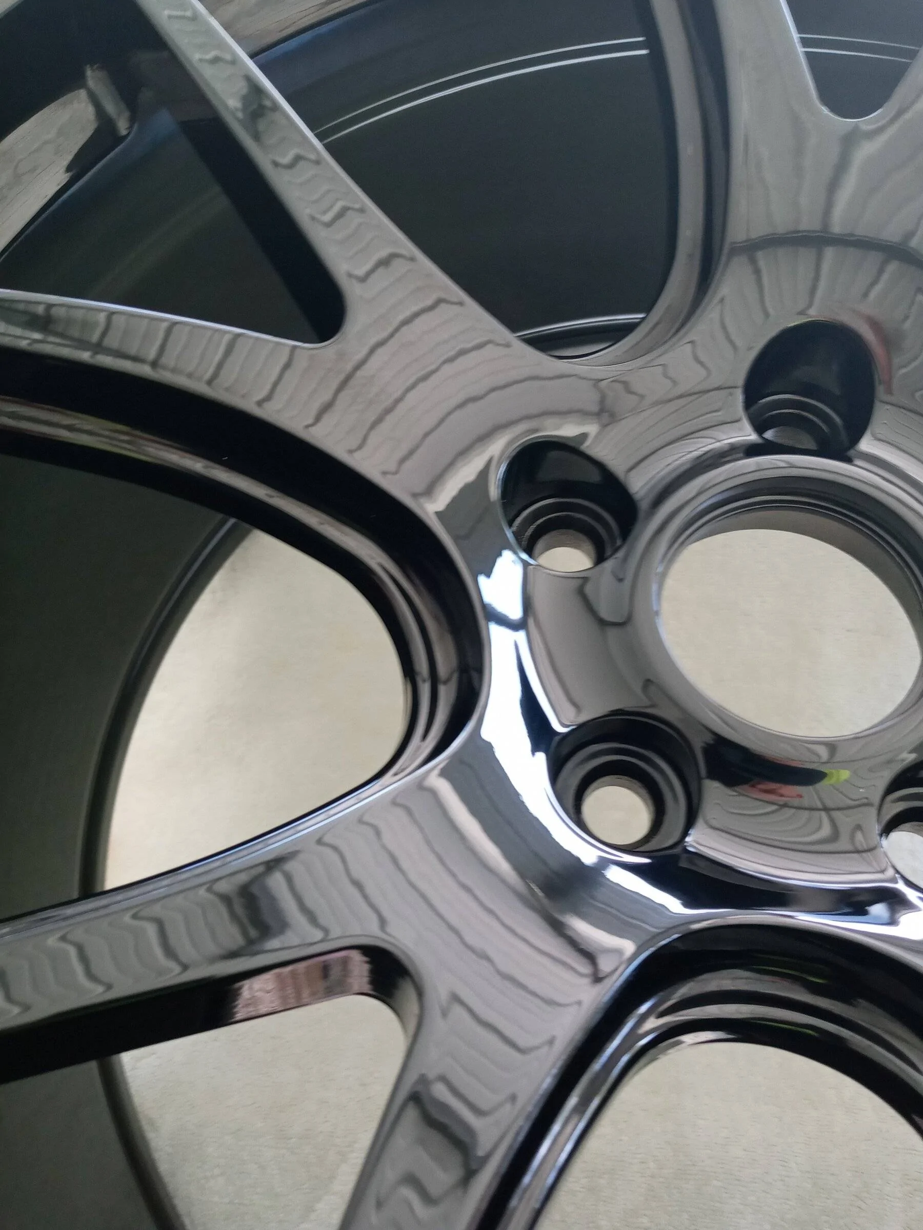

Finally got the rear wheels coated......
Two coats and it wasn't bad at all
I could have used better lighting and better eyes, but I think they turned out fine.
I'll get them mounted up next week then work on the fronts. I can only fit two wheels and tires in my trunk at a time!
Thanks for all the help guys. 👍
