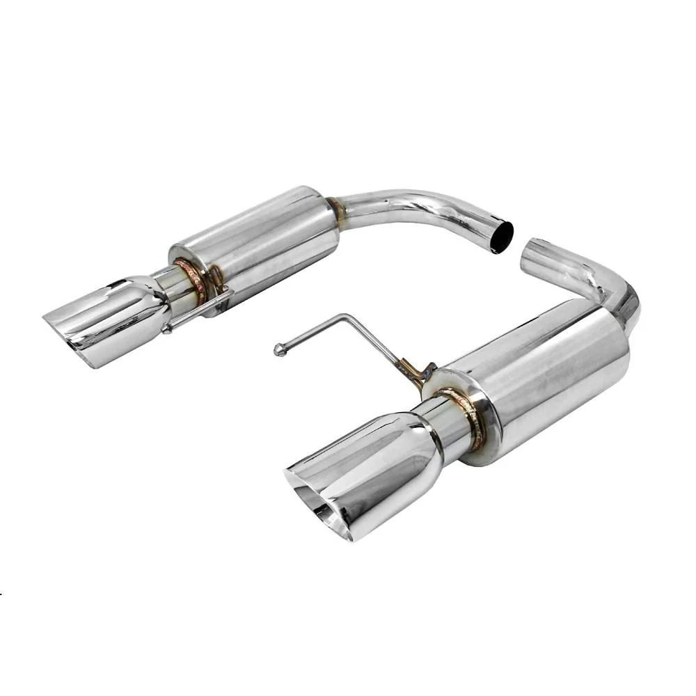

Spent about 2 hours trying to get the CJPP mufflers on with no success. I followed the video, cut the stock mufflers off just after the big bend. I couldn't wiggle the CJPP on very much, and we all know being on ramps doesn't offer much room. I noticed theres a small bend in the stock pipe that could be kinking it, so I cut some more off. This helped a bit but the angle is all off. Drivers side would barely budge at all. I made sure to file down any edges, and file away corrosion on the stock pipe. I dunno, bad luck I guess. I'll probably take it to a muffler shop and risk having someone other than me work on my car. I've never had issues putting on an axleback before.

I had to wrestle mine also. I sprayed some silicon lube on both pieces and it helped just enough...good luck man.

Took me about 30 minutes to install mine. A BFH, a block of wood and a few whacks and the pipes went right on.

Got them on! I used Emery cloth to clean up more of the corrosion and silicone spray lubricant. I also had to cut about an extra inch off the drivers side, there's a little bend that was messing with me. I still had to muscle them on quite a bit. I haven't driven it yet, but it sounds great!
