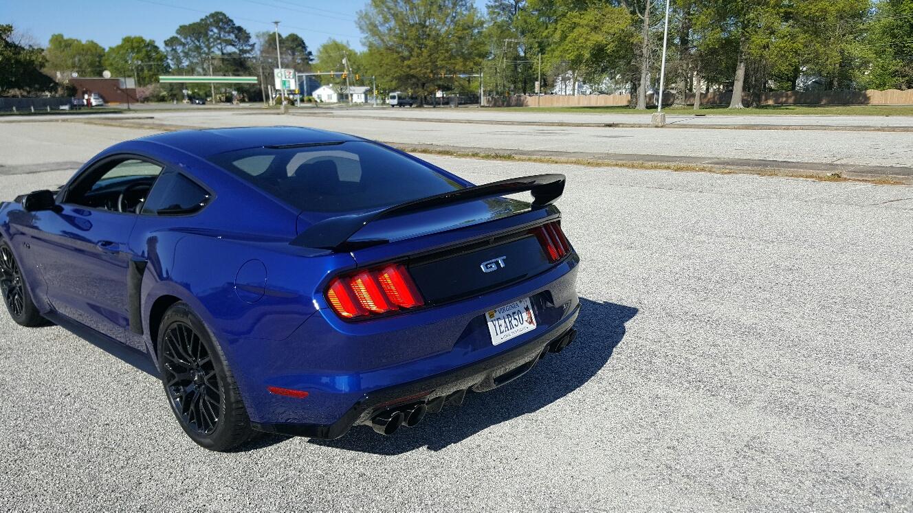

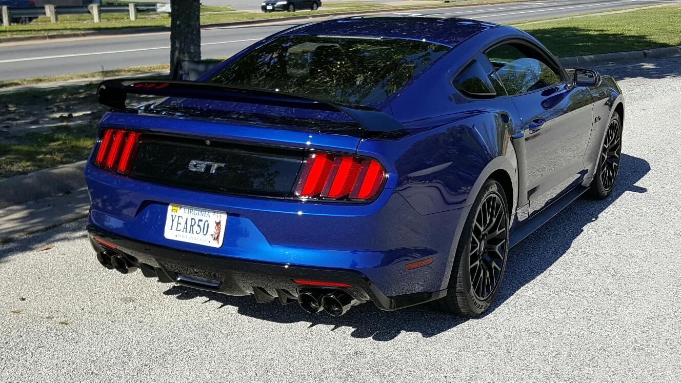

I endorse Moddiction
I love th corsa touring axle backs. Sound perfect to me. Zero drone, very quiet when you want them to be but can definitely hear the car scream when on it.
Let me know if you'd like any pricing. We have some huge sales going on for mustang exhausts!
Moddiction is the absolute best to deal with for Corsas..they hooked me up with best price with axle back sport quad tips ..ordered Monday arrived Tuesday and yes they do take PayPal.
