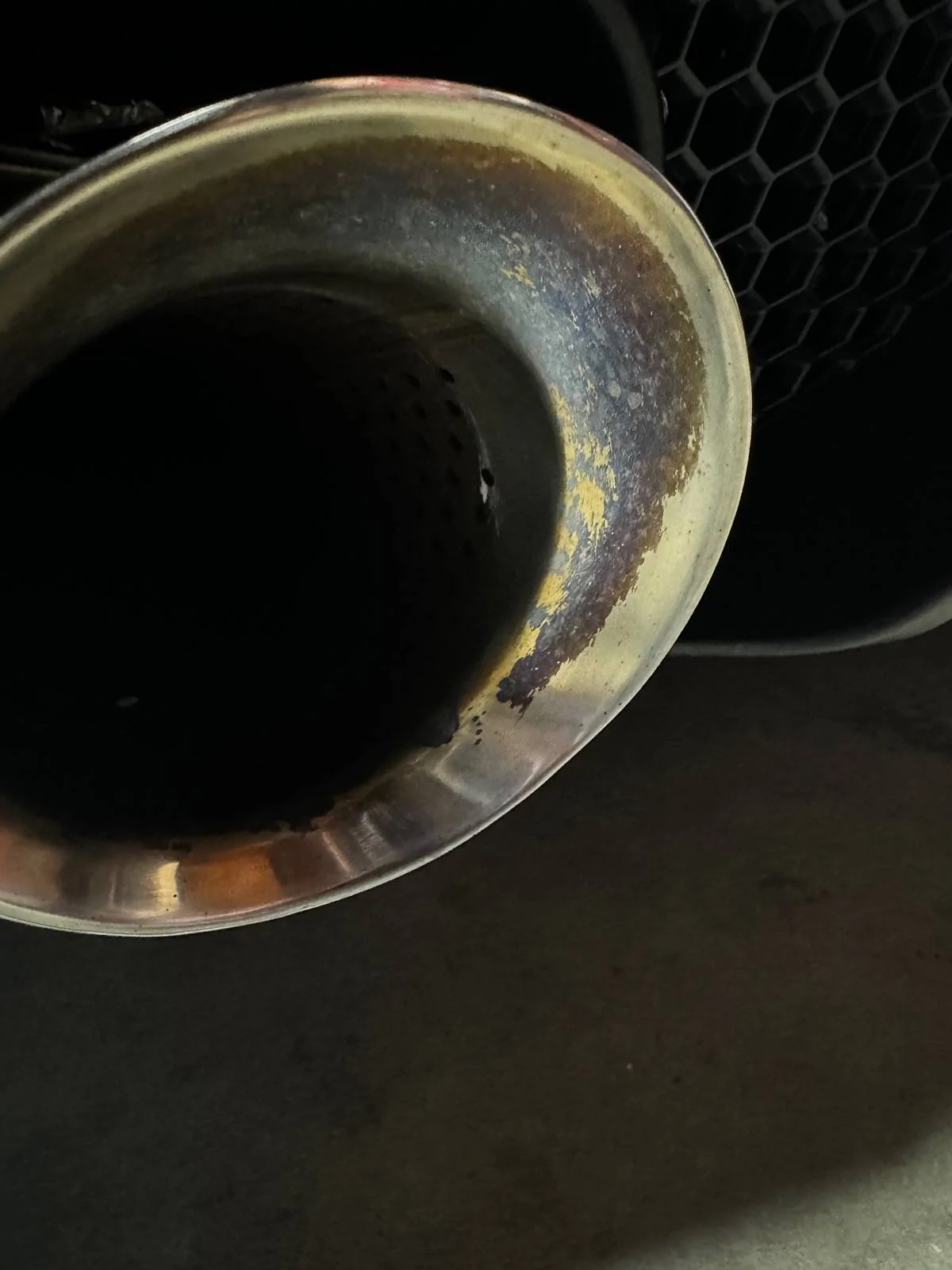

2nd the vote for Flitz or Never Dull, both are excellent products. If it’s really stubborn surface rust a very wet sos pad will get rig of it too. If not, warranty claim.

If the ID turns out to be 400 series stainless which I think it is then a 3M 2S Fine unitized wheel on a straight shaft die grinder will cut the iron formation off the surface and leave a nice satin finish if done correctly.
Unfortunately iron formation will reappear over time being 400 series stainless contains a high amount of iron unlike 300 series stainless.

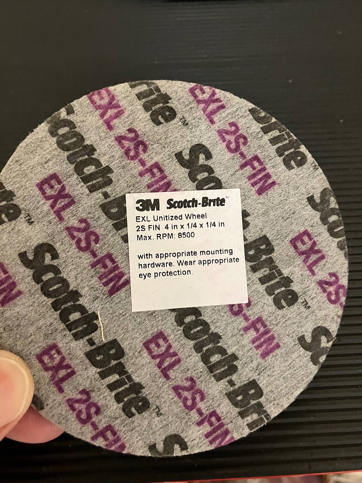

These are available in many sizes. The 2S Fine with a nice rounded edge will leave a very nice finish. I cleaned out my iron oxidized Gibson tips and painted the ID with VHT high temp ceramic exhaust paint.

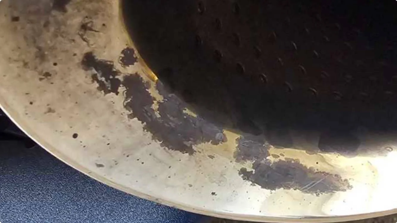

The more I look over the rust formation characteristic's in this exploded view I don’t see any sharp flaking or peeling of chrome. I see iron deposit growth on the upper surface. Typical rust forms underneath a chrome plated surface.
Hopefully you guys can rule out chrome, that’ll make cleaning up the inside tips a breeze and then apply a protective coating. Paint, ceramic sealer etc.

The iron oxide stops right at the tip for a good distance. That would indicate the weld zone where 400 and 300 meet and a 300 series filler wire was used.
One thing to try is to take a magnet and test to see if the outer diameter tip is less magnetic than the inside diameter.
300 will be mildly magnetic whereas 400 will be highly magnetic.

Scotch-Brite 2S Fine to cut the iron oxide off surface if it’s truly 400 series followed by a mother’s foam polishing ball with Flitz.
Flitz is king when buffing properly prepped stainless.
