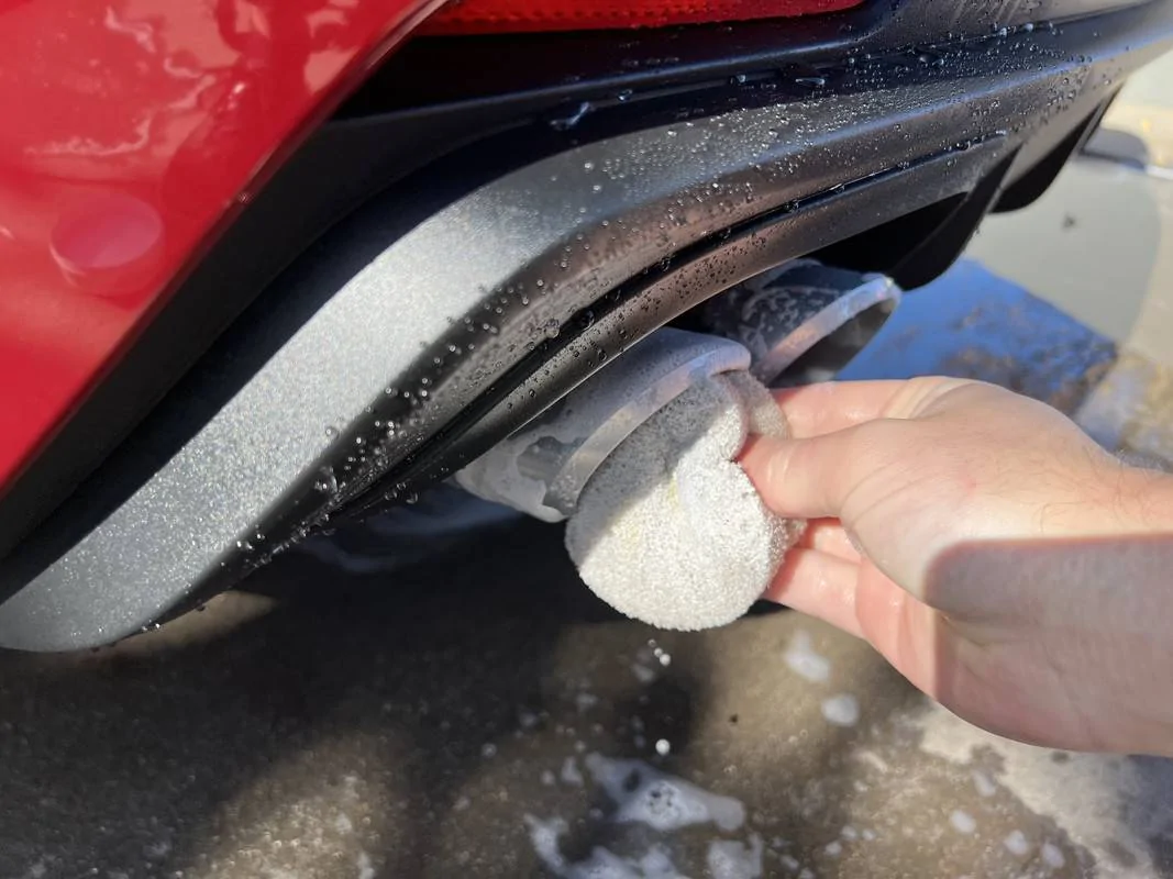

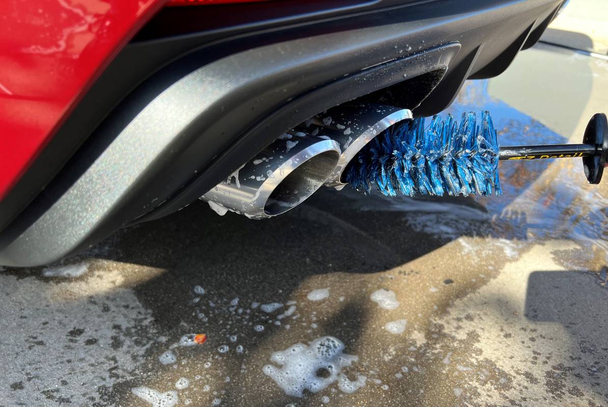

For exhaust tips, I wash them during the wheel cleaning step. I'll rinse them down, spray a little wheel cleaner on them (usually Brake Buster), then agitate with a brush or microfiber wheel mitt. Do that on a regular basis and you really won't need to use heavy metal polishes or steel wool.

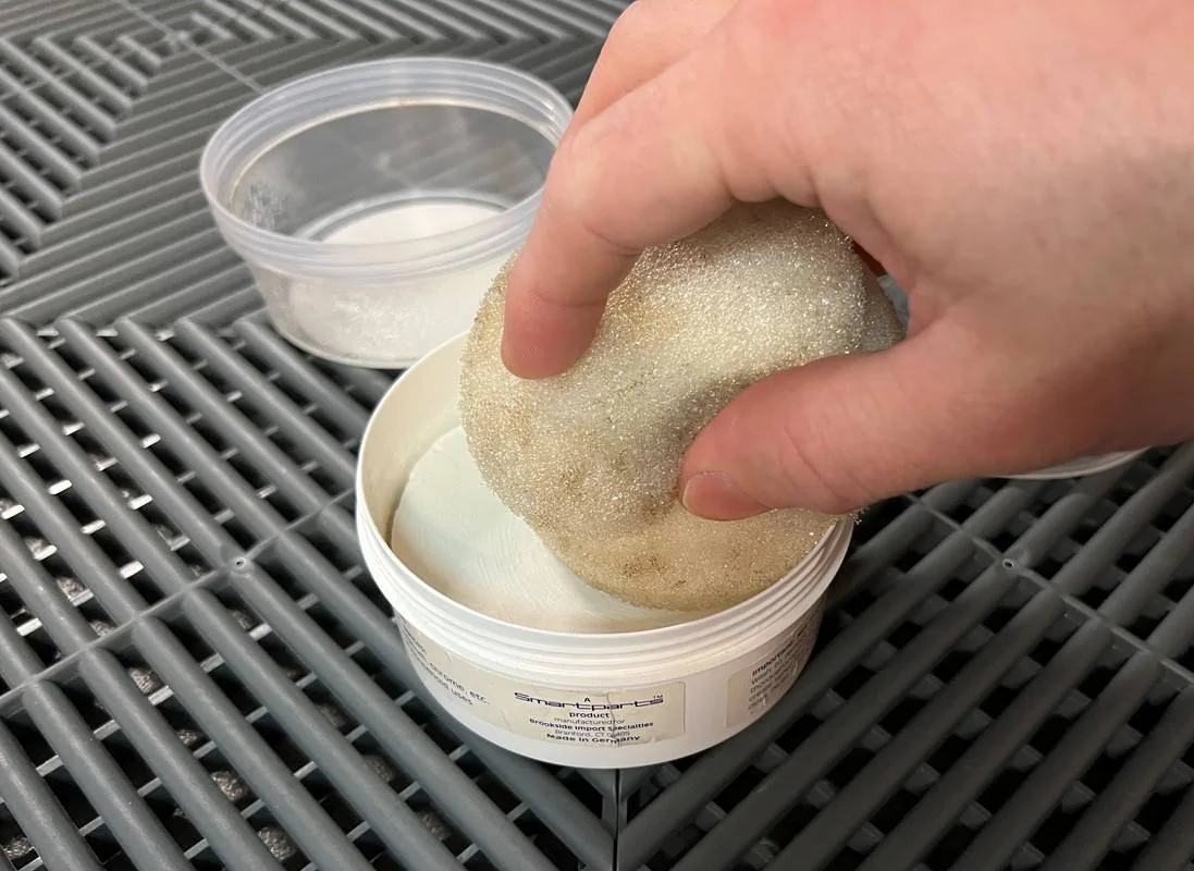

Periodically, say every 6 months, I'll swap to P21S Polishing Soap. This is a nice middle ground between a soap and a heavy metal polish, lightly polishing and deep cleaning in one step.

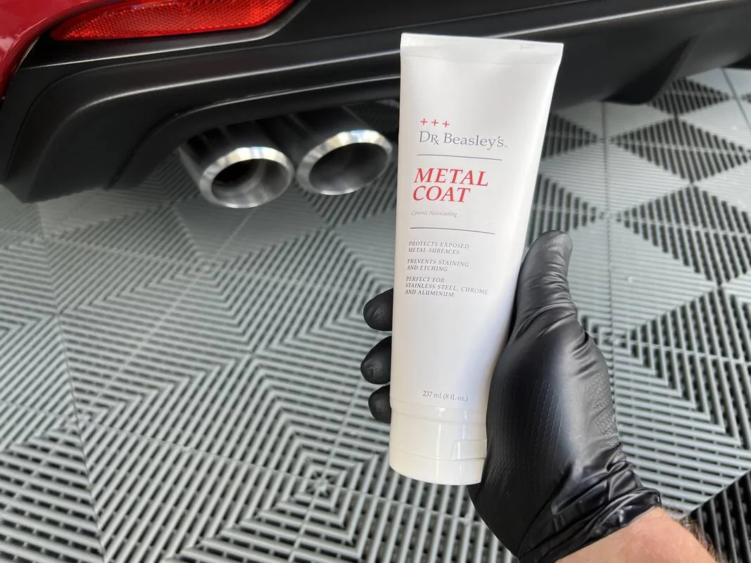

After that, I will recoat the tips with Dr. Beasley's Metal Coat, which is a high temperature metal sealant which helps prevent carbon staining.
