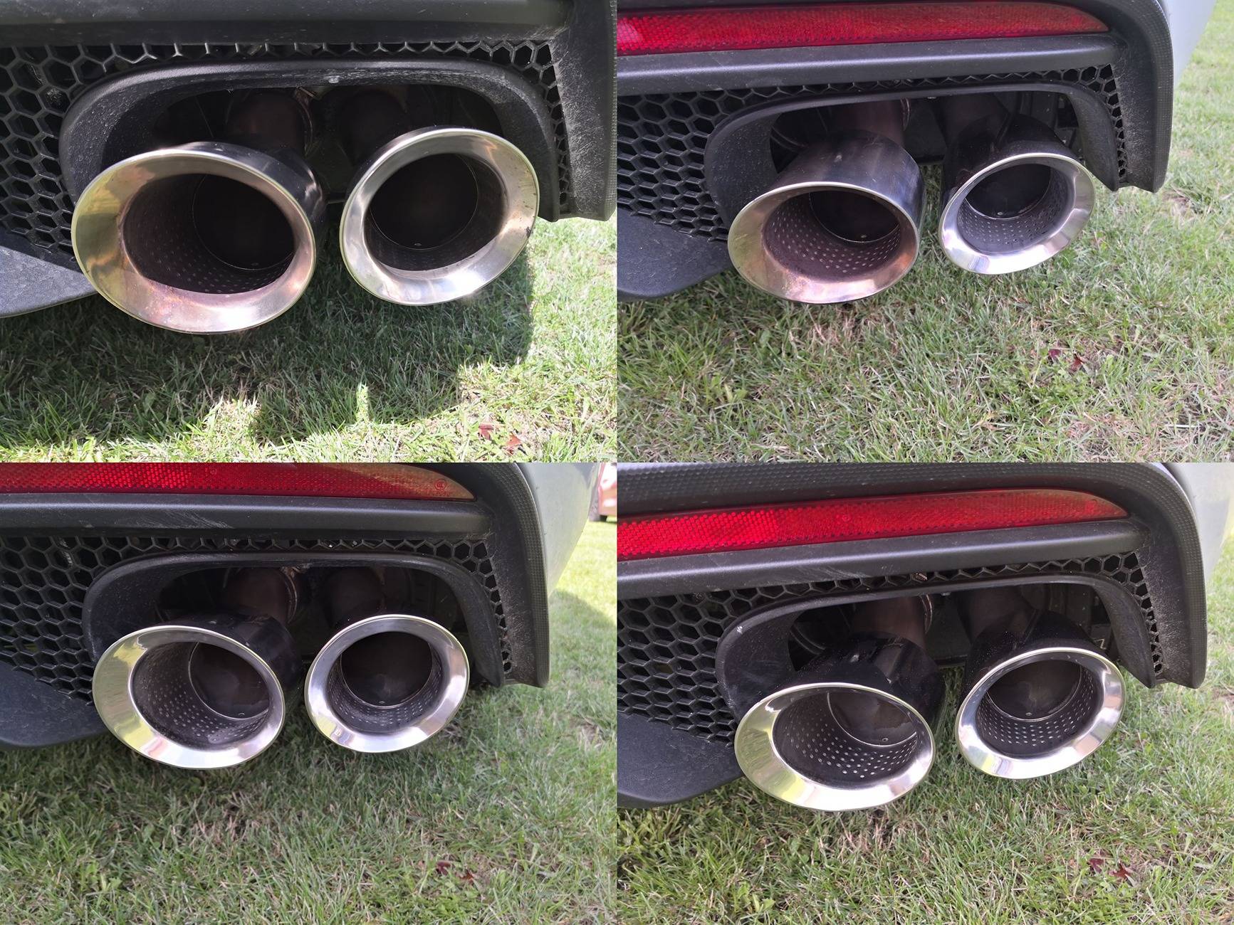

I did an exercise today, first time cleaning the exhaust tips after 11k km (6800 mi). Inspired by this thread I used Autosol Anti-Blue and Autosol Metal polish.
The picture is worth thousand words:
left-top - original state, top-right right tip cleaned with Anti-Blue, bottom-left - both tips cleaned with Anti-Blue, bottom-right both tips polished with Metal Polish.
Few observations:
  • Inner tips were distinctively more colored than the the outer ones (first pic)
  • Anti-Blue worked surprising well (cannot say that Metal Polish would not) and removed the coloring easily. I believe it also "softened" the carbonized residue, which I could then simply remove with fiber cloth and little nail pressure.
  • There was no visual difference between Anti-Blue and Metal Polish finish. I applied Metal Polish anyway as it still took away some material (the fiber gets black quite fast) and as a protection.
  • It looks like the guys in Dearborn polished only the outer surface and the tip bezel but not the internals (which are perforated). I guess I know why, but I wonder if taking dremel to it may change that. It might not be visible on the photos much but the inner surface looks like a raw metal.

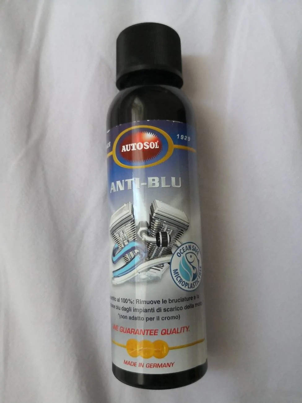

I am not sure about Euro only thing. You may try to search you tube for "Autosol Anti-Blue" there are several vids which show it in action. (It is a creamy whitish liquid, which is applied by a sponge or cloth and then cleaned up.)
I am not sure why mine has Italian text on it (I bought it locally.)
