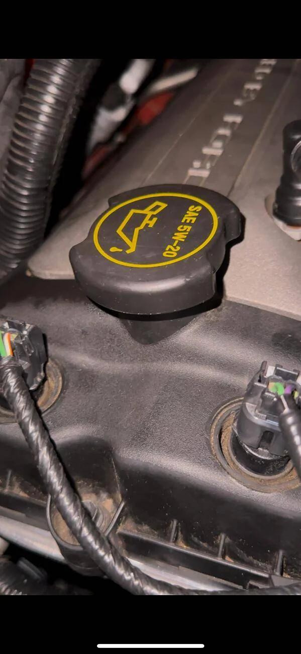

Yes, that’s when I notice it on mine. When I unplug the passenger side VVT sensor the noise goes away. When I plug it back up the chirp returns. I performed this test while the e fine was running.
I’ll be replacing that sensor when I pull the timing cover and start working on the car in the near future.

Oh shoot maybe I’ll give that a try I didn’t even think to unplug it did you unplug the exhaust one on the intake? (Left or right)
I’m pretty sure you don’t need to pull the timing cover to replace them just the valve cover

Right side toward the front end of the valve cover.
I was saving this until such a time when I had to pull the timing cover for OPGs and a valve spring upgrade.
The car has performed great even with the chirping, but it is a bit annoying to hear it. no codes or anything.

Thats when i noticed mine after doing my opg what one did you unplug in the picture left or right…also does it sound like this?
