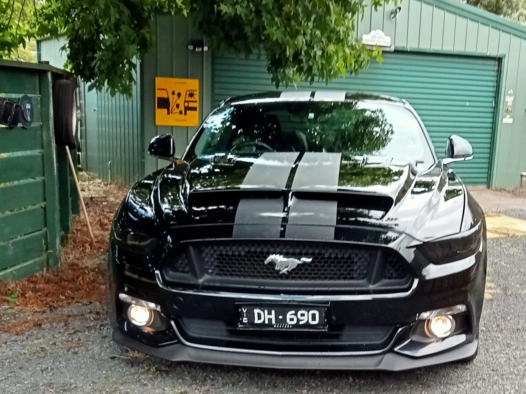

Jon 5.0 2015GT
i have Cervini on my car they said when i bought it to replace the brand new ford perf struts with their own due to weight and they work perfectly only had ford set on for a month

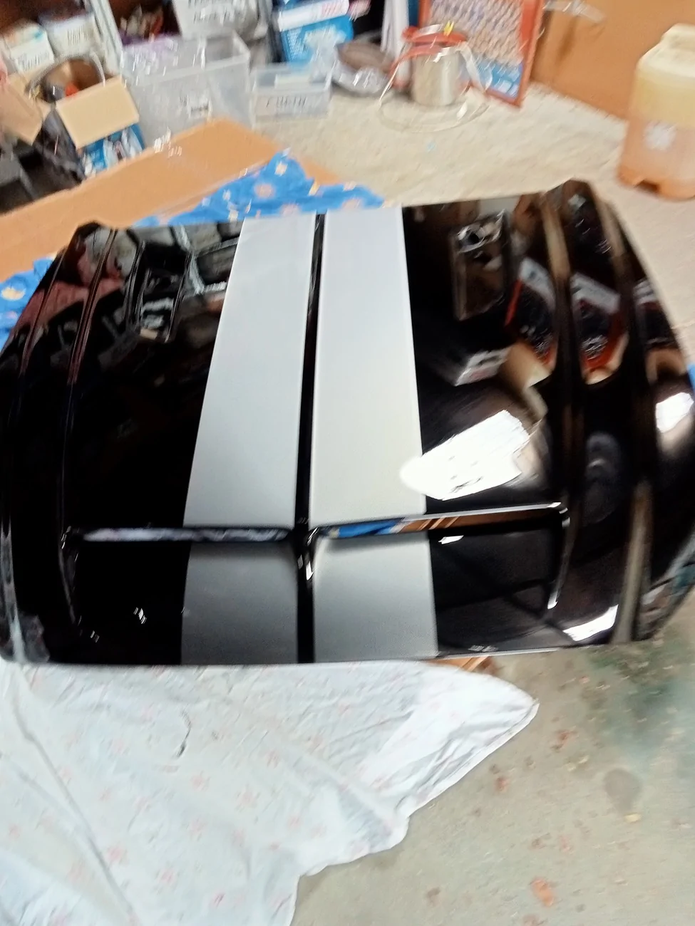

One thing that my striping guy noticed was that the hood vent is a little bit off. I didn’t notice until he went to lay the “over the top stripes” on. I ordered the factory stripes for the hood (And Ford is proud of them.). Due to the contour they don’t fit without some convincing. They are not lazer straight but as it sits I like it.
