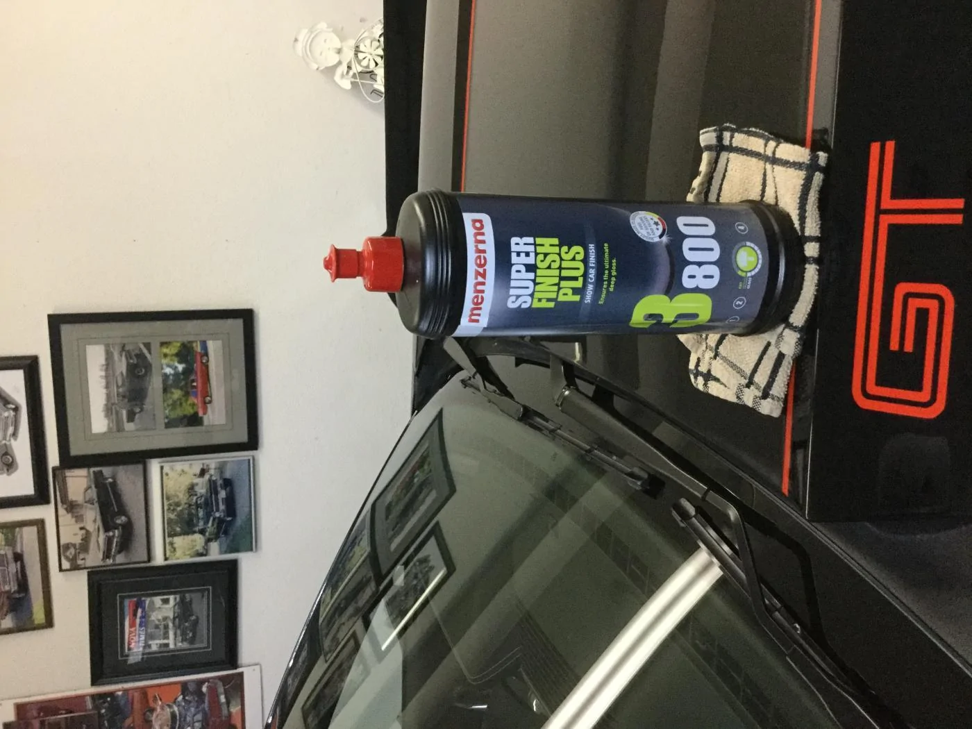

Gratuitous indeed Patrick !! Wow that does make the car..."Pop" :cheers: All in fun Bro! I'm excited about getting mine finished. Wet sanded ( yes wet sanded and zero burn thru!! ) and about 95% buffed out last year...just waiting for better and warmer weather to final buff.. NOTE...I DID NOT WET SAND THE BOTTOM ABOUT 1/3 of CAR... just polished it.
Patrick.. I picked up some Menzurna 3800 you mentioned last year. I have used it in some places already and love the finish you get. Light foggy areas disappear. Now, having said that....I have 3 or 4 very minor rock chips that I can see....at the 3ft away mark...but it is a driver. My main goal is the car will pop going down the street and ultimately be much easier to keep clean. I have a heated garage so it is not in the elements.

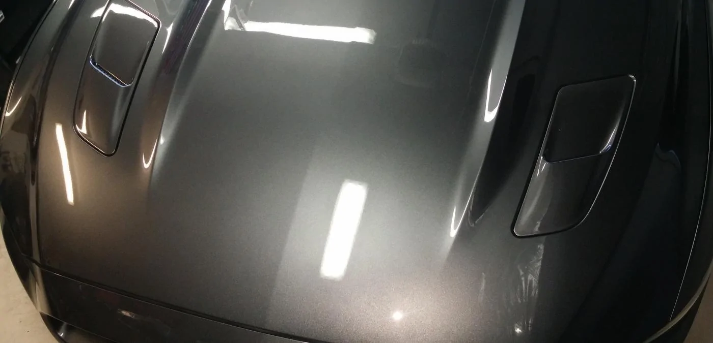

coatings are soo damn easy to put on .. i did c quartz uk to mine the same week i brought her home . told the dealer not to touch the car before i picked it up .. so i needed no paint correction at all . every few months i hit it with a reload spray..best thing i ever did was put the coating on.
hood right after the coating and a side shot
