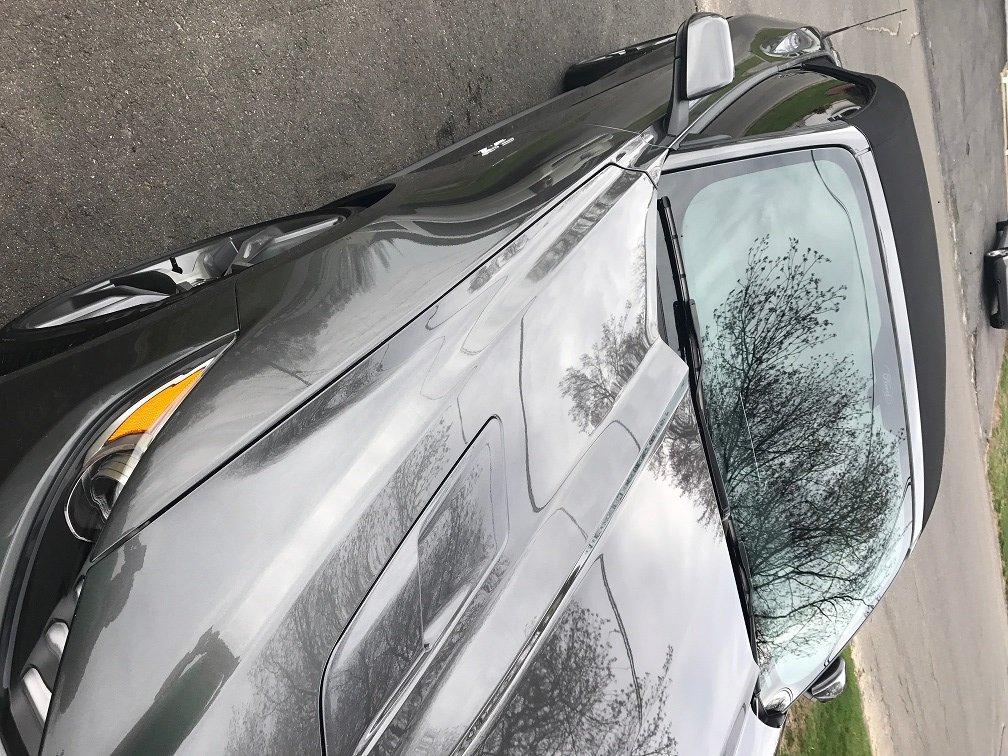

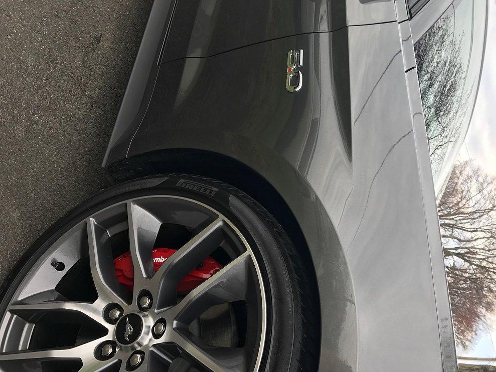

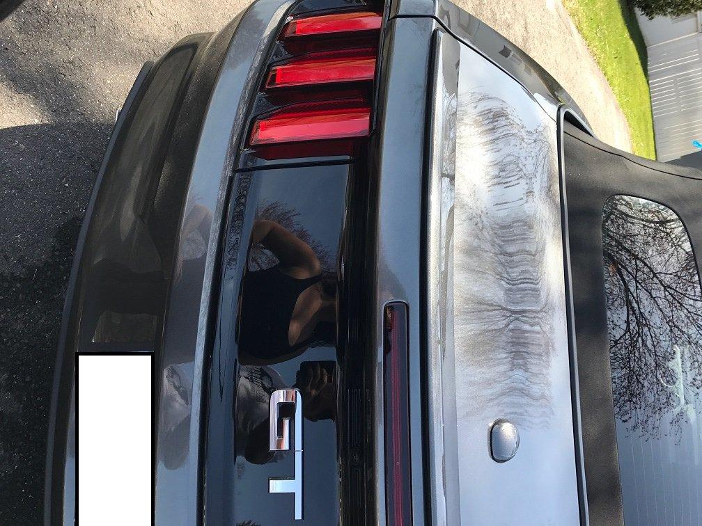

Yeah I guess not posting pics was pretty weak! Here ya go, just don't tell my wife that I showed her cleavage to the whole world!
