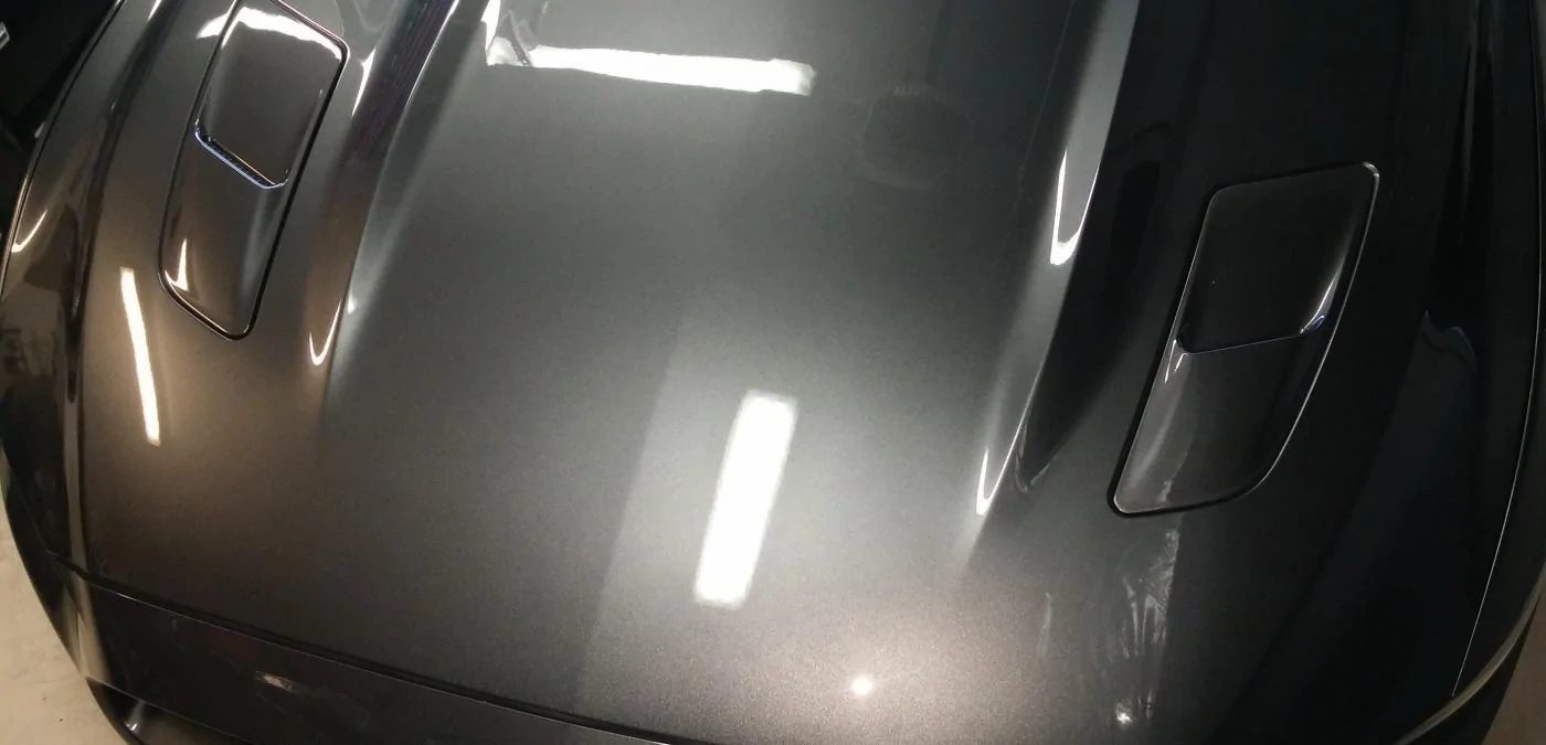

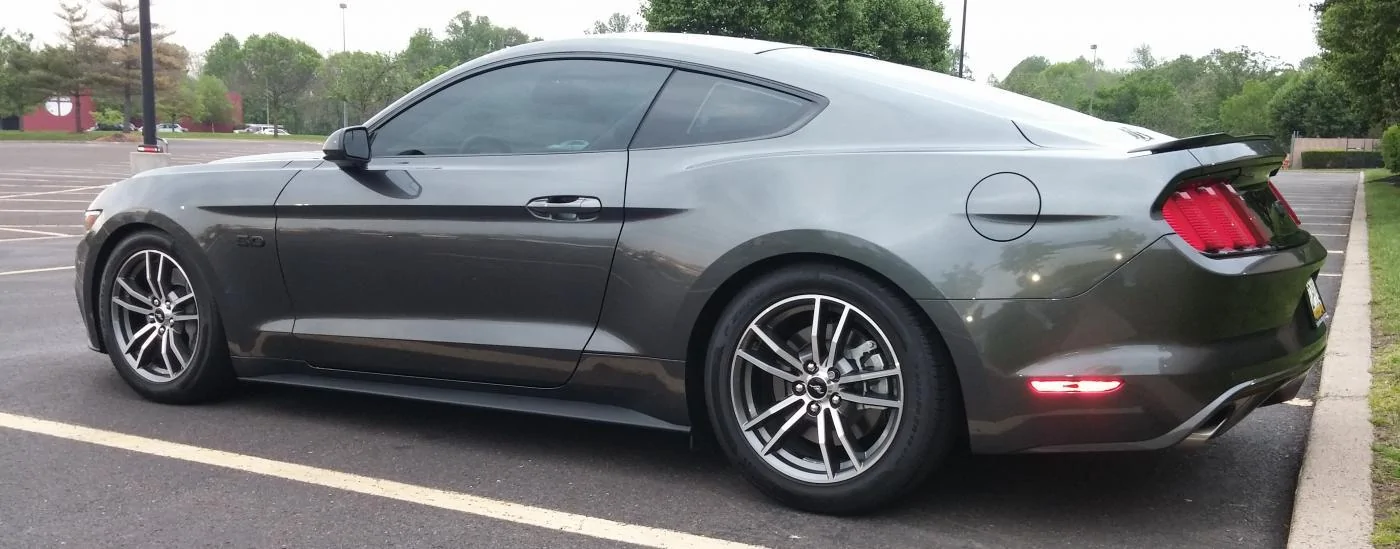

i did mine myself soon as i got it home from the dealer .. clayed it washed it with dawn and bought the c quartz uk kit. came with eraser spray. reload and c quartz,and applicators .. it very easy to do if your not paint correcting.. mine was flawless so... asked the dealer to not even wash it..
have a few picks of after i did the car
im going to erase it and do another coat before winter
