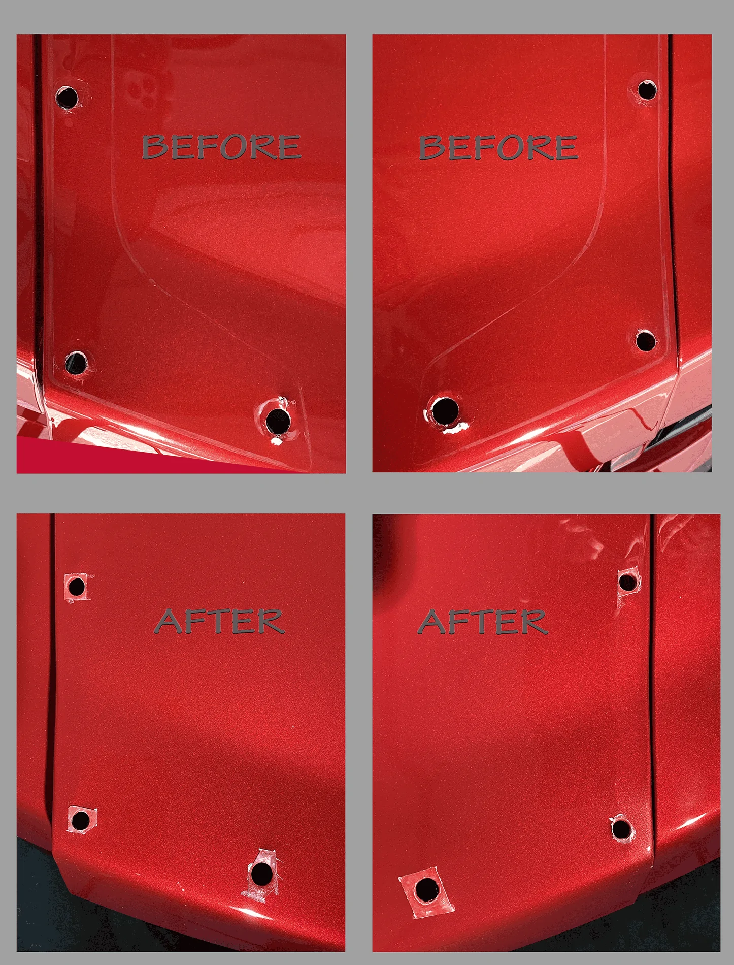

Finished the touch-up work yesterday along with the wing bracket holes. Yanked the tape and tire covers and the plan of the day it to polish all the exterior glass and then give her multiple washes and rinses. When all that's done, I will take the afternoon off and start the coating tomorrow. :cool:

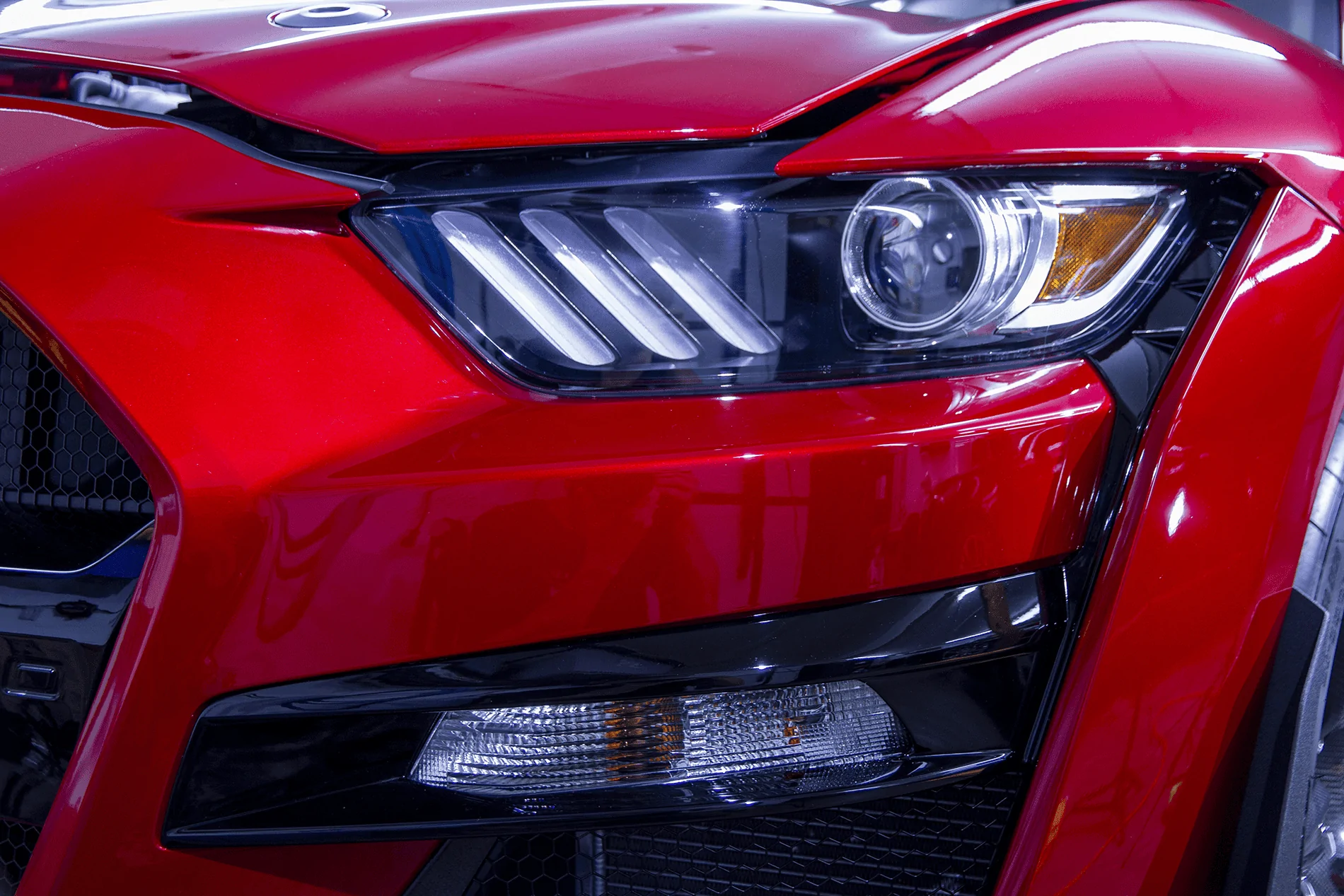

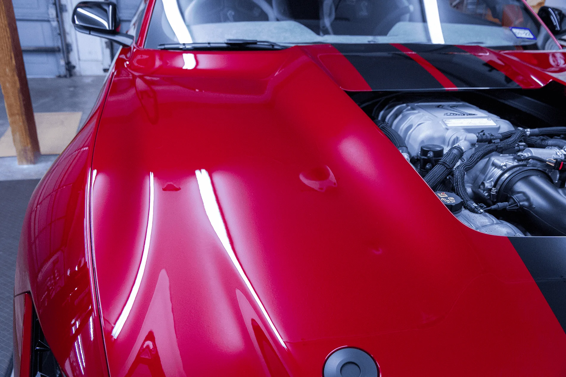

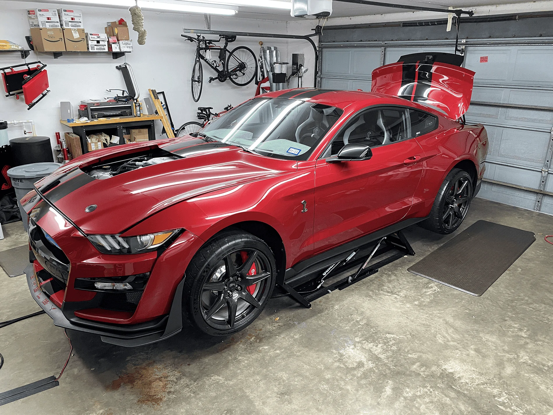

Update: Started early and got all but the rear end and passenger side coated. Pretty long day, lots of time on my knees buffing that stuff off. I'll finish the vehicle tomorrow then, polish the wing, coat it, maybe re-install if Tom's gasket material arrives. The last thing when she's all back together is a layer of Reload and then I'll finally be done. A few more days.
A few fotos from the day...

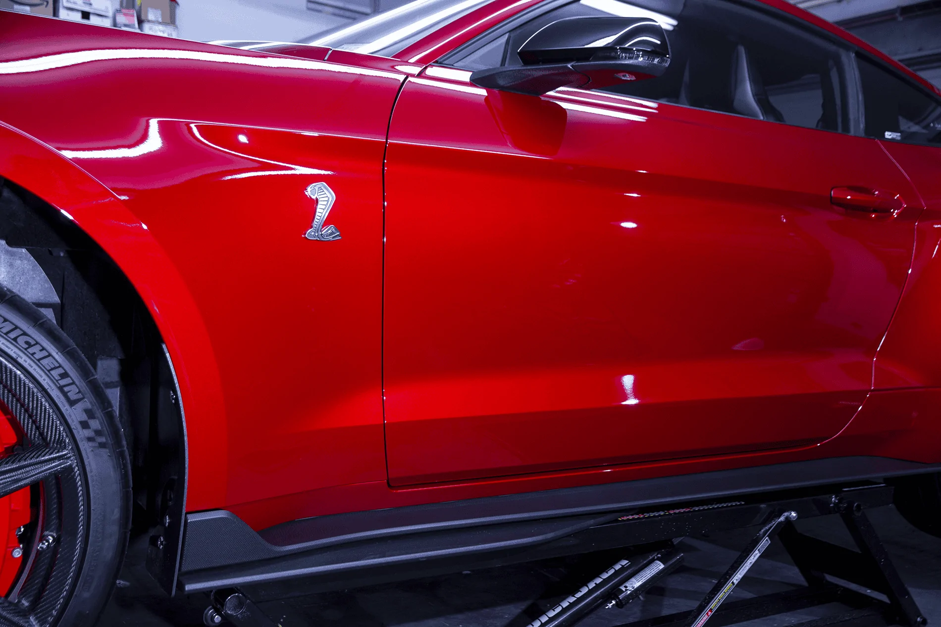

Suma: I'm pretty OCD about wetting the suede and using the bare minimum of liquid. But I used over 50ml on my Mustang and I don't see any way that I could duit with 25. My minimum quantity is 50 so I expect I'll be sticking with C.Quartz or someone else that also offers their ceramic in that quantity.

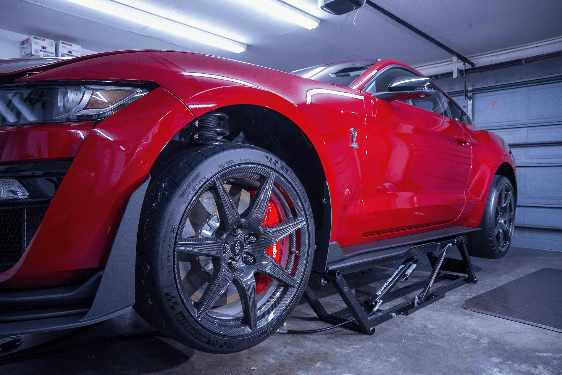

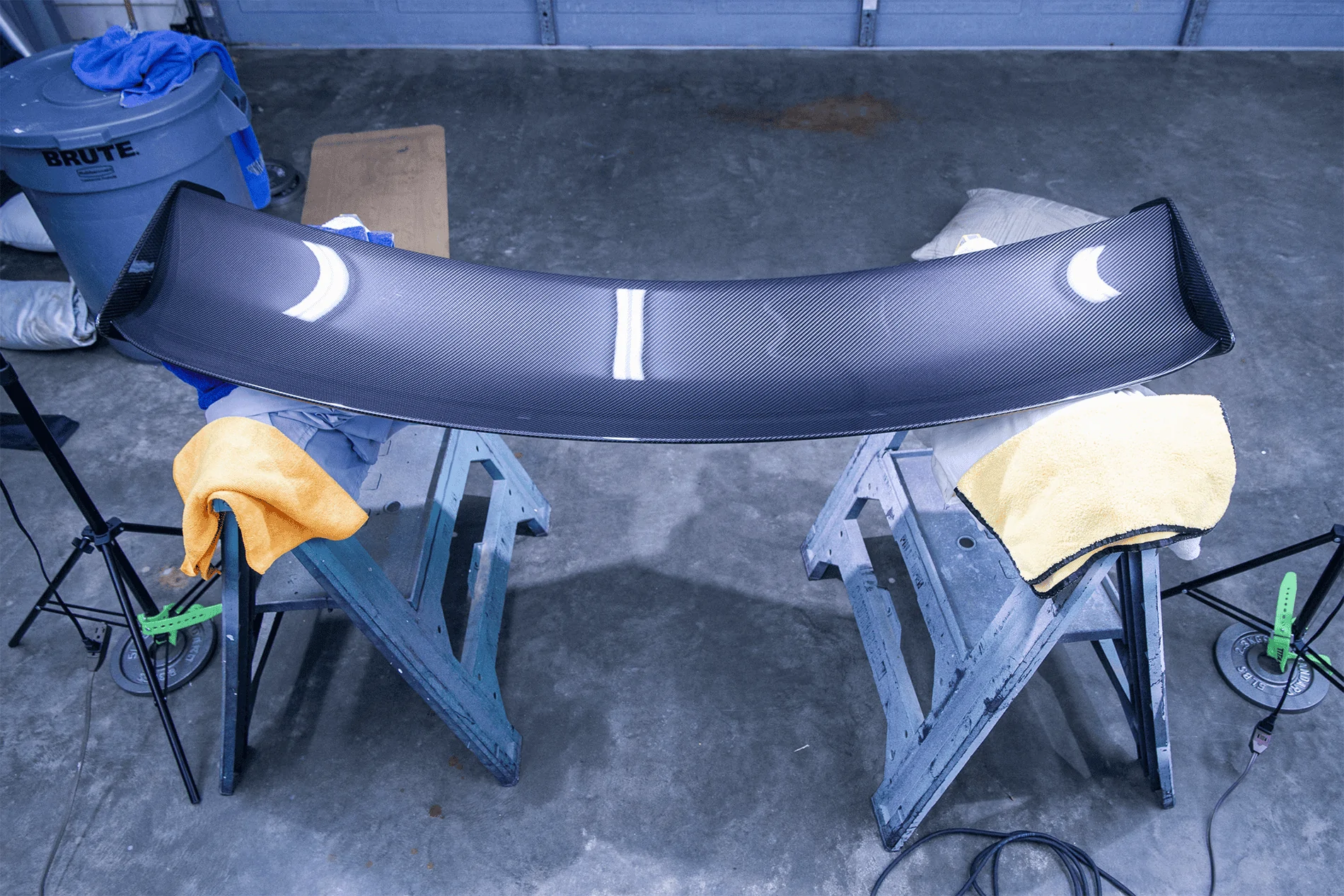

Anywho, for the "waxxerz" <grin>Day 9... I finished the coating on the car today. Then, I polished the wing and put ceramic on the upper surface and will do the underside in the morning. This kinda work can be hard on the bod with all the ups and downs. I am beat but here are a few snaps from the day.

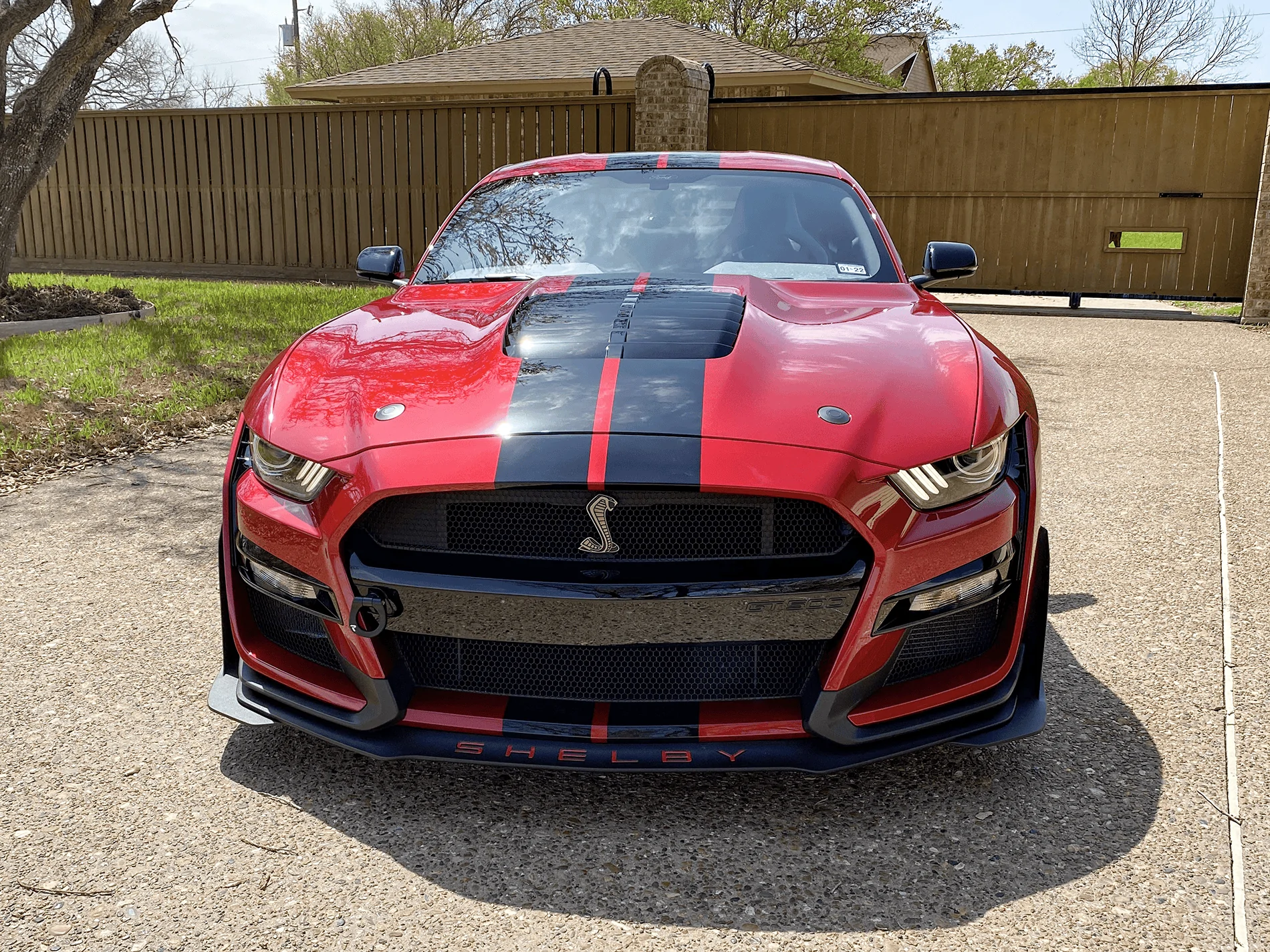

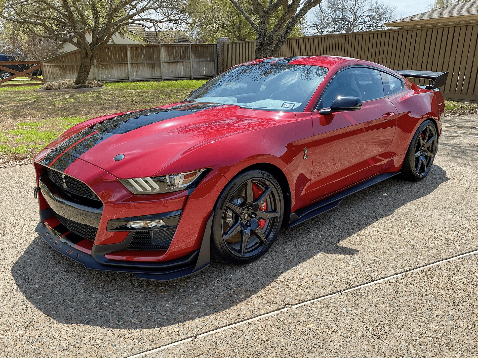

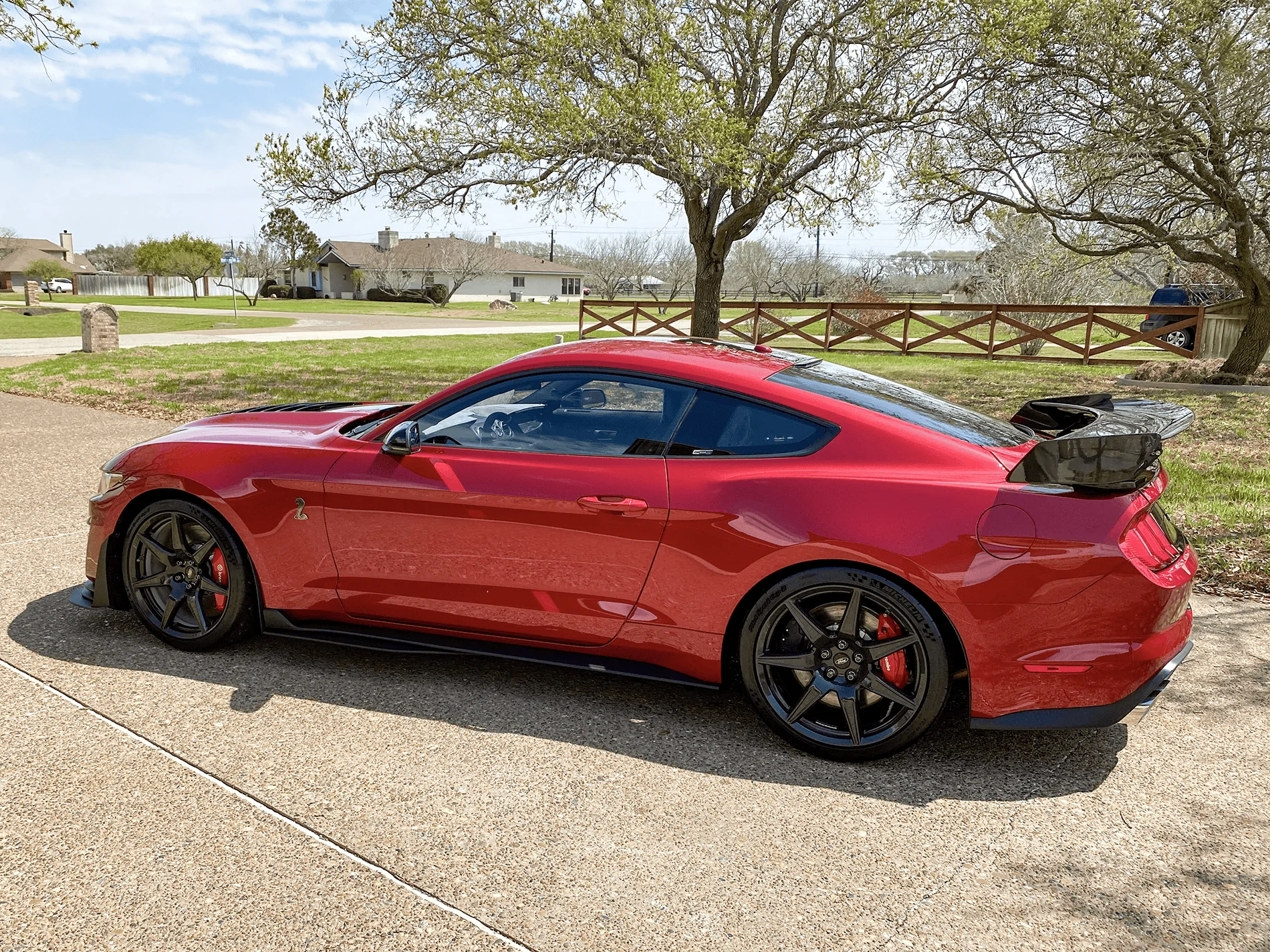

The sun finally decided to show itself today so I grabbed a couple snaps before taking her out for a spin. The last two jobs are coating the glass with Wolf's and giving the ceramic a topper coat of Reload. Maybe this weekend, we'll see where the energy level is. :cool:
