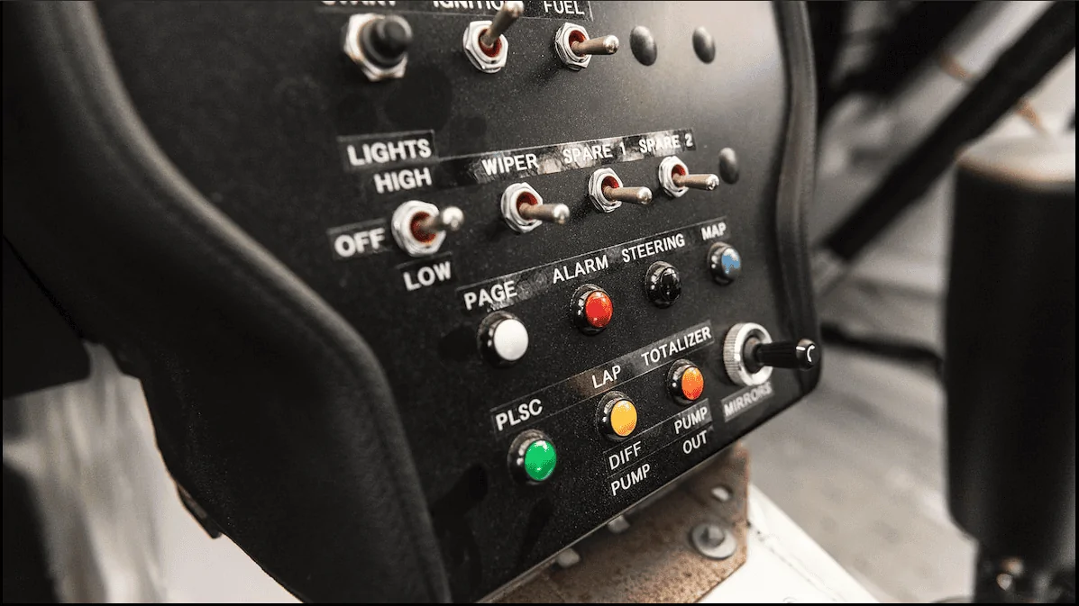

Did you ever do this or find out how?
I know the one I attached is from the previous generation but I really like how it works
