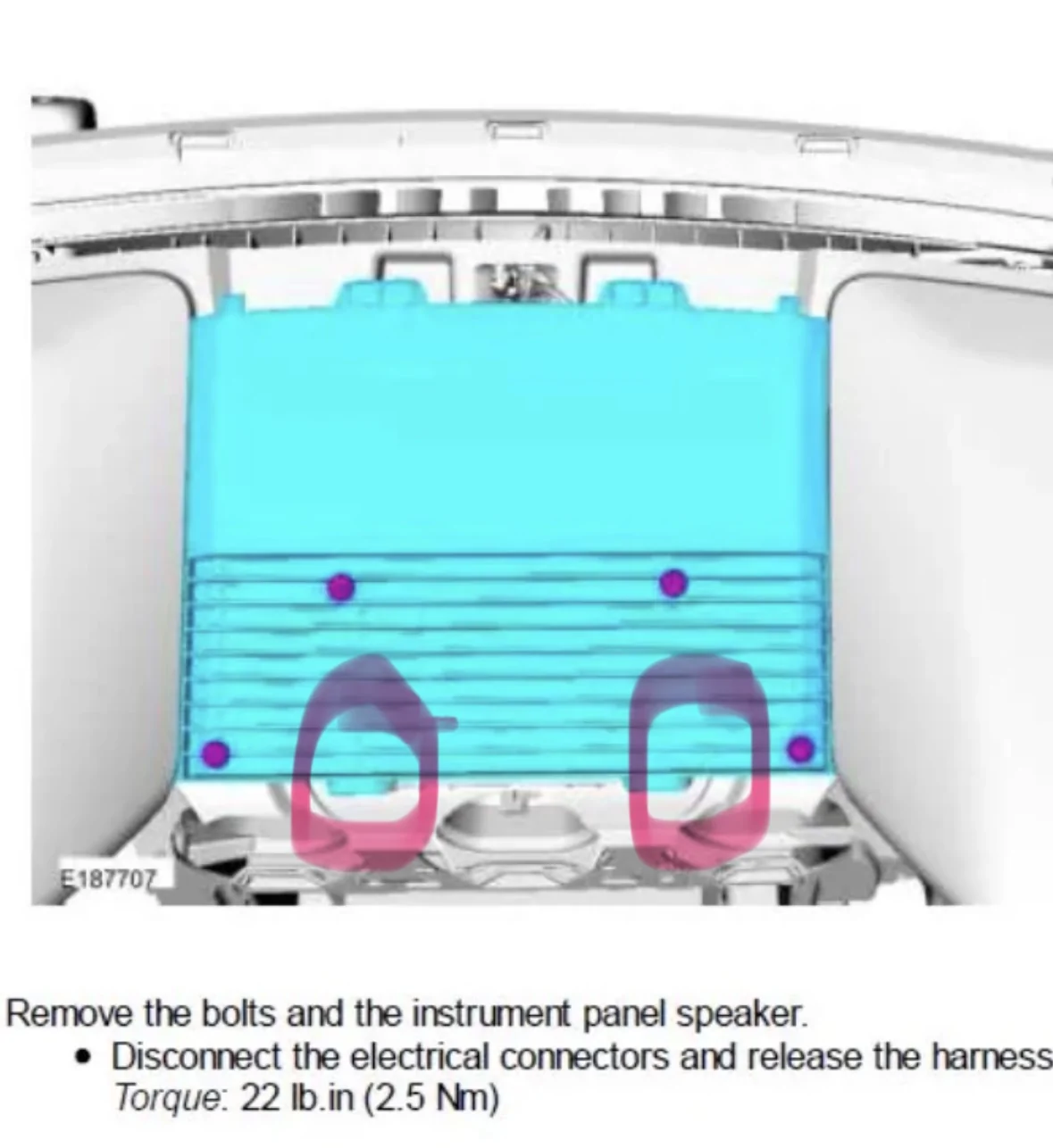

So I finally decided I needed to upgrade the sound for some more depth and bump. Been carousing around all the great threads but haven’t yet seen if anybody has cut the tabs off the center speaker grill that lock into the Center Finish Panel (where the gauges are…along with my $$$ CF dash piece).
I really, really don’t want to try to pop off that Center Finish Panel that has the CF piece taped down to it’s entirety. I saw one video where a gent was replacing his center speaker and he noted that he had cut the tabs off to facilitate said adventure, but unknown when/how he did it.
I’m considering a red hot x-acto knife blade that could possibly sever the tabs off in place, or even a dremel cutting wheel God forbid I don’t put a new racing stripe down the CF between the gauges.
I’m going to put a Dayton PS95-8 in place of the current speaker (both 8ohm). I have used Daytons on a few other projects and they’re pretty spectacular for their price point.
So curious if anybody had shed those two tabs that stick into the dash fascia (circled below) and if the 4 remaining clips are sufficient to hold in place. Or do I just man up and pop that dash fascia (Center Finish Panel) off?

I ended up detaching the center finish panel to get to the center speaker and was able to do so without any snapped tab drama. I dropped the Dayton in and it def wasn’t a step backwards. Not Bowers and Wilkins, mind you, but it’ll do for now.

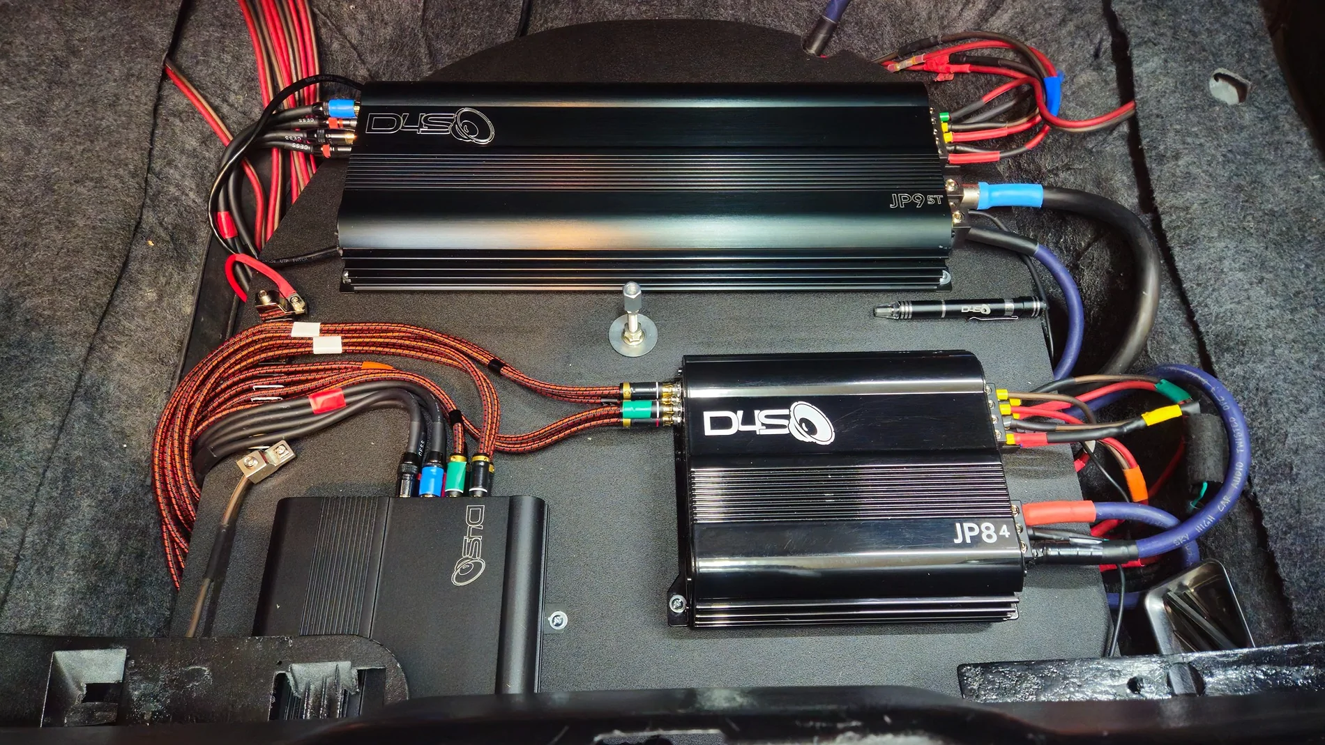

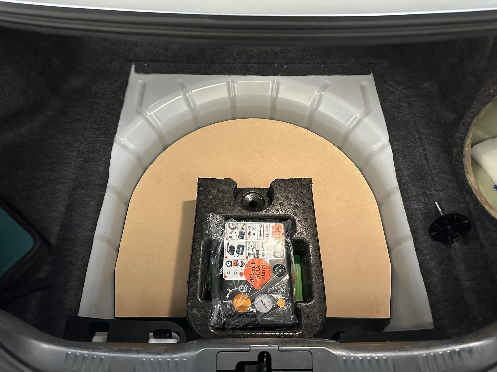

I horseshoed the amp deck around the mobility kit (wanted to keep the support to the trunk floorboard and I don’t need all that space for electronics…tire plug kit fits nicely beneath the mobility kit) and will get that install complete & carpeted this week along with the rear deck Focals. I’ll also be moving the latches forward to provide an air gap to the trunk.
