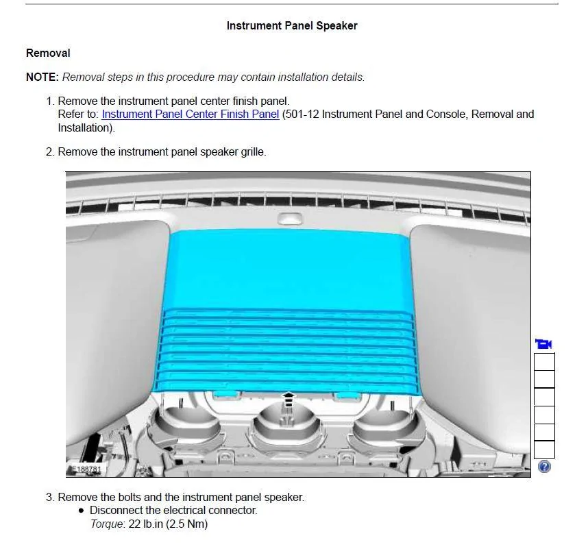

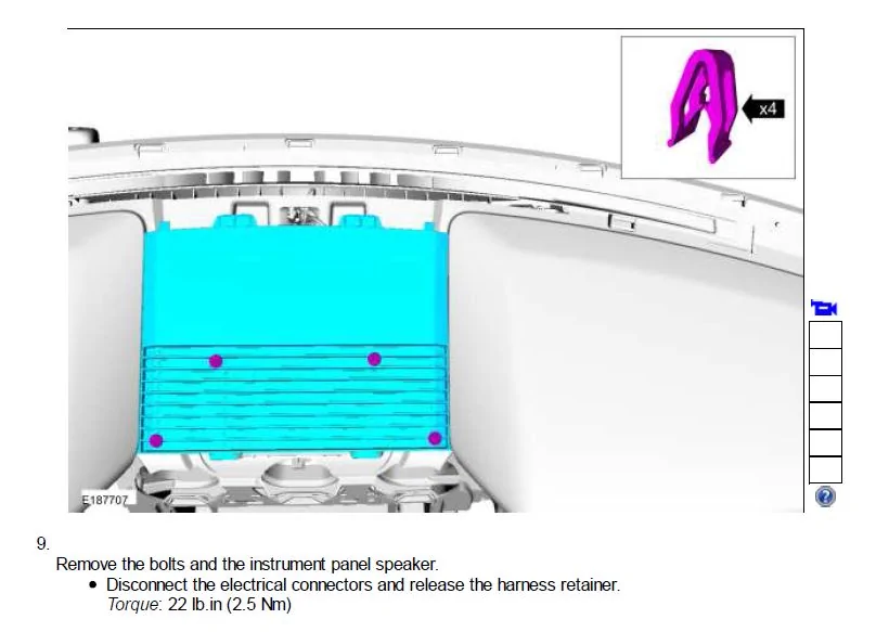

Can anybody explain how to get to the center speaker? I want to disconnect it as I think it over powers the door speakers.

The trim piece covering the center speaker on the dash is just held in by clips. You should be able to pry the panel off and easily have access to the speaker.
You may need to remove the dash panel piece first though (the long piece where your ac vents are on.

Also, those clips like to come off of the piece you're removing and stay in the hole they're sitting in. You need to use a pick or pliers to get them out of the hole, without dropping them.

Maybe I can get to the speaker connector with the front fascia off and avoid removing the cover.
