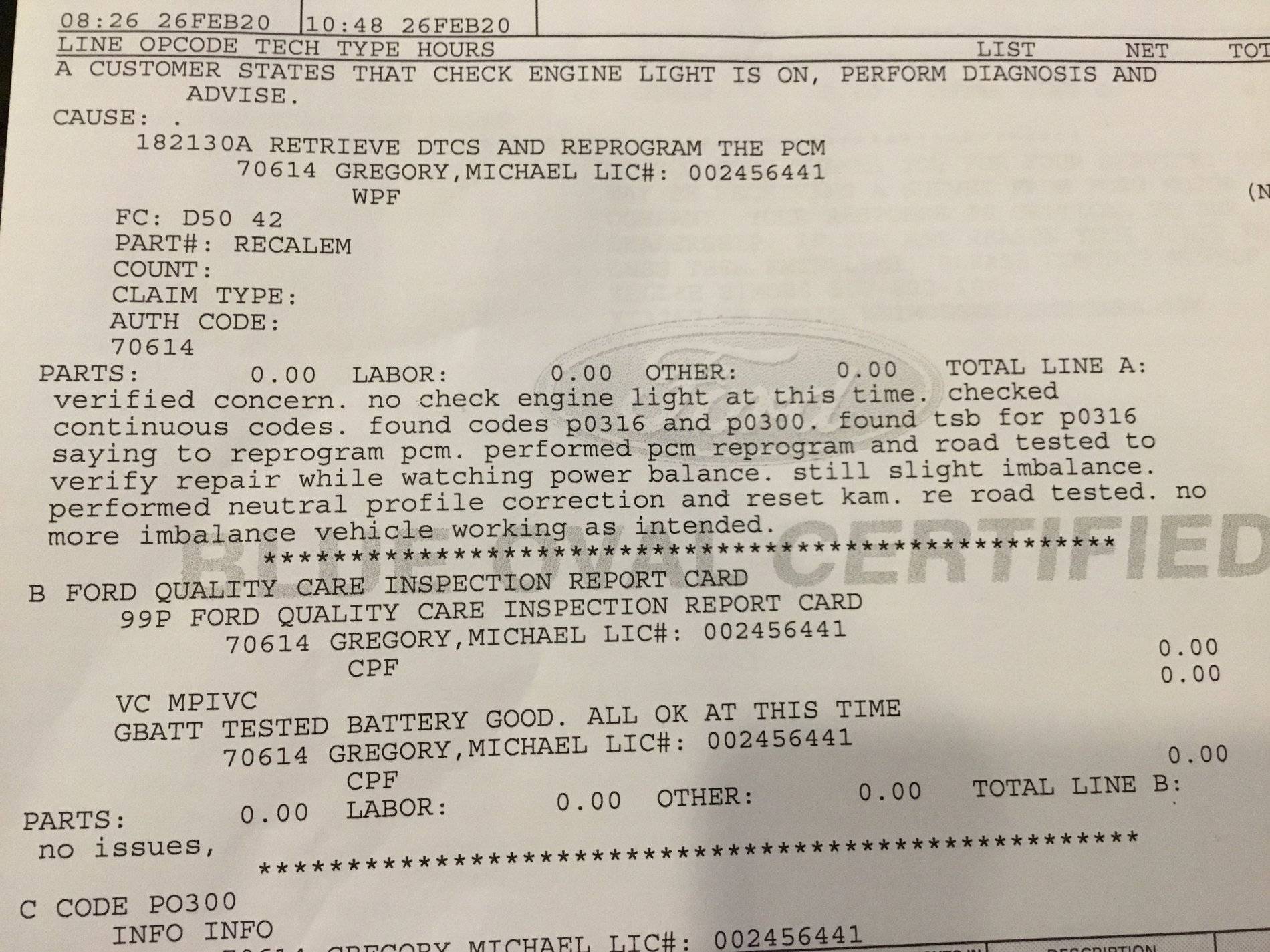

Of course the cel has been on for 3 days this morning it was not but it went in anyway!
Dropped at the dealer this morning, dealer came back with the same codes p0300 and p0316
Please see attached to see the solution they applied.
This also seems to have taken care or the A10 trans lurching forward during shift from park to drive and the hard drop in gear going from 4th to 3rd in normal driving mode.
Hopefully it doesn’t come back.
