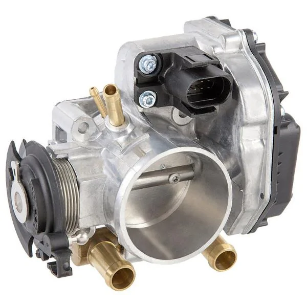

Had my light come on today. After work I went to start up. It started and I went back into work came out 5 minutes later and the car sounded like shit! Went to give it gas and nothing at all. No response from the pedal. I turn the car off and restarted the car. The car then run find, but the light is still on. It's very cold outside today as I'm in Chicago and today was about 2 degrees. I am dropping the car off tomorrow afternoon at the dealer so I should now more on Wednesday. Lucky for me I have the rest of the week off.

Ok just got off the phone with my dealer. They said the code was for the throttlebody. They have ordered me one and it should be here tomorrow and I should pick up my car tomorrow night. What would be a reason why the throttlebody would have gone bad already? Car just hit 10000 miles
Stuff breaks, there is always some failure rate on about everything made ... you just happen to get a bad one.

I hear you and it's no big deal. I had a throttle body go in my truck last year. I'm just wondering if it's the way I drive or if there is a maintenance I should be doing.

I don't see a throttle body failing from how the car's driven. Probably some kind of electronic failure inside the sealed area of the throttle body. This one might not have liked the under hood heat for some reason.

Could it be possible the flap froze inside the throttle body?
This is why they ran engine coolant through the throttle body to keep it from freezing.
Idle creates some moisture and when its really cold the moisture builds up by the throttle body and froze before the coolant had the chance to heat it up.
