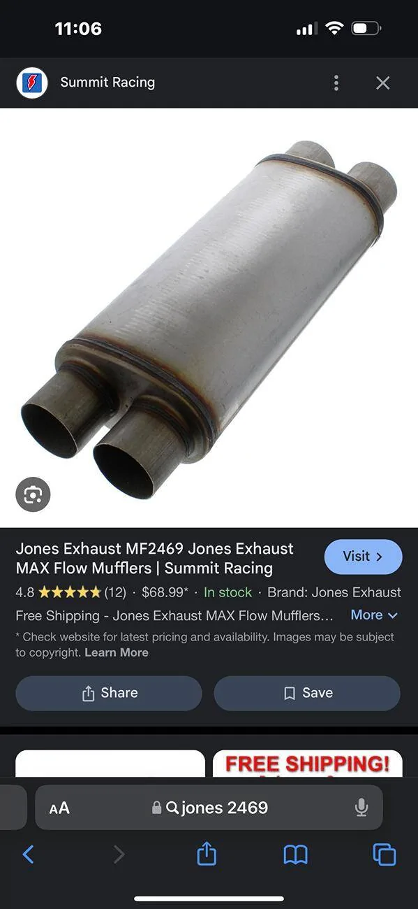

This made my LTH car soooo much better, true dual 3”, no neck down either
Just find a good muffler shop to weld it in.
I have incredible tone now, it eliminates your tiny restrictive resonator with a muffle packed X pipe

I currently have the MBRP race which I'd like to leave alone, just want to add some resonators/mufflers in place of the 2M cat delete pipes so it isn't too loud
