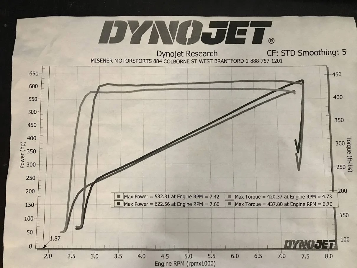

No problem! Yeah, I'm sure there's a pretty wide safety margin above 1650, don't think there is much to worry about with the cats as long as whatever tune you run leaves that protection routine in place. Like I mentioned, mine were smelly after a pull(not rotten egg, more metallic), but that's about it. Didn't smell like that at any other time.
The LTH and high flows were good for about 40 wheel, I'm betting most of that was the cats. Definitely feels a little more responsive overall. The shop that did the work dyno'd the car before and after, but I wasn't present and they ended up doing it in 4th gear which isn't 1:1, so not sure how skewed the numbers are... the torque numbers seem way low for what this kit should be putting out, but I'm happy with a ballpark.
