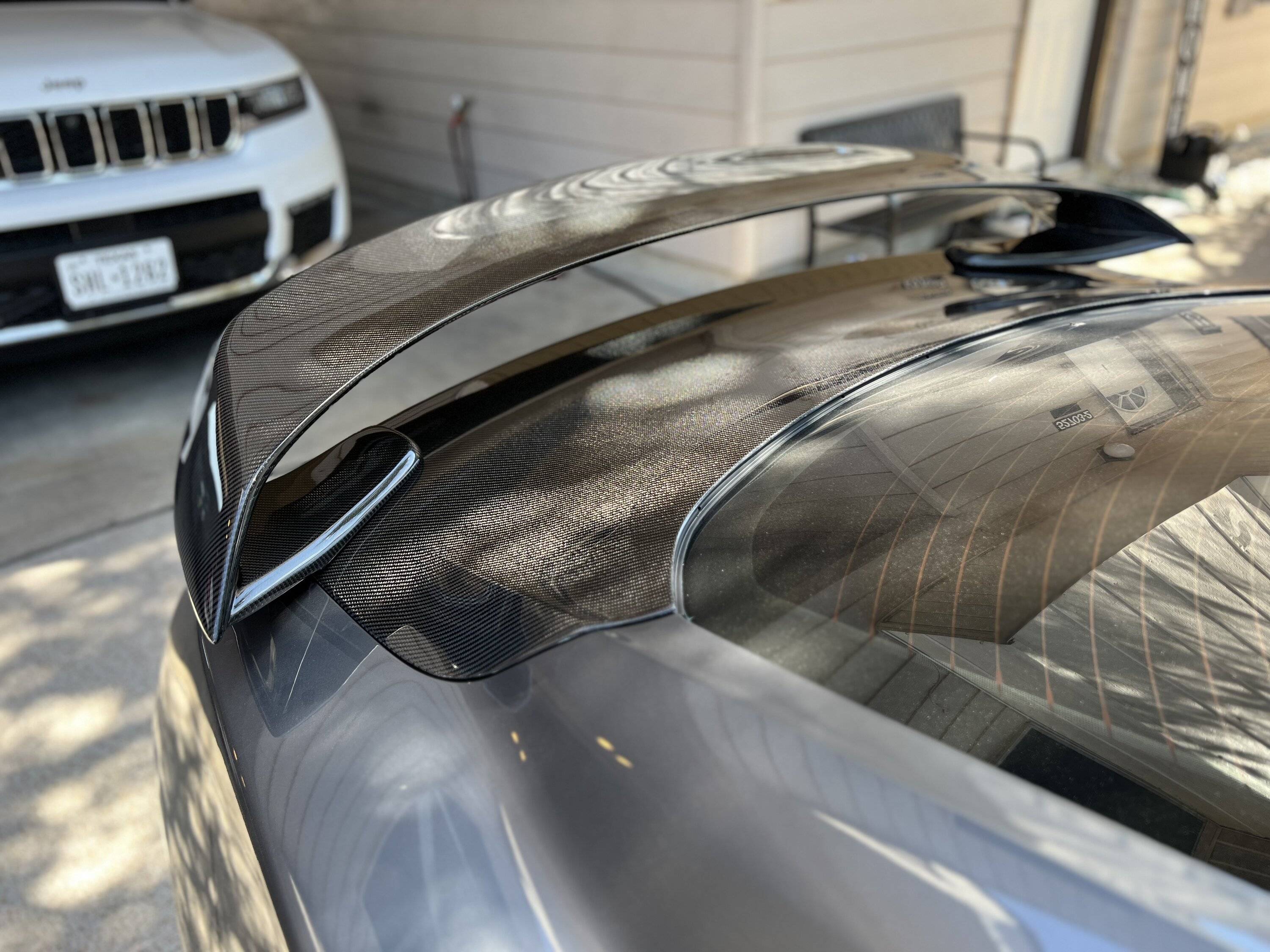

I have Anderson Composites 350R wing on their OE style carbon trunk. No issues here. Not sure what you use your car for but normal Texas highway speeds it holds up great!
AC site says no to mounting a wing on it. I called just to confirm. I'm looking at something with way more downforce than the GT350 wing unfortunately, or that's the route I'd go.
Thanks, and yours looks great BTW!

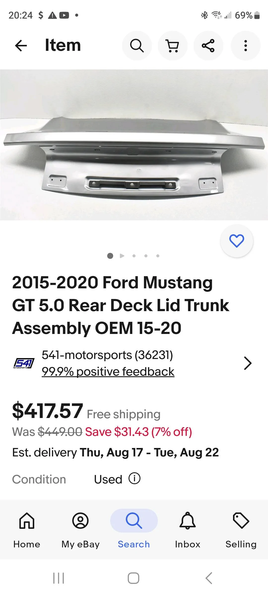

Several on ebay, some in better shape than others, some with shipping some not. Here's an example. A little bit of damage but you'll have to paint it anyway.
