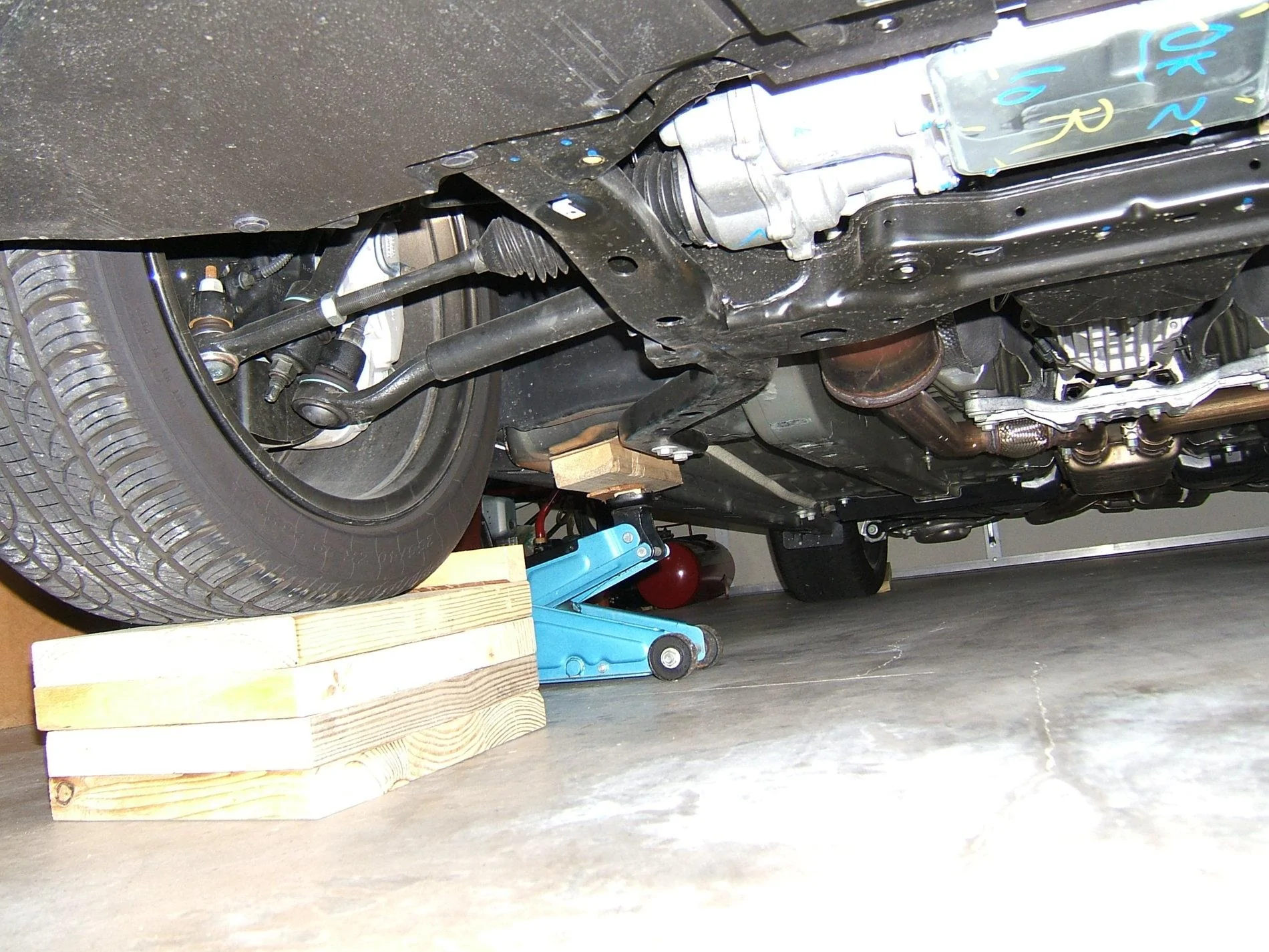

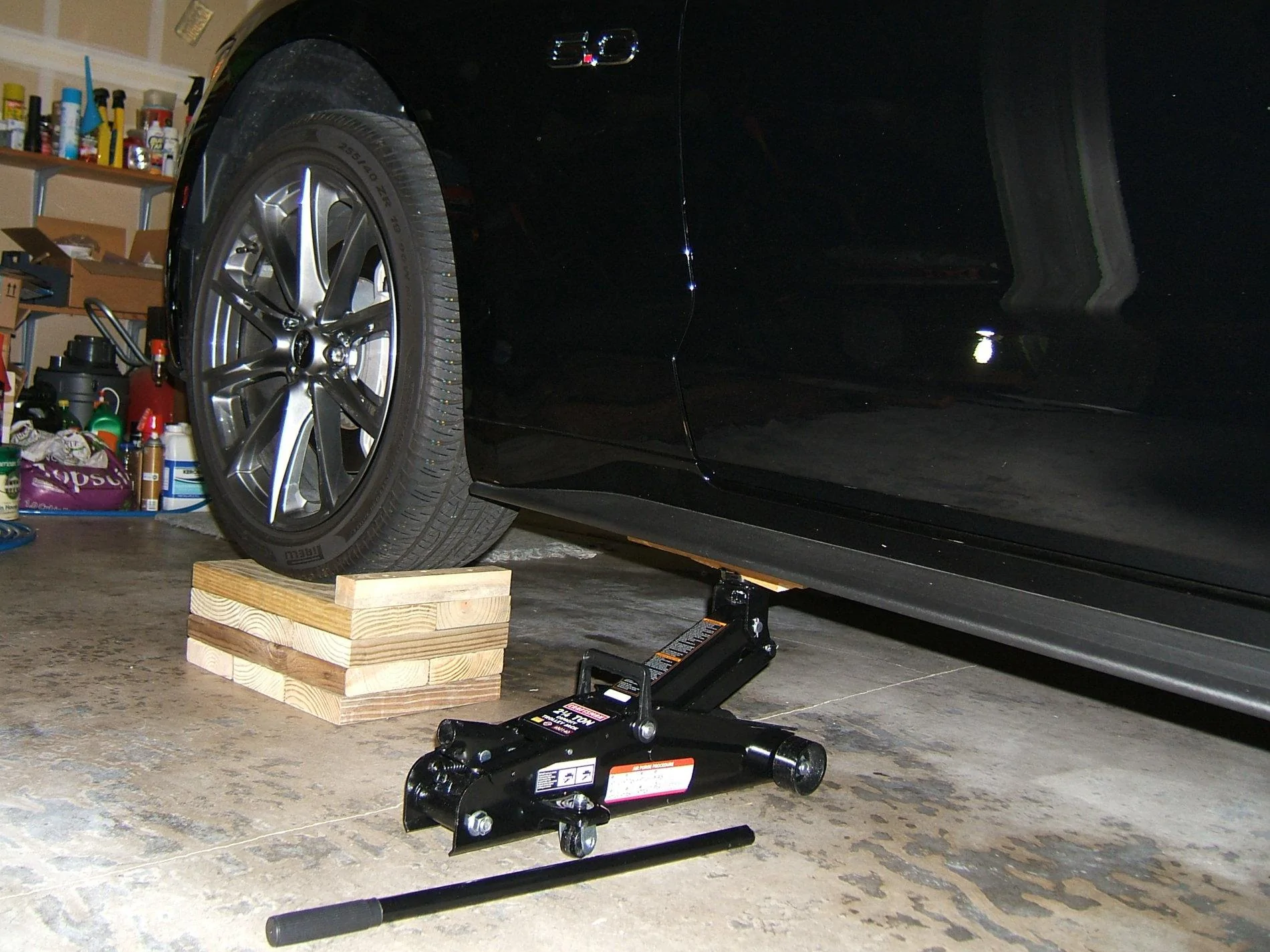

I go low cost old school ... made up some 6 inch high wood blocks from 4 x 6 planks. Two 3 inch layers that are screwed together with decking screws. I can lay under the car and get all the way back to the transmission easily. Works nice for oil changes.

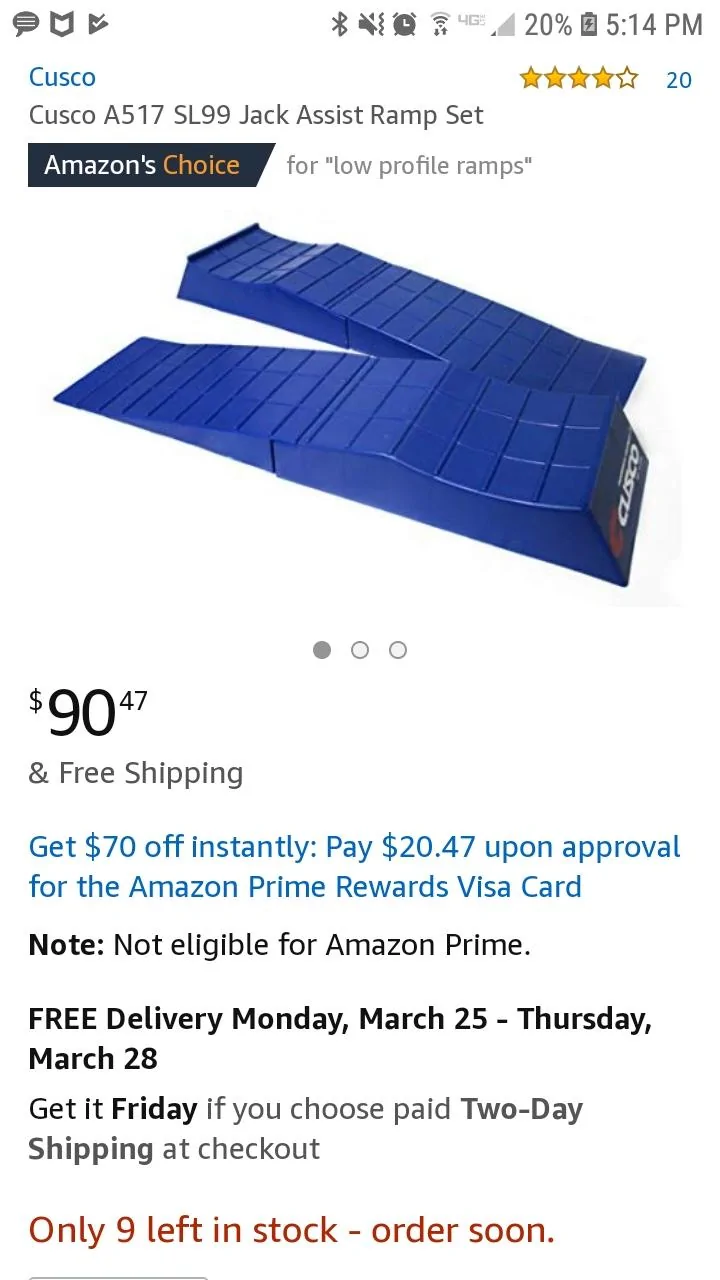

I use these, they allow me to slide under the car for quick stuff. They don't have much height to them though.

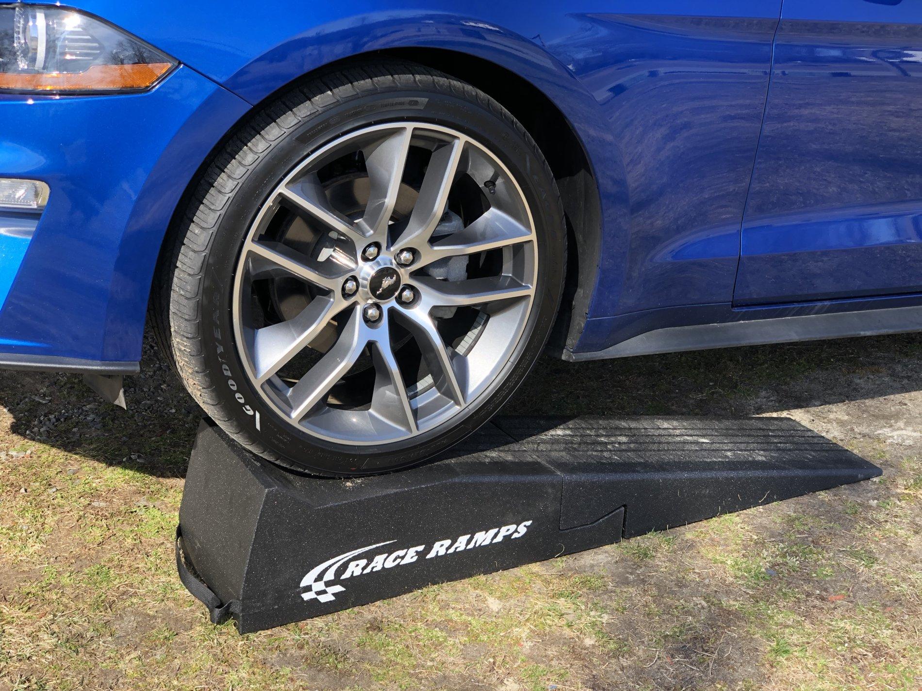

I went with Race Ramps.
