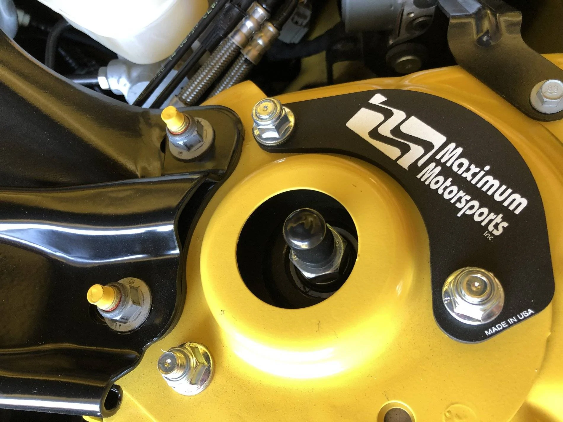

Hello there,
I'm considering the fact I'll likely need camber plates soon. As I am researching designs, I'm commonly noticing in the popular options the following:
the plate where the strut is mounted (IE the one that slides to provide adjustment) is sandwiched between a lower plate with studs and the metal of the shock tower.
I'm concerned that as adjustments are made the plate will scratch and wear the strut tower paint exposing it to the elements and corrosion. Are there designs that do not use this design feature and protect the shock tower paint/metal? I presume the reason for this compromising feature is to not increase the ride height by adding a camber plate.

I believe there is usually a plate above and below the sliding mount, so the parts touching the car don't move when its being adjusted.
Not that I see for the ford design, maximum motorsports, and BMR.
I'm not sure about the Vorshlag or J&M. Those ones it appears for camber adjustments at least the strut tower is protected.

The concern is under the shock tower. The top side doesn't have anything that moves during adjustment. On that design the plate slides against the paint under the shock tower.

Ok so that too plate stays under the tower? I like that.
I wasn't sure from the instructions if that stayed under the tower or sat on top like the maximum motorsports design someone posted.
