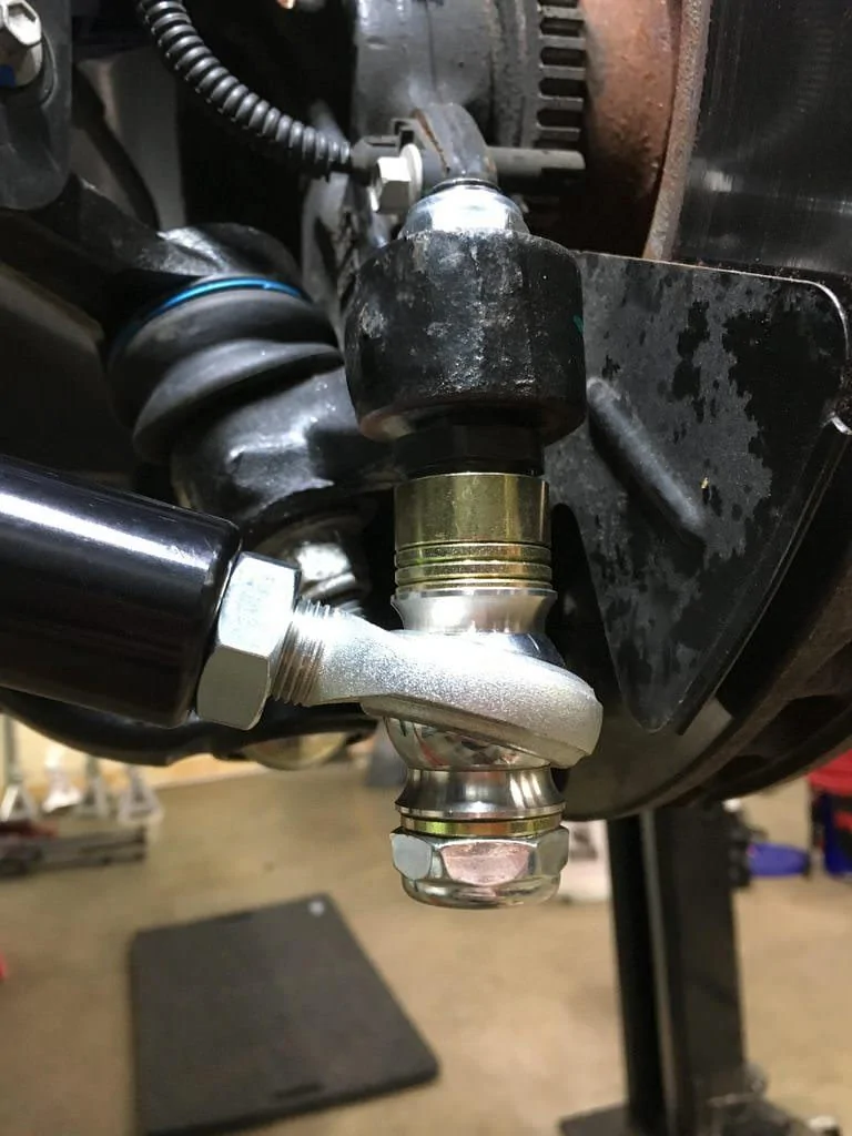

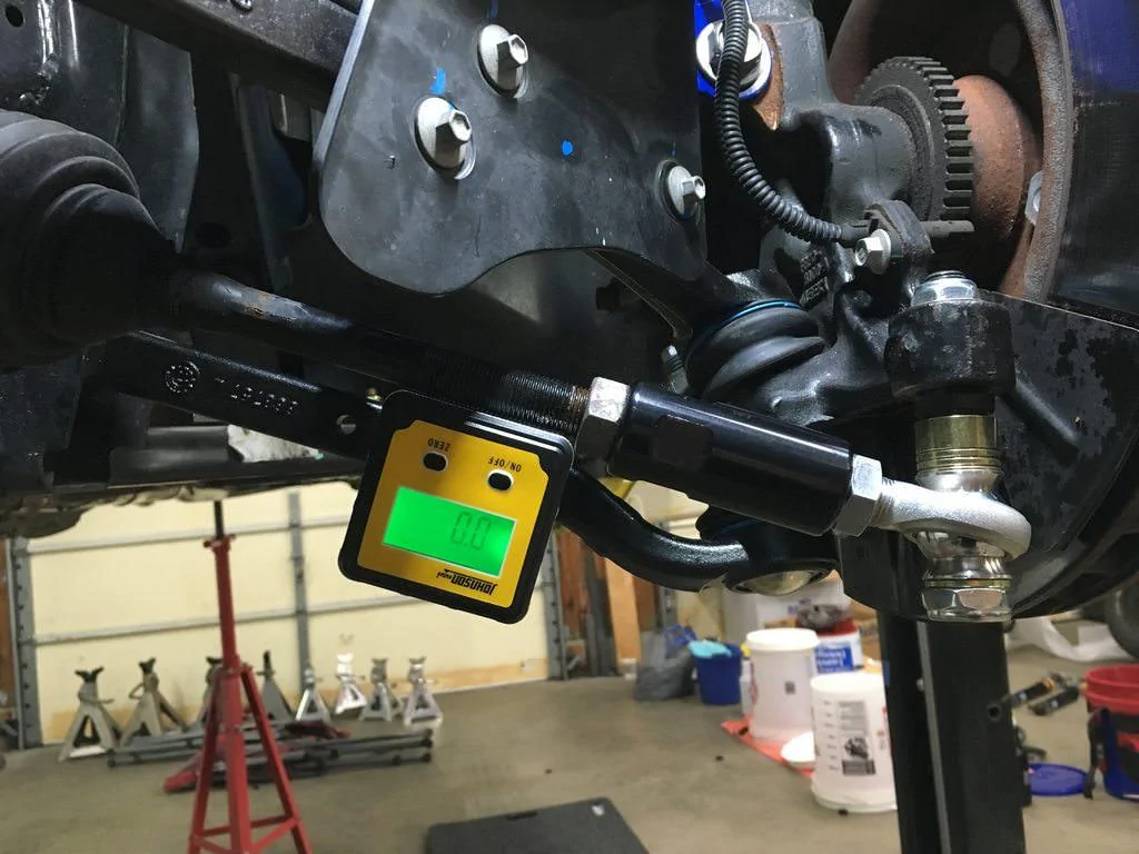

Okay, got everything installed. Just took an angle gauge and zeroed it on the lateral link, then adjusted shims until it zeroed on the tie rod, rinse & repeat. I realize there’s a number of reasons this might not be the best methodology, but hey this is shadetree shit we’re doing here.
Here’s a shot of the shim stack up.
I had to spend some time getting the toe back to zero, the Steeda directions have you move the tie rod jam nut more than necessary and it was toed out pretty bad. Cobbled together some stuff to get some reasonably accurate measurements so it’s at least halfass close for the drive to the alignment shop.
