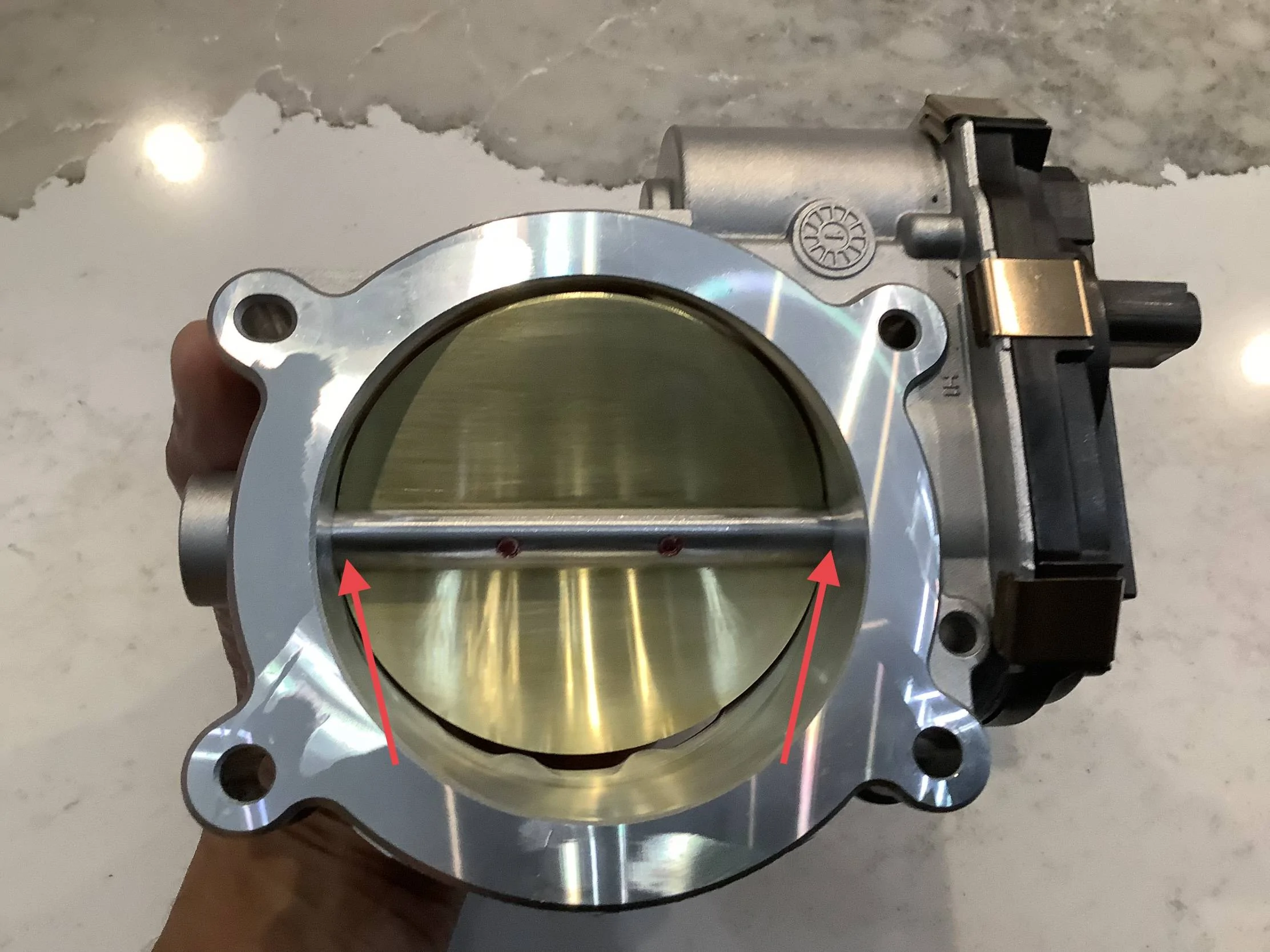

Have you pulled the tb and cleaned it thoroughly? They can get gunked up around the blade’s shaft where it enters the housing on either side, which could affect the way it functions.
I use brake and parts cleaner to clean mine.

You also said you checked the MAF sensor. Did you visually check it or pull the housing with the sensor still installed and thoroughly clean it using MAF Sensor Cleaner?
One last thing I’ll suggest is not to overtighten the clamp, as you could deform the tb housing and cause it to become out of round which can also lead to the blade sticking.

Anything is possible with electronics. I do recall seeing a procedure for recalibrating the tb. You might try doing a search for it and give that a try as well.
I run a Soler Performance ported factory tb on my Bullitt. I did have problems with it sticking open and shut when I first installed it and sent it back to Soler to adjust it. Whatever they did corrected the problem and it’s been fine ever since for over a year now.
