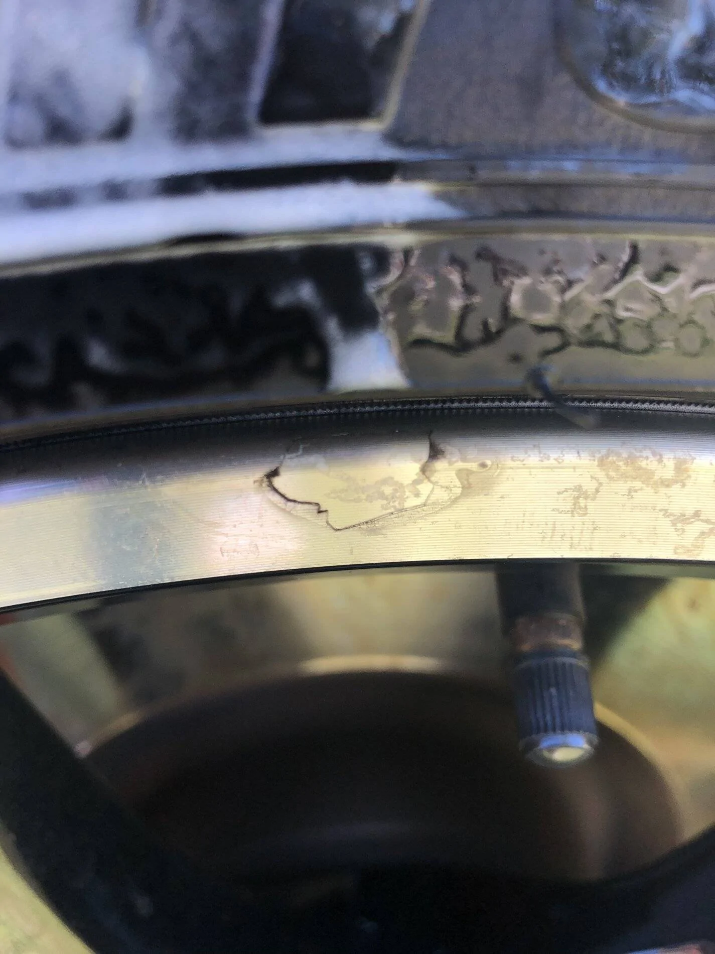

Hey guys just wanted to know if anyone else has come across this. It looks like there’s a thin layer of hard plastic on the edge of the rim and has started to crack off? Or is this some kind of transport protection that was never removed?

that's the Clear cot over the machined portion of the rim, its chipping off

Did the wheels see a harsh winter? Wondering if road salt may have caused that?
no salt roads or harsh winters here in Houston. Maybe the humidity and heat lol
A wheel restoration place can fix that pretty quickly. Take off the old clearcoat and re-apply
That happens when the clear gets chipped ever so slightly and water creeps underneath.

You should not call residents of Florida little critters, they don't like that. :D
And yeah thats the clear-coat shedding, shouldn't that be a warranty thing? It doesnt appear to have had a rough night with a curb.

You can get them stripped then powder coated any custom color for about 100 a wheel at most powder coat shops. Powder coat is very durable.

If you're still under the 3 year bumper to bumper, you can get the dealer to replace the battery for you. Same for the wheel issue in the OP, that should be covered under warranty.
