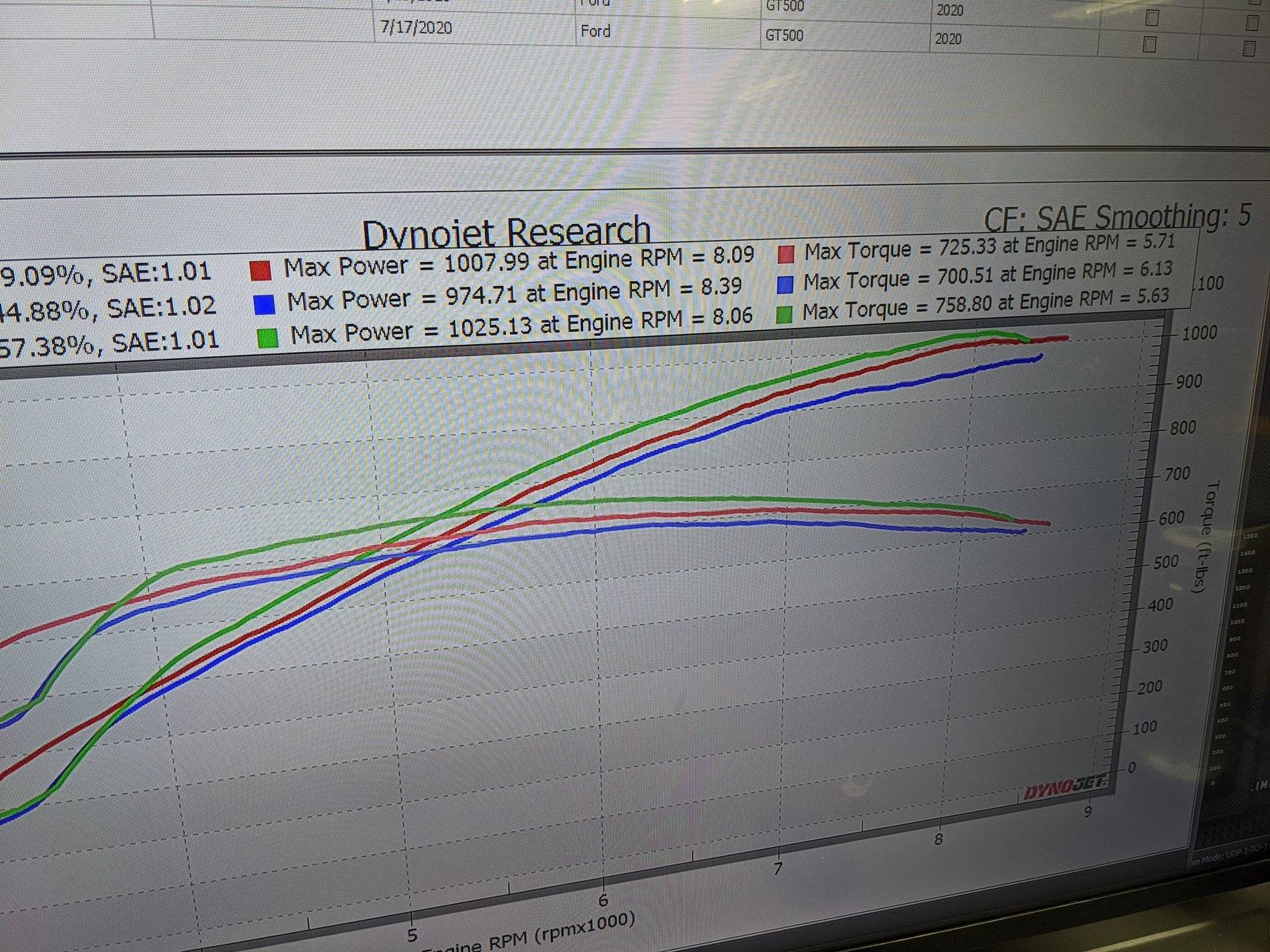

Right?!!! And that silly GT500 with lower compression running E85 and a tune only makes 2x "ass loads of power".
Soooooo Silly... pweeeeeeee...
I guess PBD is faking these numbers on stock block 2020 GT500?
He must be Silly tooo!!!
Silly 2.7 pulley on e85:
2.xx pulley goes 1100+ rwhp.....
(strange he talks about octane limits... hmmmmm)
looked for videos of E85 12:1 making 1100+ rwhp... cant find. you gots?
Sigh,
Yes, if you put a teeny tiny pulley on the same blower on a 12:1 motor you'll get the same (actually higher) results. You're proving my point. In that video they're nearing as small a pulley as currently made/available and running 21 psi to get there. You can make 1100 rear on an 18+ or 350 motor without spinning it. to 21 psi.
Secondly, you say "stock" motor like it's apples/apples with a voodoo or 18+ coyote motor. It's not, the 500 motor is "semi" built (as reflected in the fact that it cost WAY more).
If we put 2 motors, equally built (or not built) one with 12:1 and one with 9.5:1 and both on E-85, the higher compression motor will make the same power with reduced boost. That's the entire point of this debate.
Spinning the blower has detrimental consequences and limitations, including:
1) a reduction in adiabatic efficiency (aka, the higher you spin the blower, the more parasitic losses you incur and the more power you have to make for every hp/lb-ft that actually make it to the tires)
2) An increase in either IAT or intercooler required to keep equivalent IAT. Since the size of the intercooler is fixed for a comparison, spinning to 21 psi is going to result in higher IATs than it's counterpart boosting less (but at the same power)
3) Belt slip gets a vote, so eventually, trying to spin the blower to the moon is going to result in increased likelihood of belt slip, which again, reduces efficiency OR requires the use of increased rib system
4) As you see in the video, he didn't make that with a stock blower, it had to be PORTED in order to huff hard enough to reach those levels (unlike it would have if it were higher compression). As you spin the blower upward of it's efficiency range, restrictions in the blower's plenum and related architecture become a serious impediment to efficiency.
The real question is....who will tap out first, the higher compression motor before it starts seeing knock at elevated boost, or the lower compression motor when it starts bumping up against the limitations of the blower and the intercooler and belt/pulley and getting greatly diminished marginal returns.
My position stands. If lower compression is so great, then we'd all be running 7:1 compression and 35 psi on pump 87.
It's EASIER to reach 1000 rwhp on a 12:1 motor than it is on a 9.5:1 motor (on E-85 with the same blower architecture). Period. End of story and debate.

I think the boosted GT350 vs GT500 is a great comparison.
It’s true that Palm Beach Dyno did spin the little 2.65 blower pretty fast to make 1100 wheel with the 9.5/1 GT500, 22 psi apparently. They did break 1000 rwhp at 19 psi.
I’d like to know what boost, exactly, it took a 12/1 GT350 to make 1100 on a supercharger, for comparison’s sake. Brenspeed seems to think it takes 20 psi to hit 1000, and that’s with the larger, more efficient 3.0 liter Whipple blower spinning slower, 12/1 compression, plus a sleeved block.
I must admit I haven’t done much modeling and benchmarking on E85, but it still holds true on E85 that for any given peak cylinder pressure it will have a higher average cylinder pressure and, thus, make more power and torque.
We're kinda muddling several issues though.
1) The composition of the block/internals (other than compression) isn't material outside of it's ability to withstand the levels being discussed. The 500 motor is slightly or marginally built. It's not the same internals as the voodoo or the coyote but it's not comparable to a fully built aftermarket setup. For purposes here, let's set it aside and assume both motors can handle what we're asking of them.
2) The 2.65 TVS blower is nearing the top of it's efficiency range, but extended due to the porting. The 3.0 liter is indeed more efficient and a better blower, but at power levels being discussed is just starting to reach it's stride. There's cars running 1300 rwhp on a 3.0 gen 5. Either way, let's pick one blower and compare the two (to be apples/apples).
It's true that running a bigger starting blower on both approaches favors the lower compression (which is going to ask for more boost).
3) Heat is a pay me now, pay me later affair. Whether you compress the air before you mix or you compress the mixture, it's going to generate heat. The question is, can the intercooler manage the additional heat sufficiently to give it an advantage pre-mix, vs lower charge air temp and compressing post injection.
I think I've summed up the question and framed it well, will the higher compression cry uncle (on E85) with timing to control the peak dynamic pressures before the limitations of more boost cry uncle (or present significant challenges to overcome with 10 rib systems, overdrive systems, having to port the blower, having to run additional cooling, etc). Remember something like meth injection or a 50 shot of nitrous kinda resets the bar for the high compression motor. So it seems both approaches have things that can extend their efficacy.
I'll summarize by saying, again, on pump gas, I would keep compression lower and raise boost. But on E-85, with the power levels that MOST of us would be even theoretical to pursue, there's no need for it and you're just leaving power on the table and having to strain the capability of the blower/intercooler setup.
For anything less than full on competitive drag car, I'd run E-85 and high compression and keep the blower/intercooler system manageable. But that's me. Choose whatever works for you.
