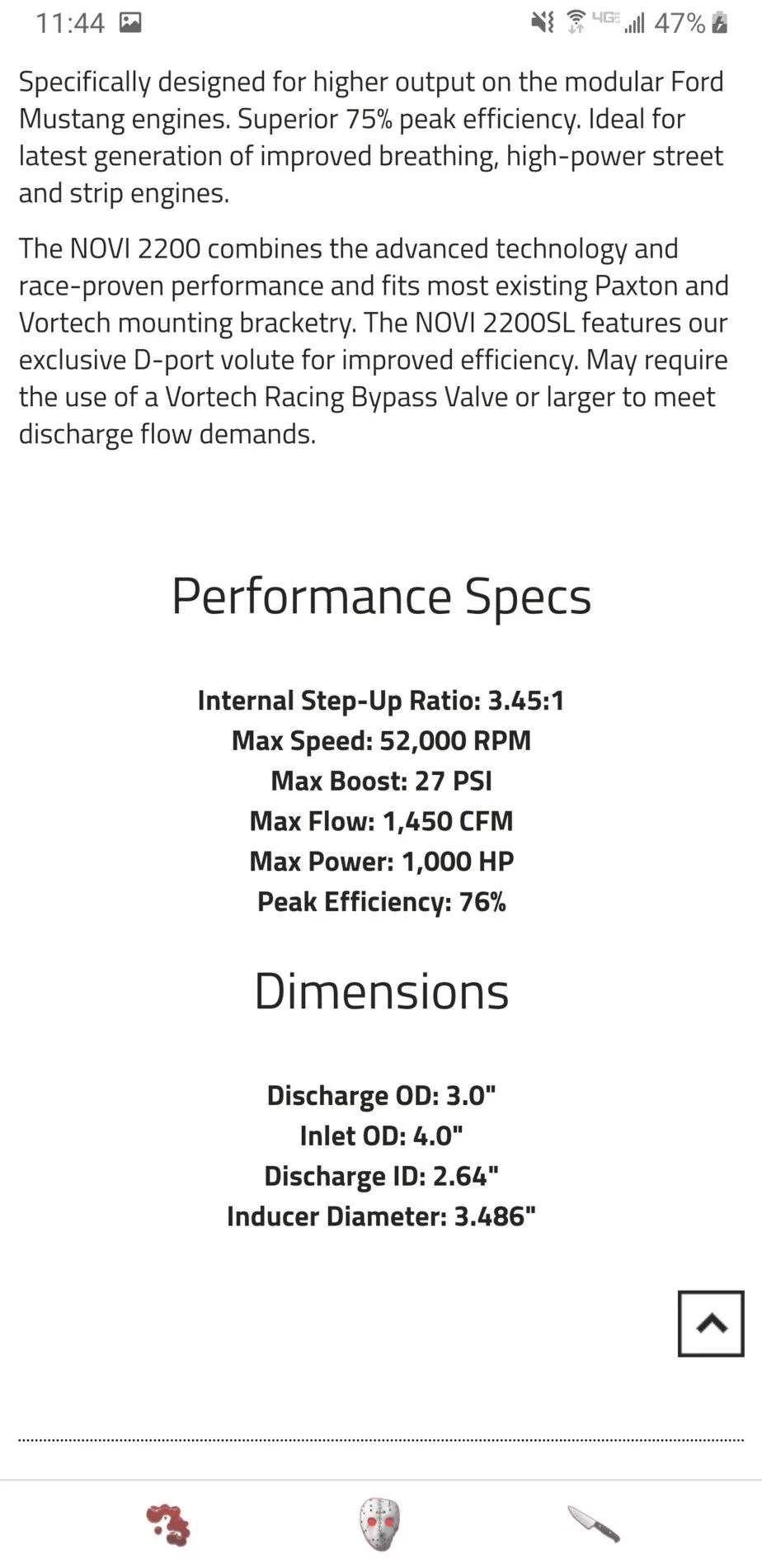

I don't get why the Paxton says on the website it can handle 27 PSI if you can't even put the thing past 15 psi without over spinning the blower too much.

Does it say the 2200 sl,websites can be vey decieving.I know the 2200 wont make 27 psi of boost.

Yes it's definitely the 2200sl.

Max PSI is just that max pressure rating. 100% depends on the engine it’s on. 665” big block it wouldn’t make 8 lbs at max rpm, 3.0L V6 it might make 30 lbs at max rpm. It doesn’t mean it should make 27 on a 5.0. Or if you spun it to max rpm at something ridiculous at like 4,500 rpm it would make mega boost because the engine isn’t consuming as much volume.
People get hung up on boost #’s. Boost reading is the excess air the motor isn’t consuming. CFM tells you much more, but there’s no practical way to measure it without converting maf lb/hr into cfm. Especially since our maf meters max out pretty easyboosted.
