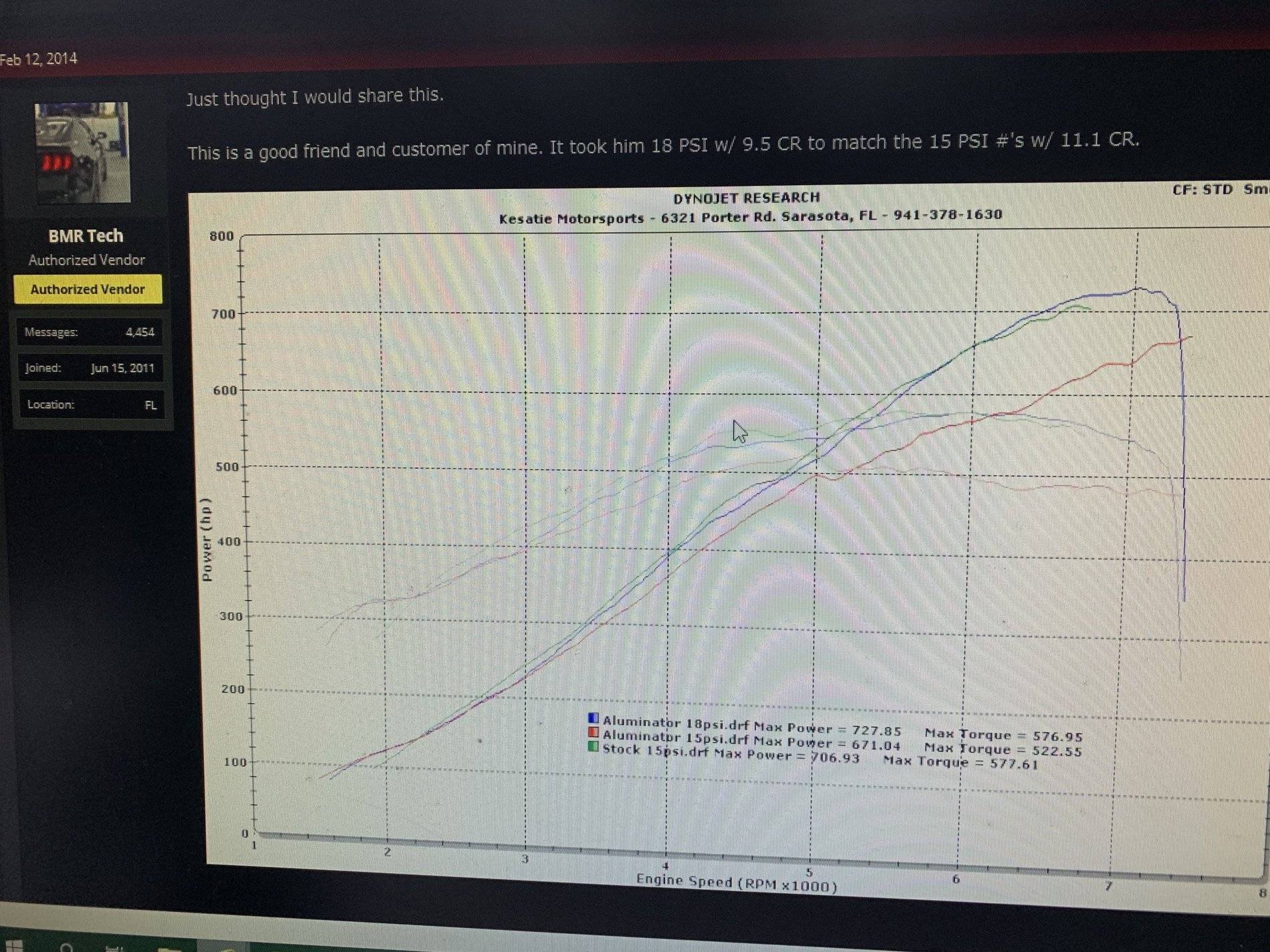

Here’s a fascinating thread where several folks dropped compression of their coyotes and reported results. The very worst result was about in line with what I’ve posted already, With others having much better results. They seem to like their Aluminator SC’s.

Since he linked that thread. Took 3more psi to match the peak power of stock 11:1. That’s on ethanol fuel. Waiting for the engineer to tell me on 93 and a “couple psi” he would match the output of E85/x boost/11:1. FYI we know coyotes gain anywhere from 60-100hp from pump to e85. So really 3psi extra on 93 and low compression will not match 3 less psi, e85 and 11:1. Disregarding that the e85 car is a much safer setup.
So you dig through a 9 page thread to find the one with the worst outcome, but also the one that responded just as I predicted.
I said dropping 1.5 numbers compression will net a 4.5-7.5% loss. That example lost 5%. I said every psi of boost would get you 20-30 hp back. That example took 3 psi to get 57 hp. Alas, the math checks out!
Now, what you don’t see on the dyno graph in the lower compression, higher boost engine is that the temperature of the compressed mixture charge prior to spark is significantly cooler and the peak pressure after spark is lower, which equates to less chance of detonation, lower part stresses, and ultimately higher reliability.
