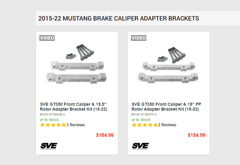

None of them are interchangeable without changing the knuckles, calipers, rotors, pads, etc.
At least for the fronts, a few companies make adapters that bolt onto the GT knuckle and accept Shelby calipers so you don't have to change the whole thing. I don't know of any for the rear, but these make swapping to Shelby calipers super easy.
My google fu is weak. Gotta name?
