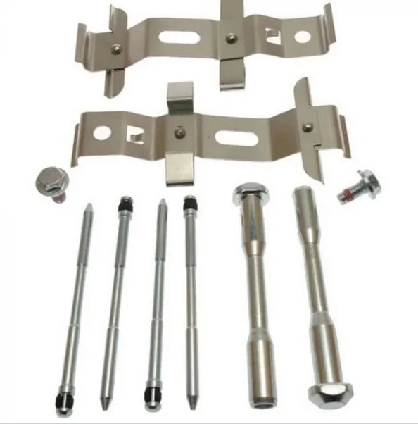

Hey all. Been trying to figure this out and the Ford parts diagrams and descriptions are giving me a headache. Especially since I don't have a PP1 or 2 or Bullitt VIN to use. Thought maybe one or some of you have done this and would know off the top of your head.
I purchased the Brembo 6-pistol calipers that Ford put on the Bullitt S550. They came bare; no pads, no "retainer" hardware, banjo nuts, no nothing except for the center pins; one in each caliper. I also purchased a pair of slotted and drilled 15" rotors and Hawk ceramic pads for the Brembos.
Based on my research I believe I will need a new hardware kit, such as this:
Raybestos Brake Pad Hardware Front Kit Mustang GT/ Bullitt With Brembo Front Disc Brakes 2015-2021 H18225A
Raybestos:
H18225A
hxxps://www.cjponyparts.com/raybestos-brake-pad-hardware-front-kit-mustang-gt-bullitt-with-brembo-front-disc-brakes-2015-2021/p/HW4593/
I should be able to reuse brake hoses and everything else.
Am I mistaken about that and the stock hardware such as the center and locating pins and anti-rattle clips off my base calipers would transfer over?

None of the stock hardware will transfer over from the caliper except the mounting bolts to the spindle.

Well that was easy. Thanks for confirming what I suspected. I think one problem was most people that show you the install, including Ford, work off the kit that has the prebuilt calipers with all that hardware, so they never address it.
Thanks again man.

Thats the exact kit I used when I ordered my Bullitt Brembos from Steeda... Check out Rock Auto. Half the price of CJ's.
https://www.rockauto.com/en/moreinfo.php?pk=9651632&cc=3307633&pt=1736&jsn=1102
