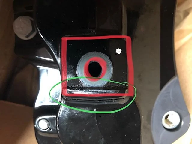

It looks to me as though the not sure what u call it but the square end of that the banjo bolt goes into is too large. It looks to overhang the stopper on the bremos.
The red is the block. The green is showing the lip or stopper.
The metal block over hangers by almost 1/4 “

I believe I know why the brake line wouldn’t fit. I had the caliper upside down ( wrong side).
The banjo bolt hole is off-center it’s closer to the one edge than the other. Hence it was over the block and would fit.
Thanks for everyone’s input to try to solve my problem. Unfortunately there is no fixing stupid.:headbonk:
