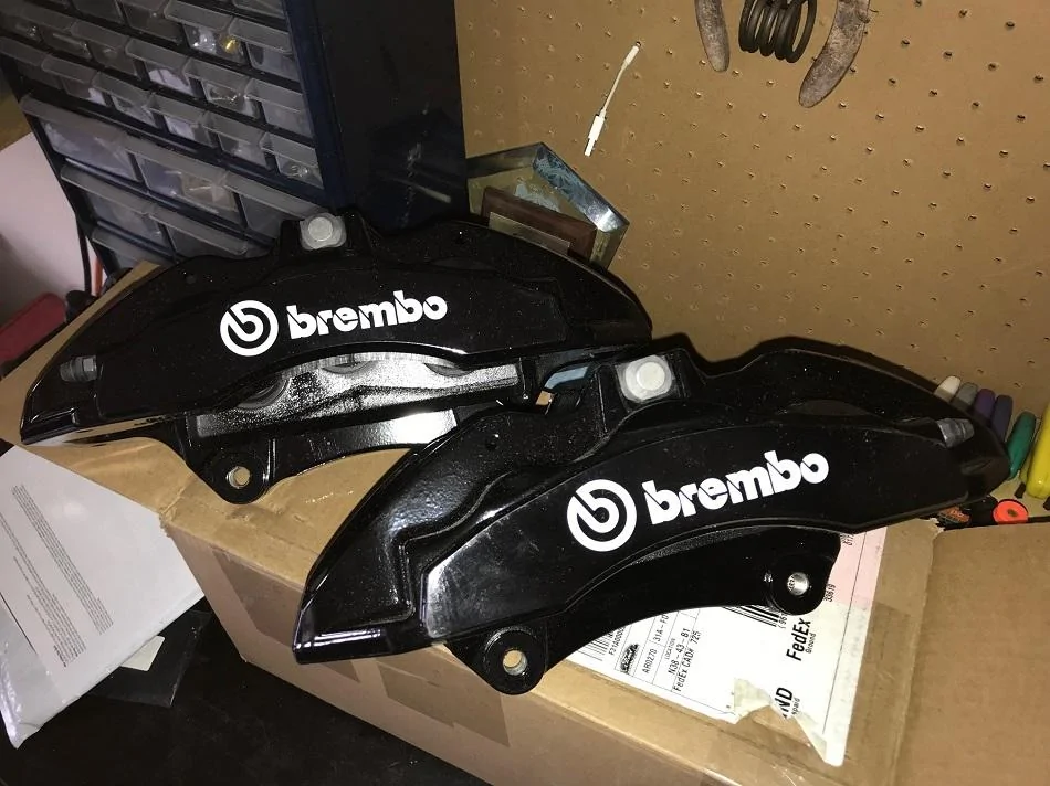

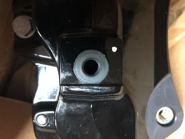

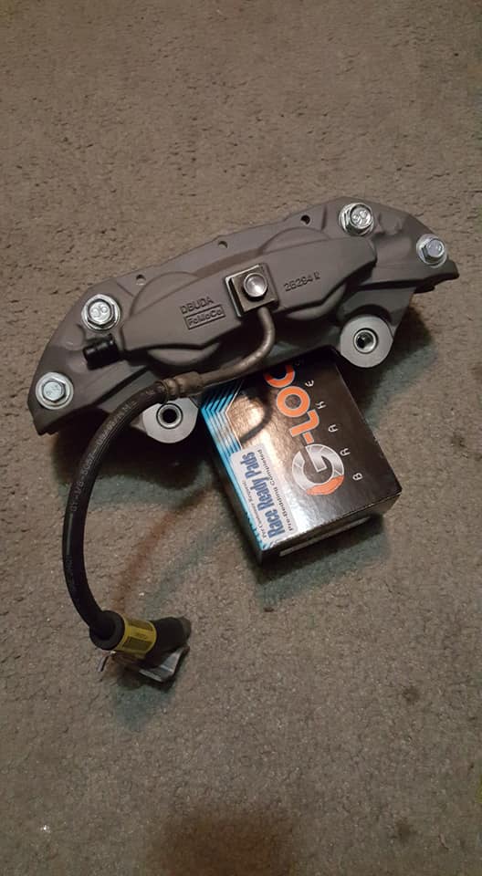

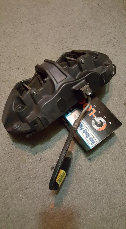

I purchased the 6 piston brembo front caliper the black gloss 50th anniversary model. I thought the original brakes lines would fit from all the research I have done. They don’t. The end of the brake hose that attaches to the caliper is too large to fit
Does anyone know what brake lines will fit the brembos?

That's odd, the kit from Ford Performance says to reuse your stock lines if you have a GT

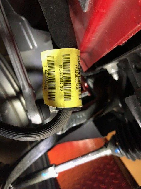

FR33-2B557-GD

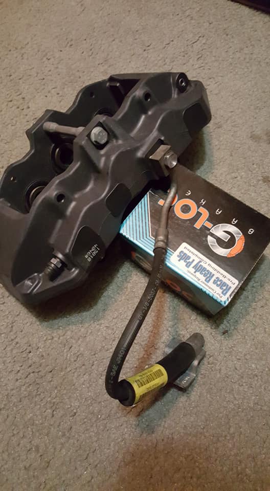

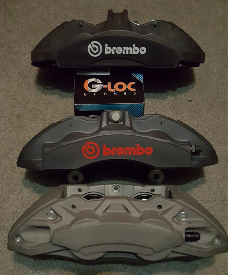

The stock ones. Pictures below Stock GT Caliper, Performance Pack 6 Piston Brembo Caliper, GT350 Caliper all with the same line attached to them. If you have a Mustang with Base Brakes (non PP Eco, V6) possibly they will not fit. These cars would likely have had a sliding caliper. Your Signature says GT so we all assume that's what you are putting them on.

Maybe the 50th anniversary (gloss black with white brembo lettering) is different??

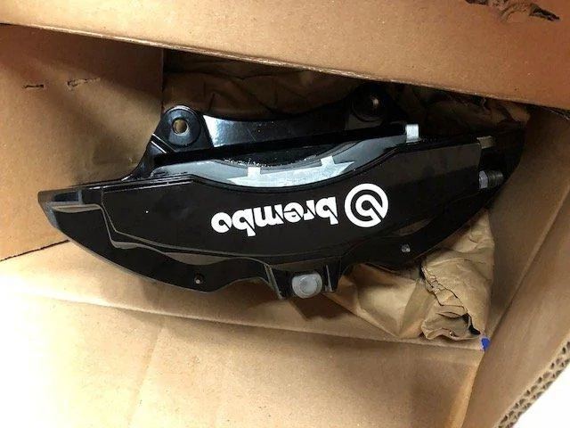

Caliper BRCF-313 FR3Z-2B121-E

On my 18 the gloss black Brembo calipers for the 50th anniversary worked fine with my stock base mode 18 GT. Maybe a difference between the 15 base brakes and the 18.
My now installed calipers pre-install.

I had to put the original ones back on. Was taking it to the track today. What is the part number for your original brake line?

My brake line part. Number
My car is a stock 2015 Mustang premium GT without the performance pack. The car came from the factory with 20” wheels wonder if that is why the brake lines are different?
