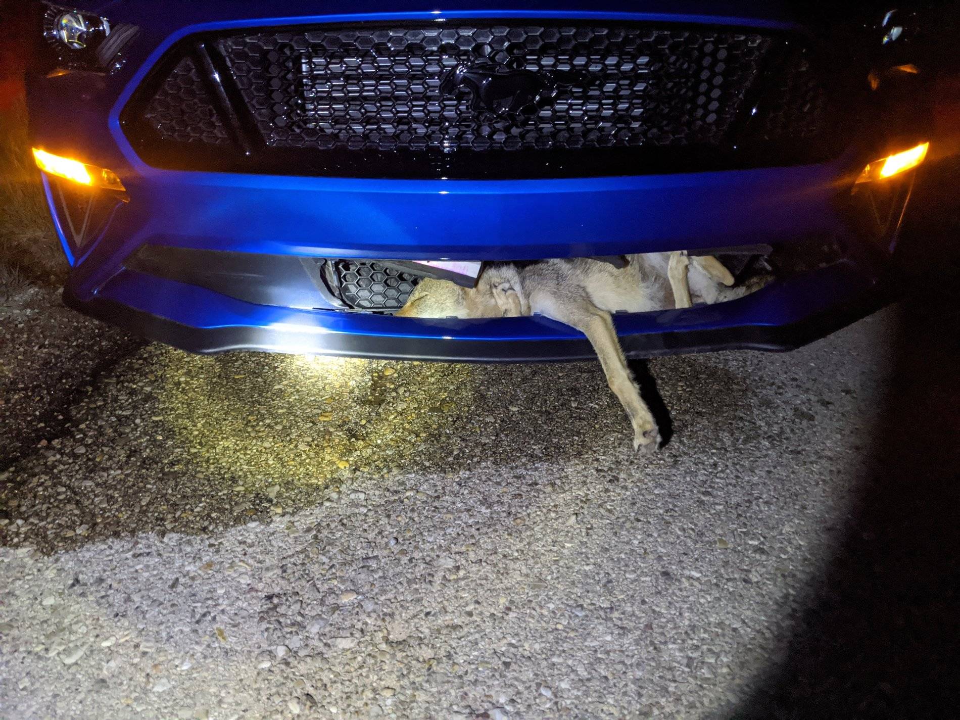

I just tested the brakes a bit on my '20 GT with 2,900 miles on it and they are pretty crunchy when I hit them hard. I haven't driven the car in about 6 weeks because a coyote wiped out the radiator and AC condenser and I just got it back on the road. Coyote went straight through the lower grille so I find it unlikely that the brakes were effected but perhaps? I know I can just take it to the dealership but I'd rather not.

‘Coyote eats Coyote’ - unfortunate, but there’s got to be a meme or signature in there somewhere ...
It was irritating. BTW I have the same issue with my Trek as your Sportage and M3.
