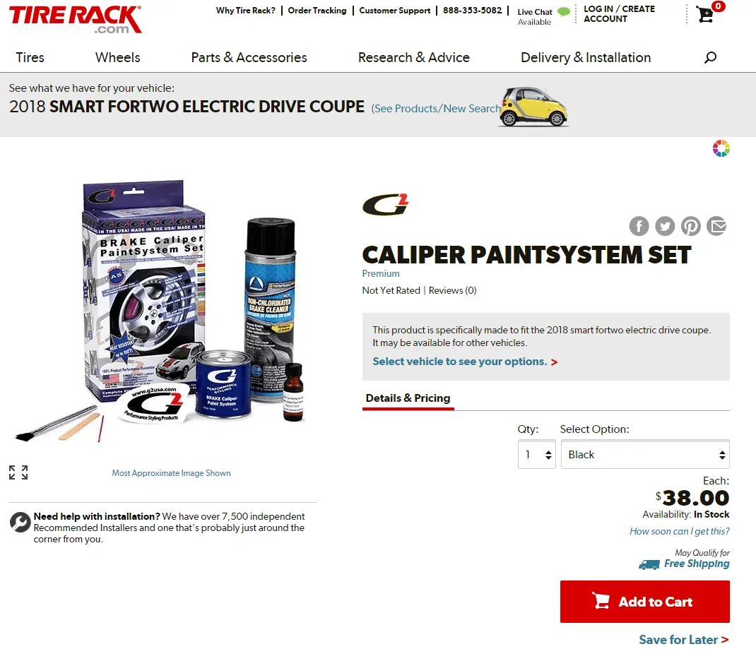

Did this today too. I used a G2 kit. It includes a can of brake cleaner, 2 part paint, POS brush, etc. I'll reserve judgement until it's dry but it looks pretty good to me.

I used G-2 caliper paint on my GT/CS. It looked great and held up great for the 7 years I owned the car. Tried Rustoleum caliper paint on my daily driver and it was not even close to G-2.
Can you give me a link, or more description so I can find that kit? I want a brush-on kit, so I don't spray paint all over.

LOL, I saw that, no idea why it shows a smart car. I thought about changing it, but I would have had to log in and it wasn't worth the effort.
