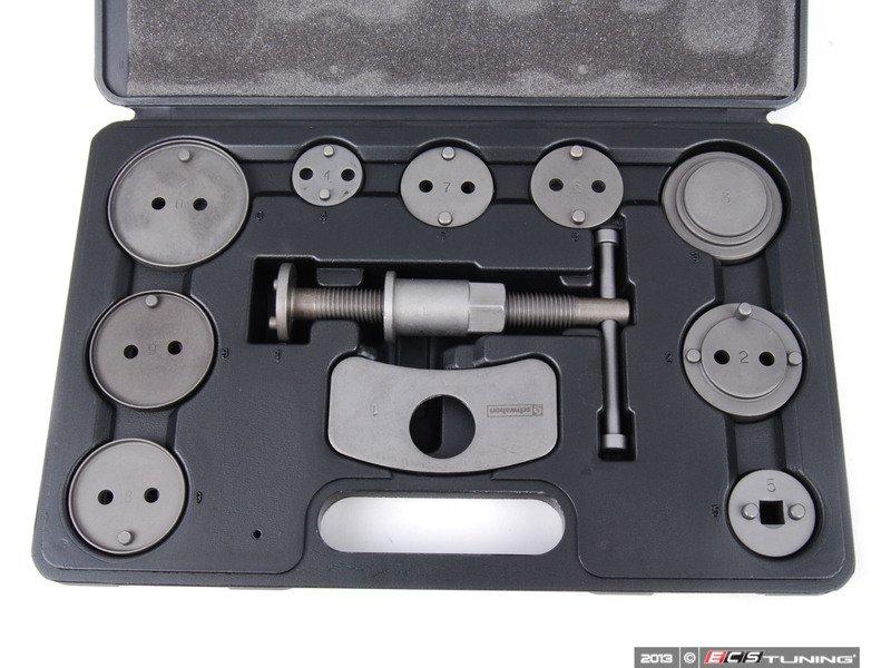

I do believe you need a special tool to screw-in the rear pistons. Can anyone confirm this, maybe tell us what the tool is? Some sort of turny thingy?
Sure - new tools are cool. You can also use a pair of needle nose pliers. I have a pair that was messed up years ago and I ground them down to almost nubs to use for screw in piston calipers. Works for me.

Tool Alert!!!
The fancy kind is called a 'brake piston retracting tool', and they're really nice once you get the hang of how to work them.
My son-in-law used to be in the automotive repair shop business, and when he got out of that to go drive an 18-wheeler one of the tools he brought home was a kit much like the one above.

If you've got the time, go rent the tool pictured above to rotate the rear pistons back from an Autozone or whatever.
If you don't have the time, you can spin the piston pretty easily with a small pair of needle nose pliers. Its not a big deal.
Either way lubricate those rear brake piston dust boots before you rotate them or they may tear.
