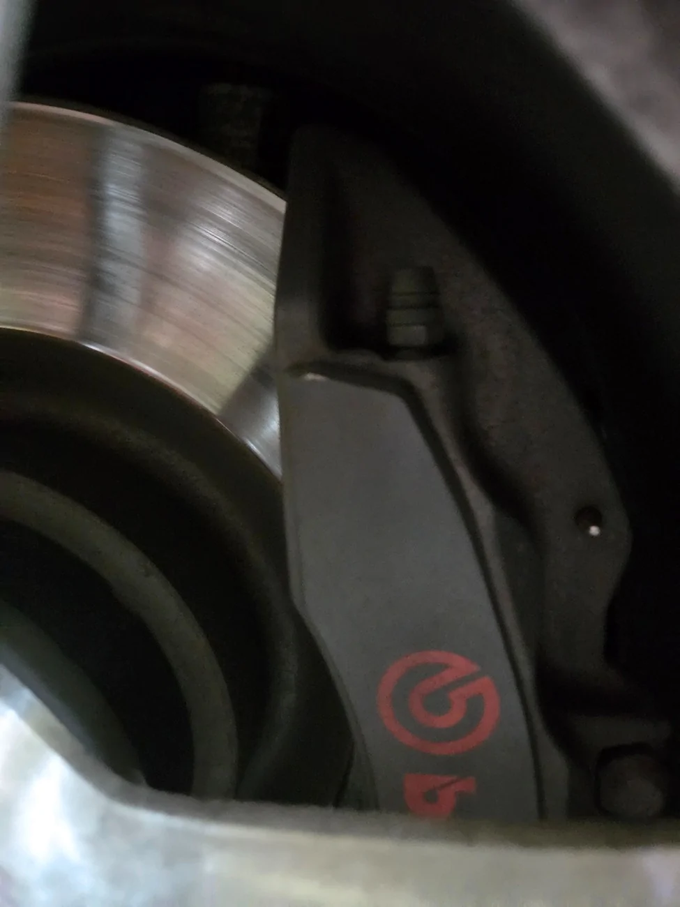

11 years and 22K miles, 10 years with G-LOC R10's. These are the rotors the car was delivered with in 2015. R10's are more rotor friendly than the stock pads IMO.
