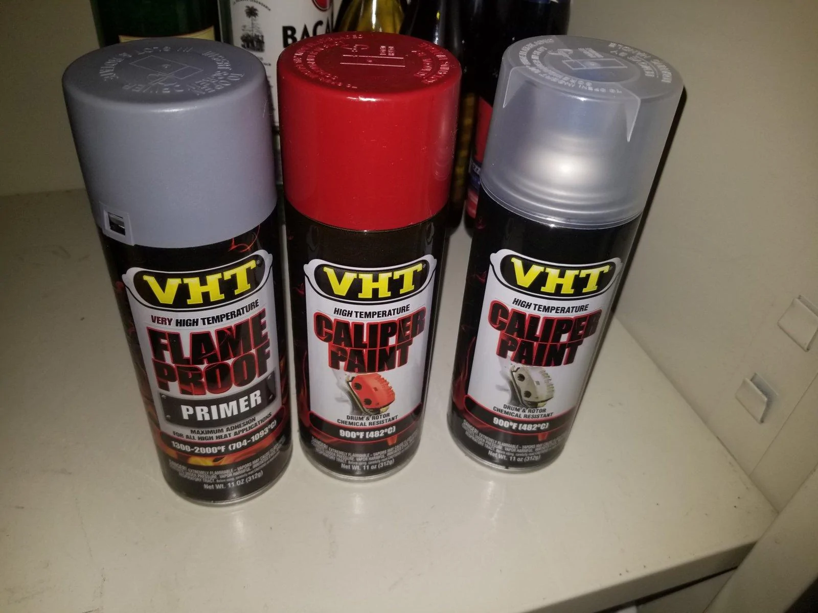

SP-100 – primer
SP-731 – Red Caliper Paint
SP-730 – Clear Coat
Custom decals – eBay - agnes.ns85

I got 2 cans of each primer, paint, and clear coat.
2-3 light coats of primer. Let each coat dry 1-2 hours.
2-3 light coats of paint
1 coat of clear coat and then bake them.

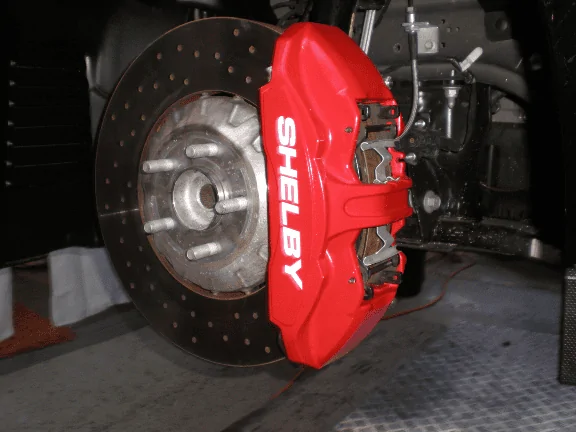

I have 5000 miles on them and 5 track days (I am hard on brakes) and they still look like the day I installed them

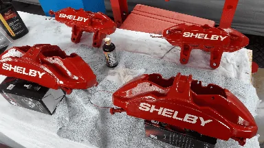

Picture after decals were applied and I was doing the clear coat over everything and then ceramic. I clear coated over the decals multiple times.
With everything put back together again. Also touched up the black on the connecting tube and the rubber insulator on the tube. Gotten a LOT of compliments on these.
