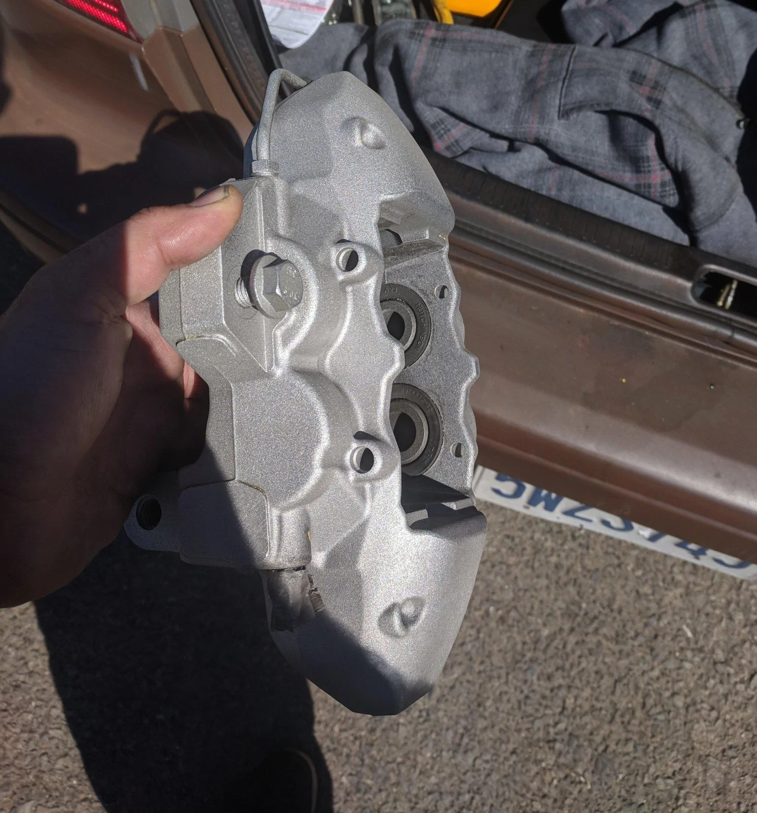

I clear coated (1-2 coats) before I baked. I then applied the decals and clear coated again. Probably did 3-4 light coats mostly concentrating on the front face where the decals are. I didn't want the red to bleed through behind the white decals so I baked before I put on the decals.
On the pistons, I used like 3 layers of simple duct tape. Just clean the area around the pistons and the piston seals real good with brake cleaner and rubbing alcohol. The tape will stick fine. Sand blasting won't effect the rubber seals but will eat into the metal pistons. I pushed the pistons all the way in by hand so that they were plane or below plane of the inner caliper face.
After sand blasting, I used a dremel and ground off a lot of the alu casting seams and went over everything with 120 grit sandpaper.
You can see the duct tape piston covers if you look closely, You will also notice how "most" of the alu seams are gone especially along the front face. Not perfect but much better.
Hope this helps!

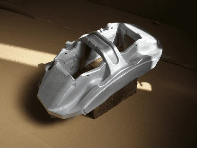

So I went ahead and got mine sand blasted and will start the paint process this weekend.
[/QUOTE]
Noticed that you left the connecting tube on. Looks sand blasted :-) I took mine off and plugged the holes with bolts - same size as the rest. I then, before I put everything back together, touched up the black with simple black enamel paint and a brush. There is also a rubber insulator on the tube. Just cleaned it up, its black too. The black with the red looks nice. Looks good though!
Noticed that you left the connecting tube on. Looks sand blasted :-) I took mine off and plugged the holes with bolts - same size as the rest. I then, before I put everything back together, touched up the black with simple black enamel paint and a brush. There is also a rubber insulator on the tube. Just cleaned it up, its black too. The black with the red looks nice. Looks good though![/QUOTE]
I did take off the tube on one caliper but I couldn't find the right thread size. I looked everywhere local and no one had it.

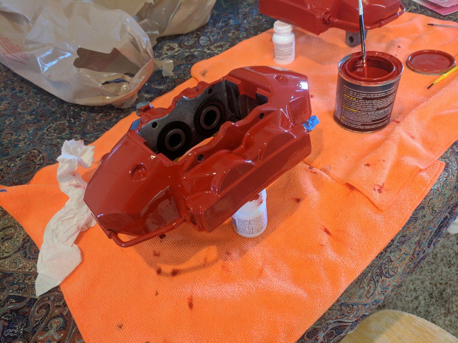

17 GT350
Changed my mind on the color and used por 15. This paint is incredibly strong and easy to lay. Paint will level flat and smooth after applied. Much much better than g2 paint and it was only $15. I still have more than half of can left. I also used por 15 metal prep before applying the paint.
