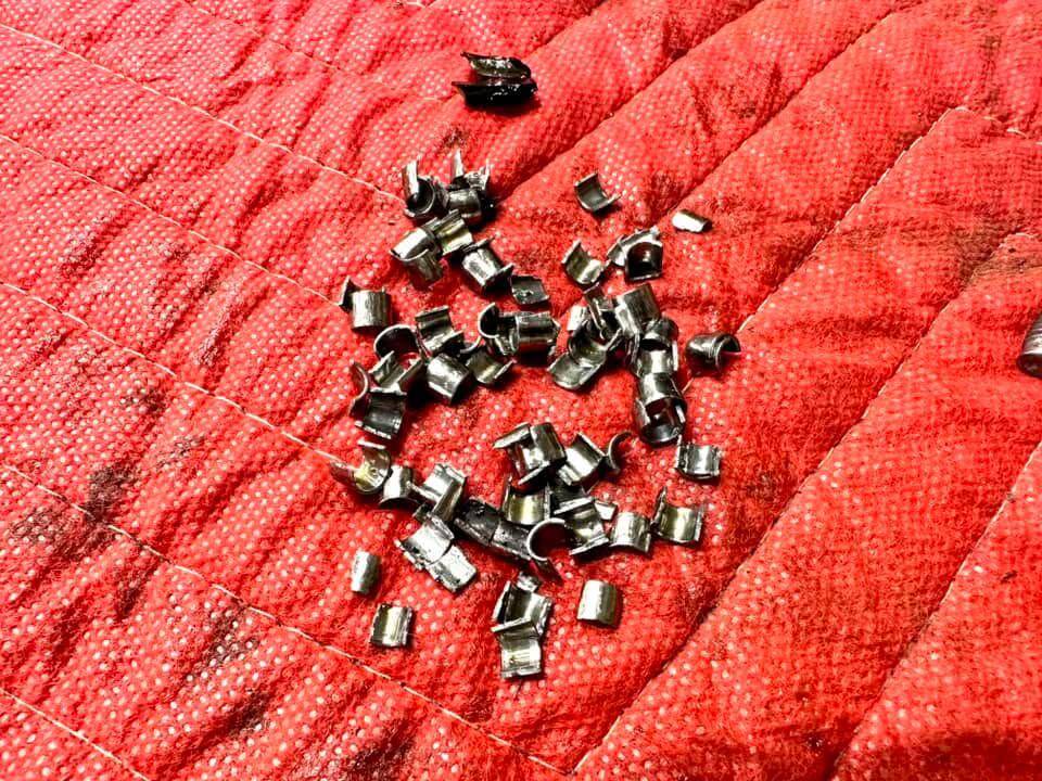

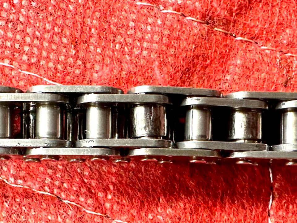

I’m not saying anything is wrong, just that it appears that the primary chain system has cogs (teeth in the chains and phaser gears that mesh with each other, whereas the secondary chain has rollers (like a bicycle or motorcycle or chain) interlock with the gears.
I haven’t had mine apart yet, but will in the near future. IMO, a cogged chain would seem to be stronger in design, hence why some people are addressing/upgrading secondary chains which are said to be the weak link.
See pics here of a guy that had a secondary chain come apart on him. The rollers simply cracked and split in half, thus creating the pile of pieces in the top pic. He pulled his covers to troubleshoot a noice and found this.

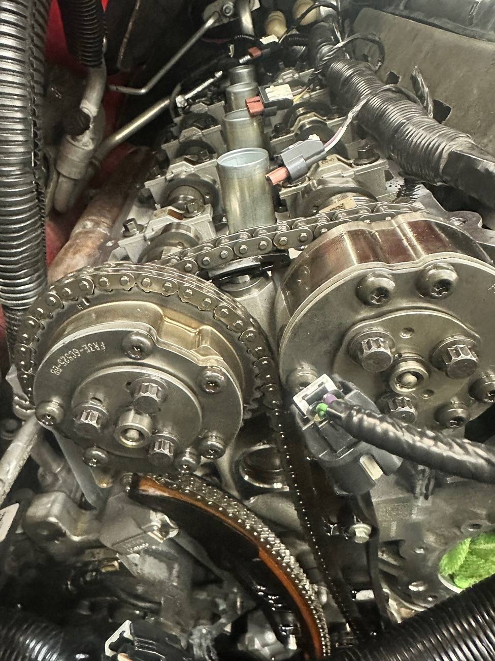

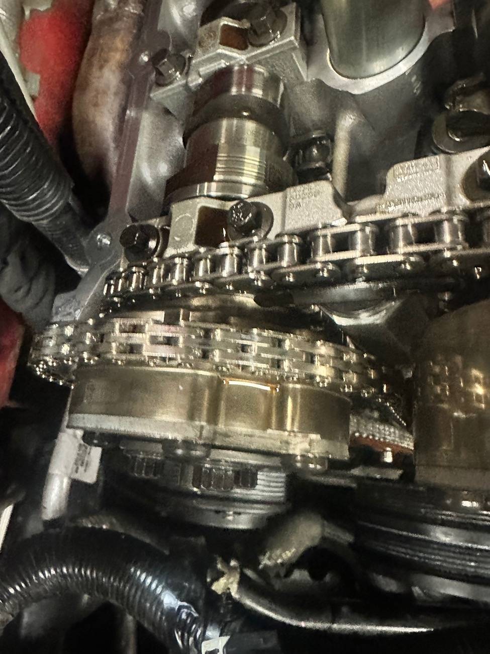

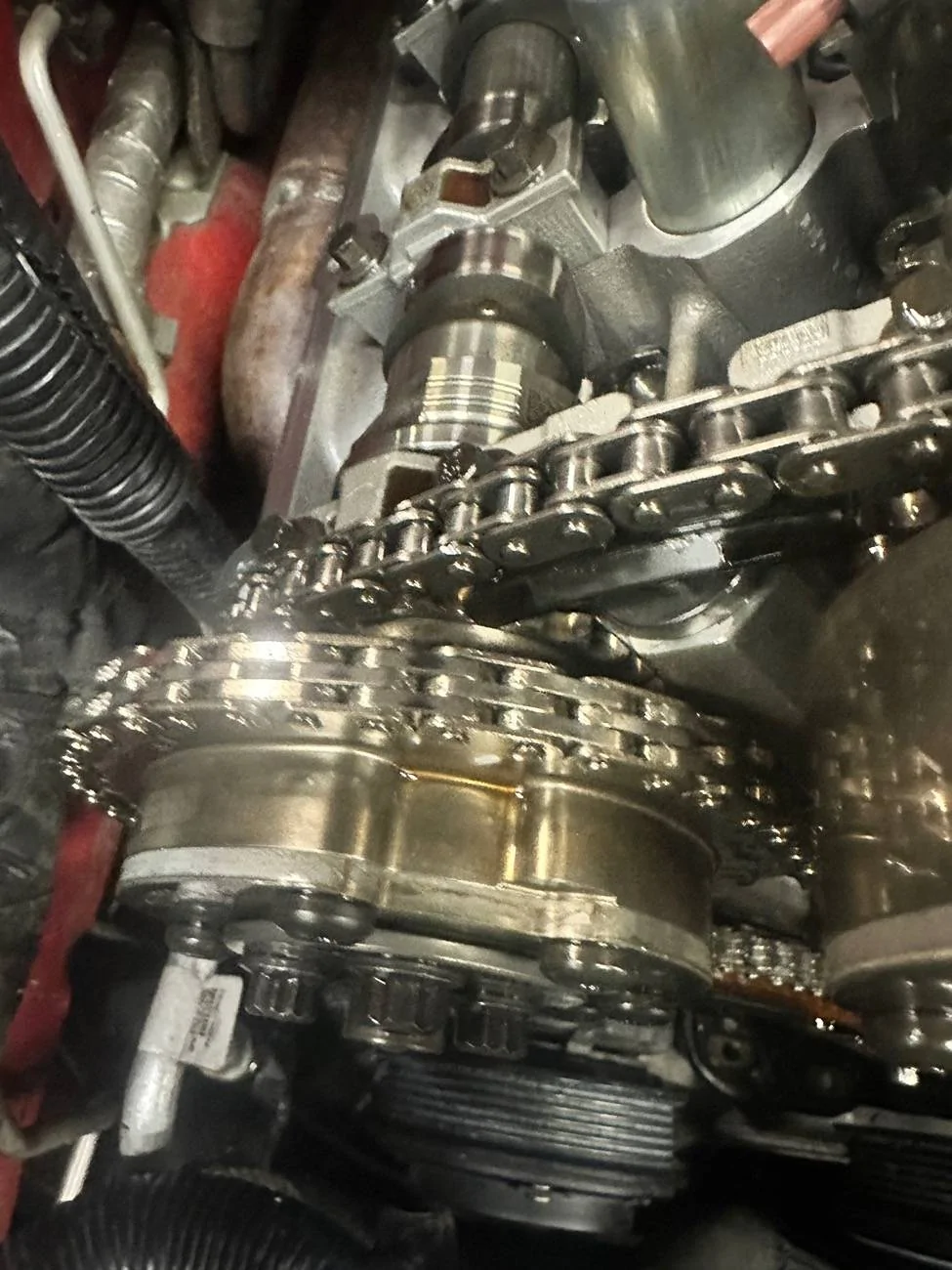

I can look at the rollers I just don’t know what it looks like I’ll post a pic circle where to look

I marked your picture with green lines on some of the rollers. You woukd want to rotate the chain and look for cracks or missing pieces from the individual rollers.
I would think that missing or broken rollers would create both noise and extra slack in the chains. Not sure whether this could somehow transfer to or cause problems in other areas of the timing system, but the photos that I uncovered were enough to help me make up my mind that I will be upgrading my secondary chains to an HD design.
Awesome I’ll definitely take a look at them
