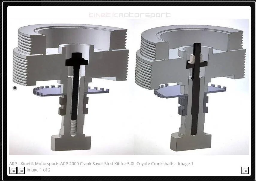

How good are the threads in these cranks I don’t want to strip it out do I go until the bolt stops turning?

The OEM bolt is not long enough to be used to pull on the balancer, and does not bottom out in the snout of the crank.

Is the arp stud long enough?
You really should start the balancer with a balancer intaller tool (i thought you had said that was how you WERE getting it started) THEN pull it home with the ARP bolt, looking behind the balancer at the backside of the hub, this way when there is no more “shiny” part of the hub showing through the front cove seal, you should be there or close. Then torque down your bolt of choice.
Is it the same length as the OEM bolt?

Yes some Length as oem but does have a fewer amount of threads
