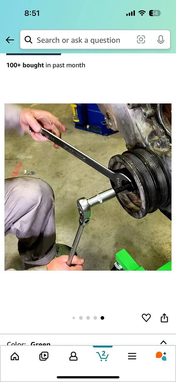

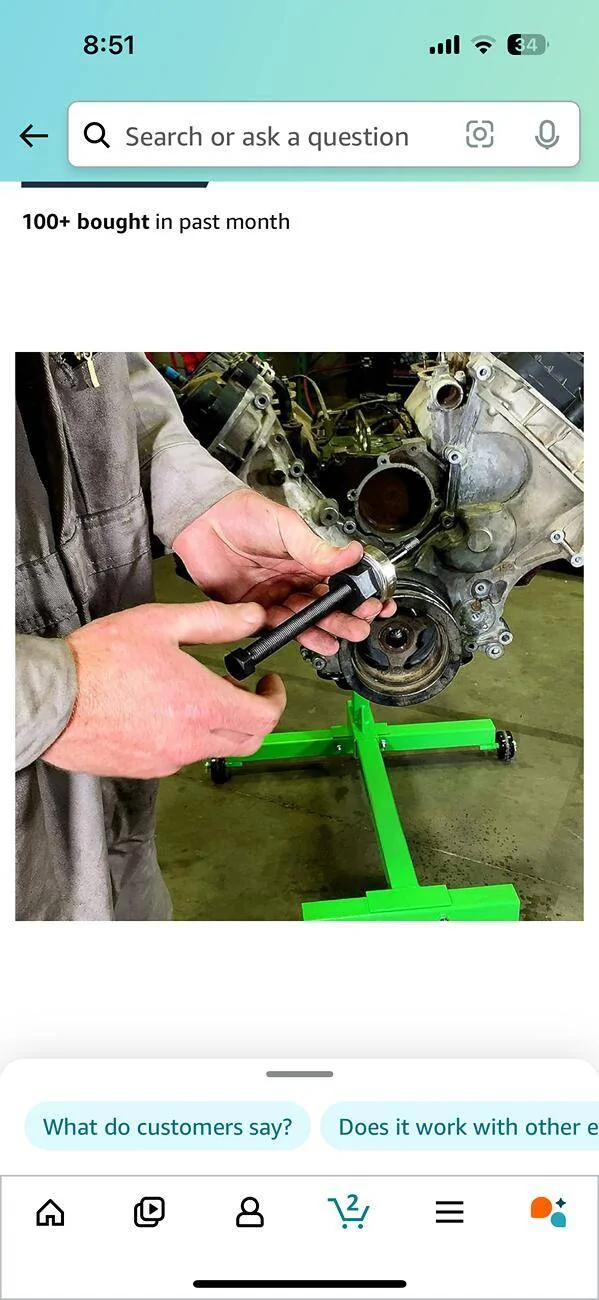

No I originally had a new bolt as I’m torquing it down the the ftib starts to decrease so I stop bc I don’t want to strip the crank unless that’s normal? And I use an installer tool…does the bolt stop turning when the balancer bottoms out? Should I use an impact

Again. What tool are you using To do up the bolt ??? post a picture.
This is the type of job that need an accurate tool.

I use that tool and go until it doesn’t budge anymore so I just assumed it’s on all the way…like I said I’m just worried I’m going to strip the crank shaft

That tool is only to help put the pulley On.
what torque wrench are you using to get the correct value ?
