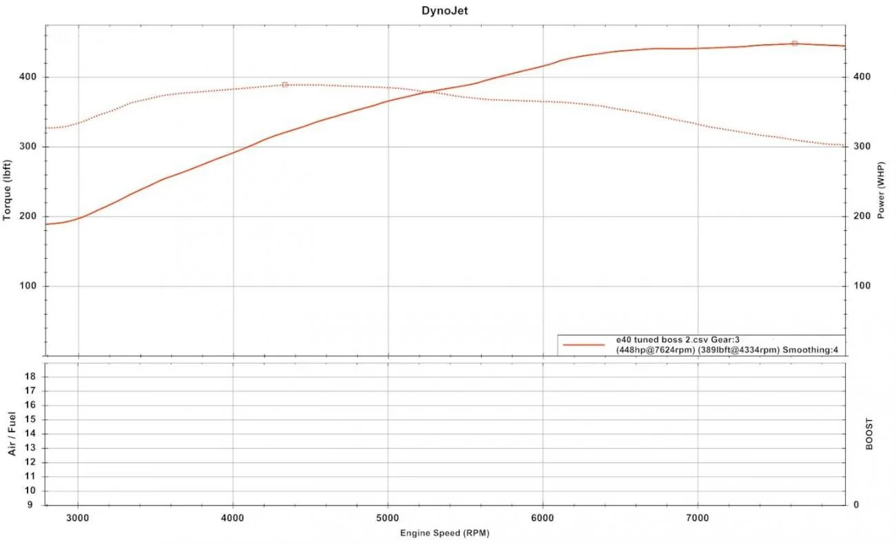

This doesn't count for a whole lot since the ethanol blend I'm running is not enough for the timing targeted so the car was pulling timing 5750 and up so power is down a little. The weather was cool this morning. The numbers aren't important but the power and torque curve reveals how the boss with tuned VCT performs.

Nice power up top, very flat. Looks like you need to shift above 8k
I don't feel comfortable doing that. I shift at around 7900 and that's plenty. Car pulls great. The new VCT has really improved the power output. Unfortuntely it has pushed my injectors to the limit.
In cooler weather this morning I hit 52.11 MAF lb/min. Highest numbers to date. However, the extra and cooler air gave the engine what it really liked but the fuel system could not keep up. With the amount of timing I am running, E40 is not enough ethanol to match with the timing so the car was not advancing nearly as much as it should. Since the injectors are maxed, E40 is all I can run so now I am power limited. Next stop is 47ln injectors, then I will push it to the limit.

I'll be loading up my 7900rpm lund tune today after they fixed the limiter. Can't wait to see what it does. You need some 47's kris!
