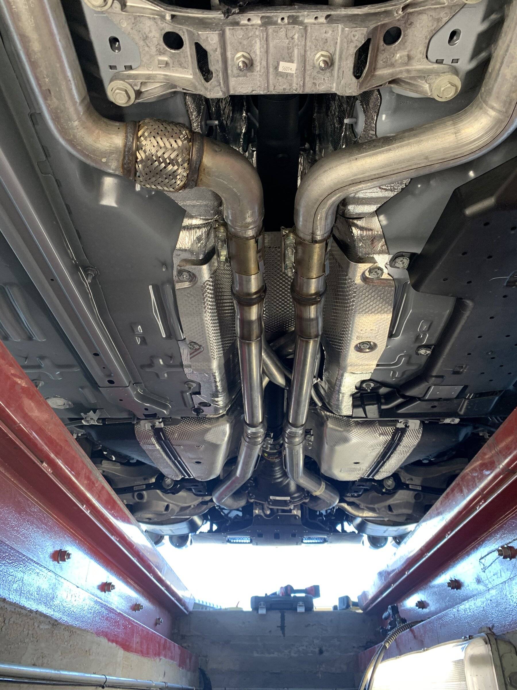

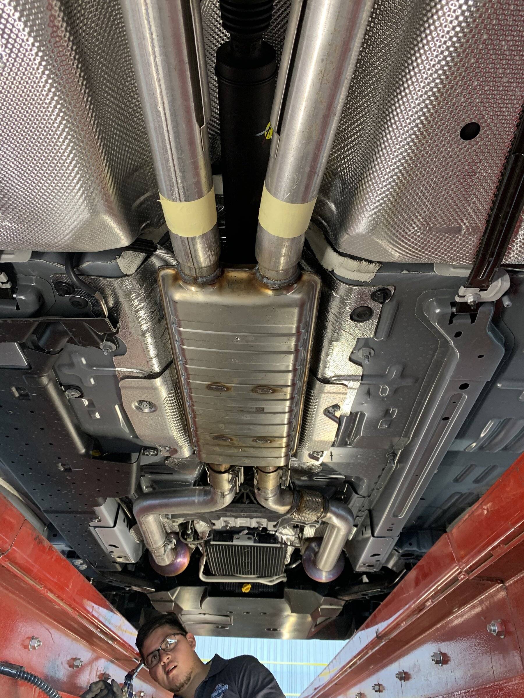

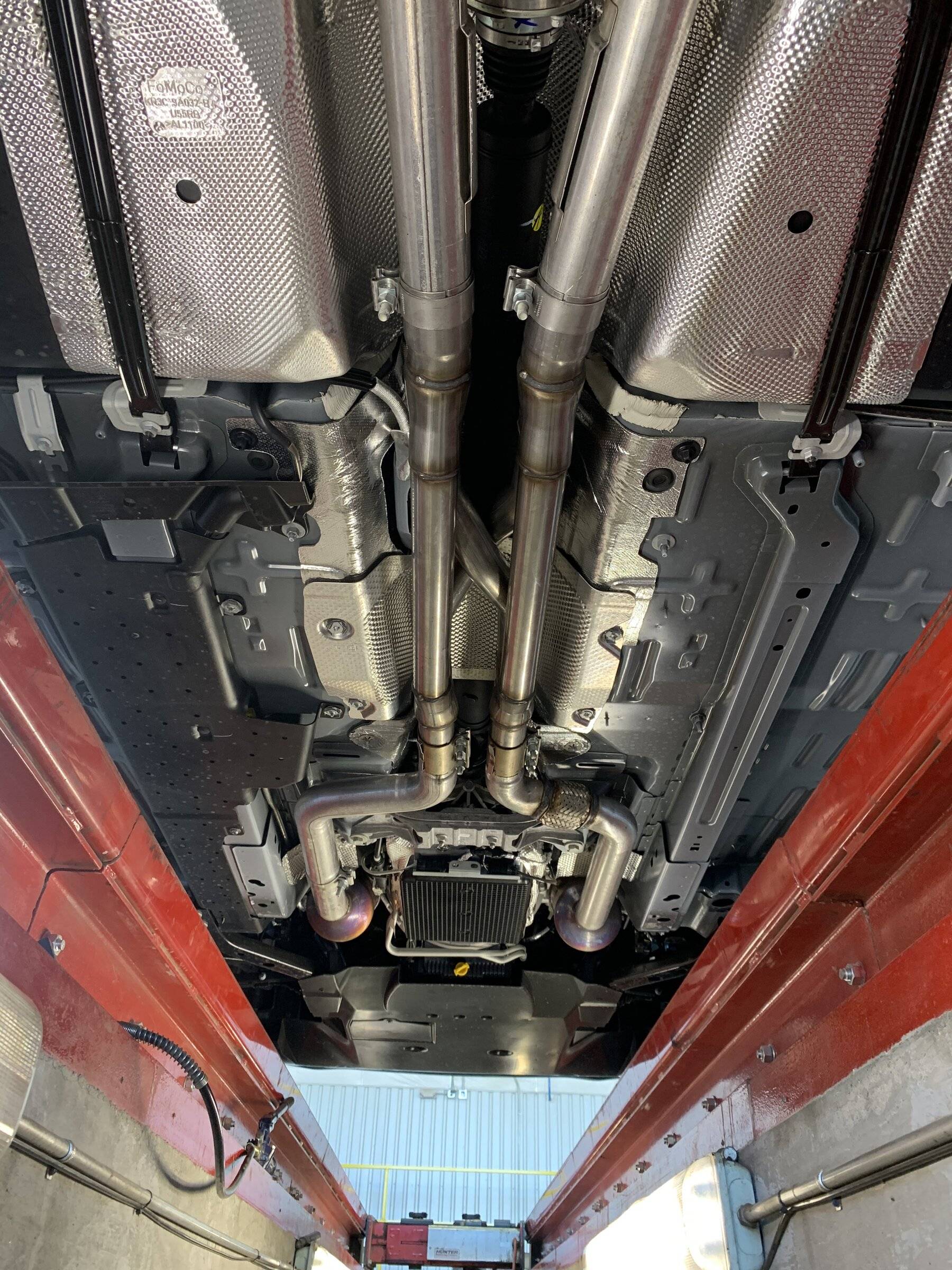

Installed the Borla SwitchFire. Great sound!!! Got it on black Friday deal for $445. Install was easy about 30 mins start to finish. Also had another set of hands to help, thanks Gio!
Tools:
Sawzall w/ 6” blade
Battery 3/8” impact
6” extension
15mm 13mm deep sockets
Tape measure
Sharpie
masking tape (to make sure I kept the cuts straight)
I did not remove the whole cat back rather made my cuts, removed resonator, loosened exhaust hangers for the mufflers and mated the pipes. With the active exhaust it’s great sounds good in all modes and still able to use stealth mode! No drone at all.
